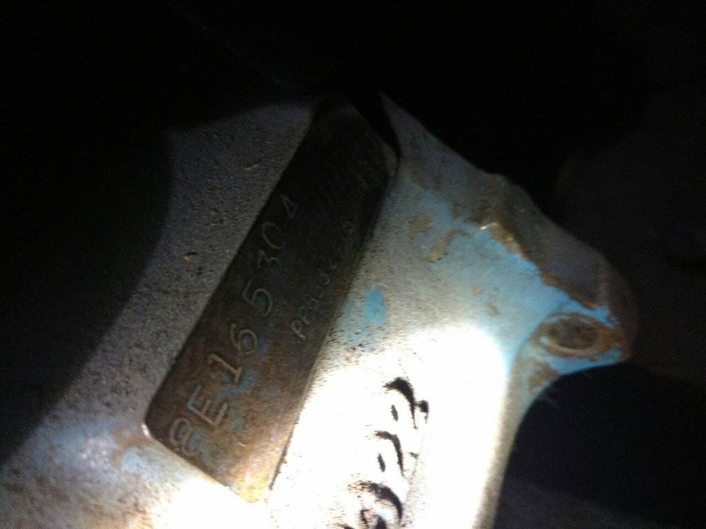

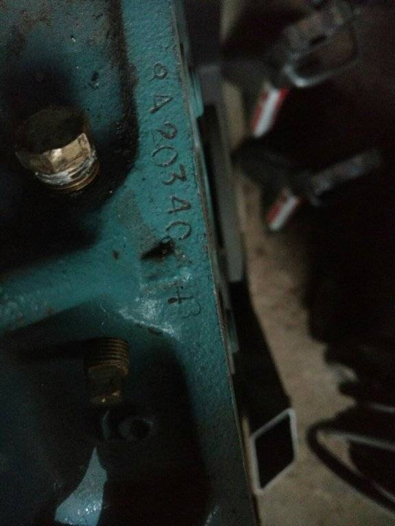

That's not entirely true. They started stamping the vin on the blocks and transmissions in '68. On the blocks it was stamped at the rear of the block next to the oil pressure switch and on automatics the stamp was adjacent to the one on the engine. The 4 speeds were stamped with the vin at the same location as in '69 and on. Both the engine and trans from my Coronet R/T are stamped and so are the engine and trans that are going in my RR, they match each other but not my car...
View attachment 120034 View attachment 120035
I'm trying to remember, this may have been one of the January One things. I know the bodies didn't get it till 69, maybe I'm just getting it all mixed up.

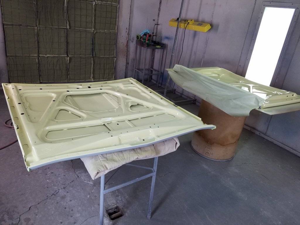

Making more progress. Painted the doors inside and out and shot underneath the hood and trunk. Should have everything painted by end of next week.
