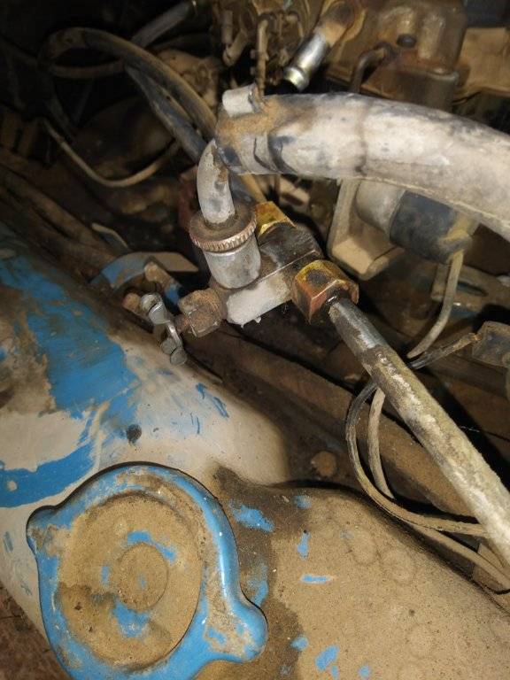

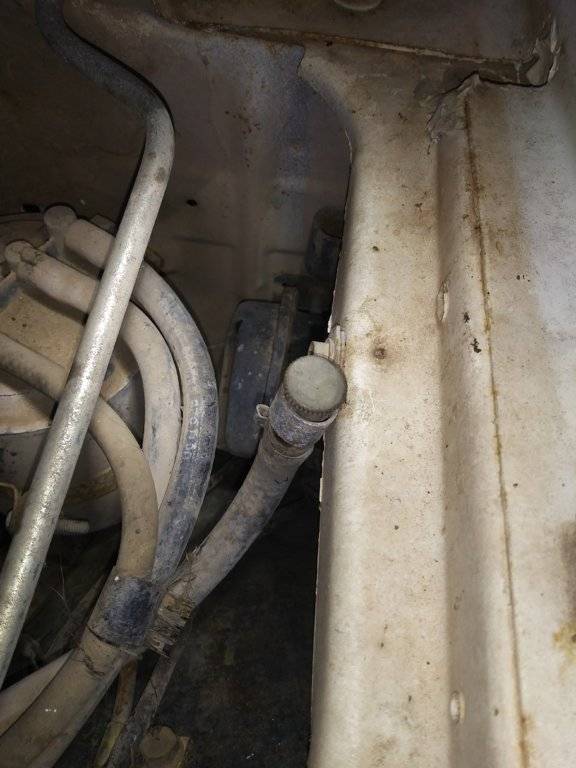

Original paint shined up pretty good. 77,812 Original miles. Is this what would be considered a "survivor"? Also on the fuel line there is a valve and hose going to the passenger inner fender. Is this to provide fuel to stranded motorists?
No, that looks like the hose for CA emissions that went back to the tank to pull fuel vapor into the PCV system. Look on the passenger side valve cover canister for a blocked port. Police cruisers that had the stranded motorist setup have a hose reel (4 leg) mounted usually to the top of the core support. If you follow the hose back, there will be a "T" fitting on the output side of the fuel pump if it is a stranded motorist setup.
Dave
Dave
No blocked ports anywhere. I thought the same thing...
Can't tell, that looks like the hose for CA emissions that went back to the tank to pull fuel vapor into the PCV system. Look on the passenger side valve cover canister for a blocked port. Police cruisers that had the stranded motorist setup have a hose reel (4 leg) mounted usually to the top of the core support. If you follow the hose back, there will be a "T" fitting on the output side of the fuel pump if it is a stranded motorist setup. The pics are inconclusive, but the "T" fitting with the valve suggests that might be the case. If you need the hose reel set up, I think I still have one of the 4 Leg appliances for the hose.
Dave
