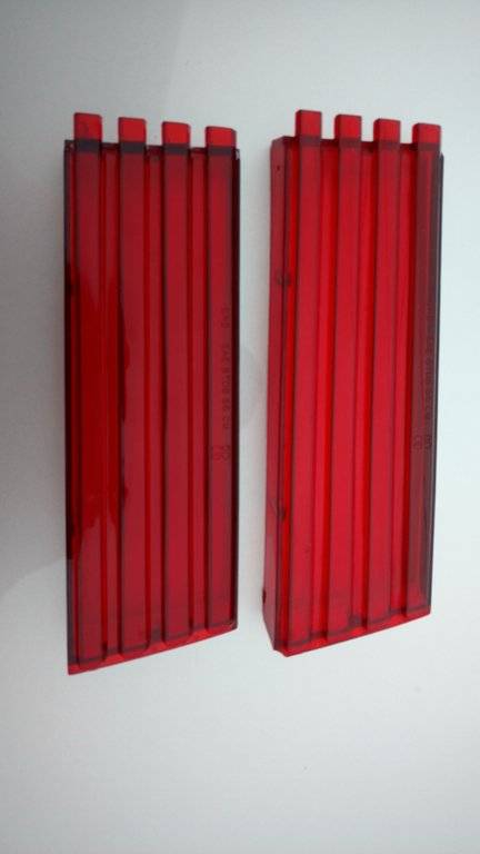

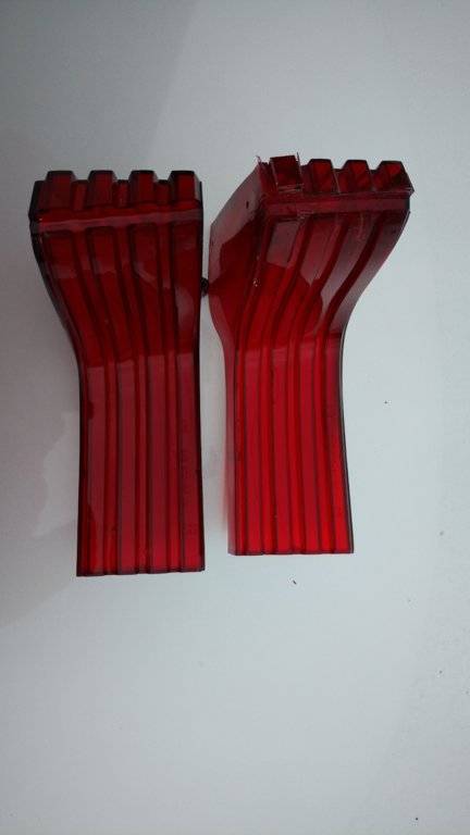

I will give a little bit more detail this evening. I have been working on the deburring of the edge of the lens. This area is not visible when installed, just me being anal.
I am very satisfied with 4 sand papers to a 1500 wet dry paper, and then 3 different buffing pads using 3 different buffing compounds.

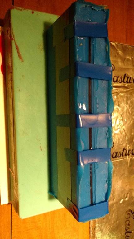

I also wasn't satisfied with the very first mold I made for the clear lens. It was completely functional and the vent holes I incorporated into the mold were hidden when installed, but I knew I could make a better mold, so I did.
The mold pictured was my first pour. I used a stiffer mold but it still pushed out, so I used the electrical tape it worked, but the second pour I used a wood box to keep everything where is should be.

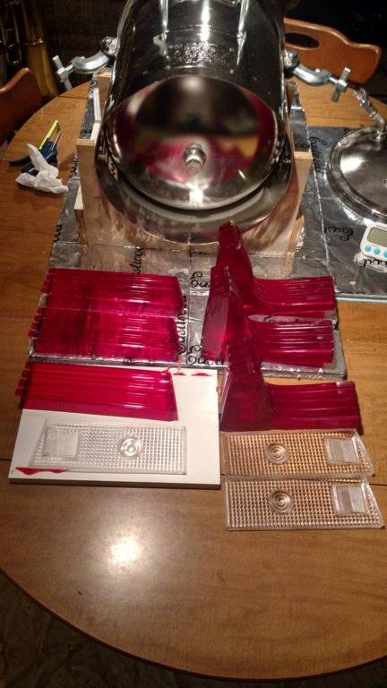

Almost ready to put them up for sale. I have 3 sets finished, the factory lens bottoms are painted black and that is the last thing to test. I have primer and top coat designed for plastic, and recommended by the manufacturer of the product.
I received more information on the color retention on the dyes I have used. I talked to the owner of the product I am using. He also is a distributor of the UV urethane I am using too. He has had a display in his window for over 20 years with the same color dye and urethane, I am using, and he said it still looks good.

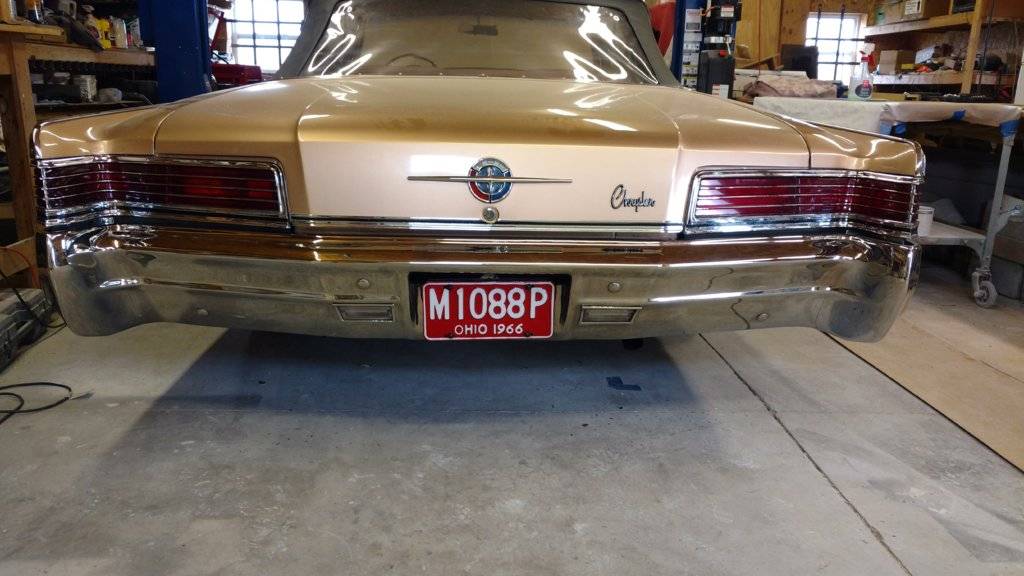

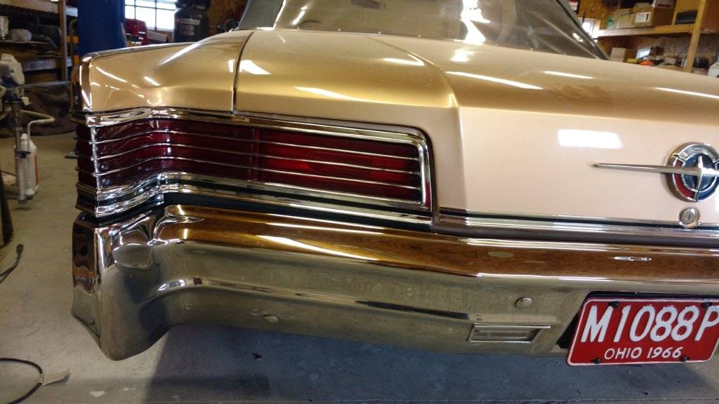

New lens installed on Goldie. The fit was perfect, the old lenses had only faded slightly, so on the car no preceived difference in color. I took side by side off the car for comparison.

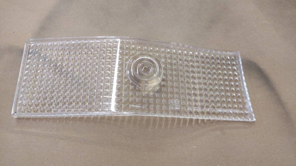

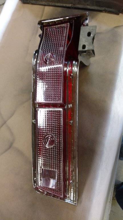

I have one set available minus the clear reflector behind the wrap around lens. I messed up there. When I received the NOS lens the flat lens had one but the other didn't. I forgot there was one behind it too, so I need to make a mold for that lens.
Unless you have a car that the lenses have been removed, mine still look brand new. You can see the lens I'm taking above installed. Here it is loose.
There is something about just finally getting one installed. I have put it off because you need to drop the bumper to remove the assembly. That was a lot easier than I remember. I just loosened the right side , so I did not have to remove the whole bumper.
I decided my NOS will remain as such, and installed my own. It does make me feel proud, I won't lie.
I finally got both assemblies installed correctly the right screws to seal everything tight and added pop rivets to the grids. I tried JB weld 5 years ago and it never held. Now they never looked better.
