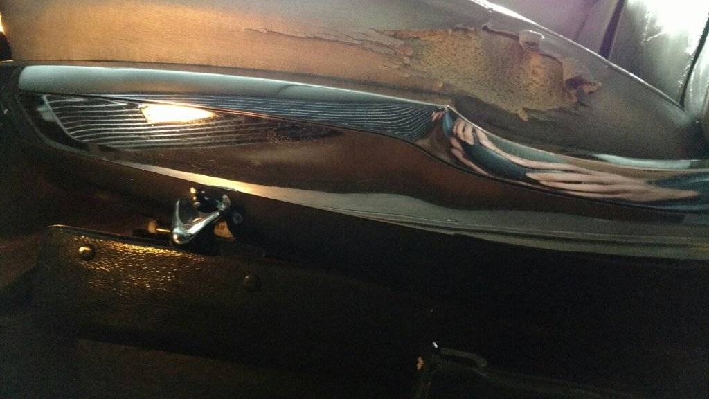

I really appreciated seeing the construction of the mold. I may need to make my own seat side trim for the driver's bucket seat on my 68 Imperial since I can't find one.

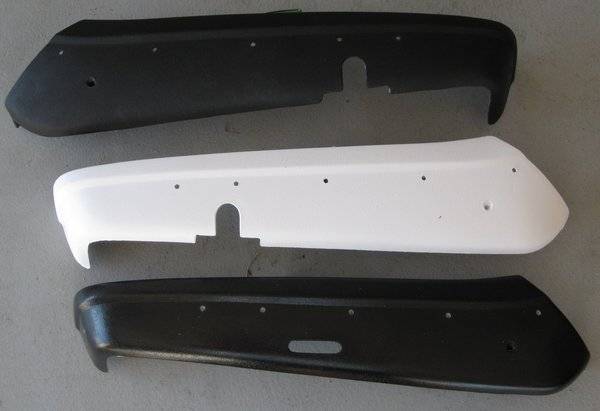

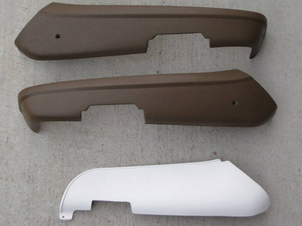

Aren't those repoped in fiberglass for C bodies? I wonder if the Imperial version is the same thing wrapped in vinyl?

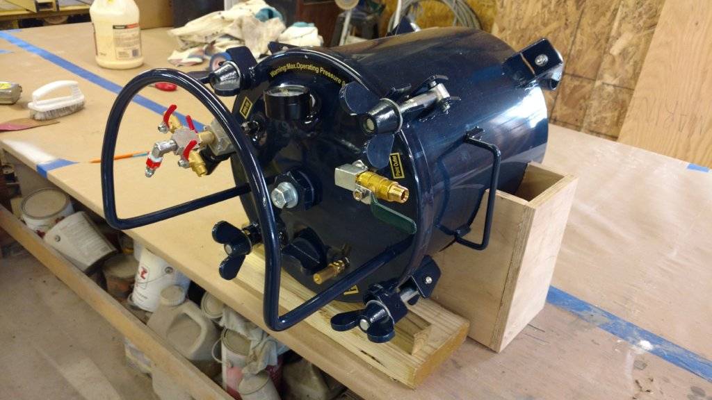

Update. I was going to set up a pressure pot. They are quite expensive but found one on amazon that had good and bad reviews. I got a bad one, I need 60 PSI, at 50 air started rushing out around the welded protective rods, mounted on the lid. This one is going back and I will not buy another. This was of course after I made a nice mount to rest it on it's side. Oh well.
With more research I have been told a vacuum pot is what I really want. I can make one of those for about half of the pressure pot. The place where I bought the molding supplies do not use a pressure pot, but do use a vacuum pot. Back to square one, but I have all the rest of the supplies to make my first mold.

Not the same and ‘67 is different than ‘68 so probably a 1 year only part.
The white one in the pic looks similar to the pic Detmatt posted...I really don't know. I'll need to pick up the phone, but thanks!
That’s out of the ‘68 Parts book.

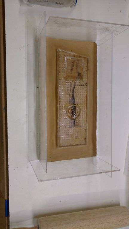

I also started the first phase of the lens mold. I set the lens in clay and it is essentially ready for the mold to be poured. I need to find out if I have enough product to do the mold. This is a pretty large mold and was intially going to do a smaller lens first.

I case anyone else is thinking of doing this themselves, do not buy this pressure pot. I am getting a full refund from Amazon, however I question this distributor. The safety bar is welded in place and at 50 psi the air excapes around the weld and conveniently the safety valve releases at the same time. This is a 90 psi pot and the same one Smooth-On video uses.
I screem conspiracy, the more I think about it. This pot would work fine for paint, I would use about 20 psi. I think this outfit bought these failed pot replacing safety valves corresponding with the psi the pot is failing at. Every pressure pot I have used the safety valve kicks in at the max psi
