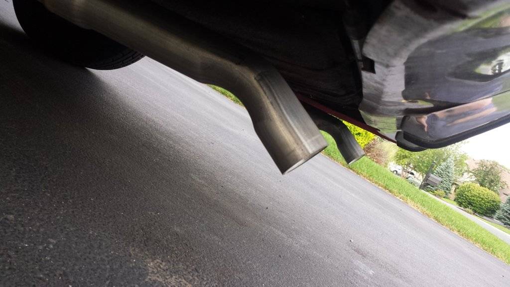

My new 1972 Imperial purchase delivered today.
I am beginning to like this car now that it has white walls and correct exhaust pipe ends coming (just a little way to go yet to align with MarPar!) You are shaping up just fine!! :thumbsup:

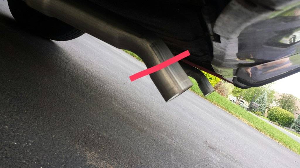

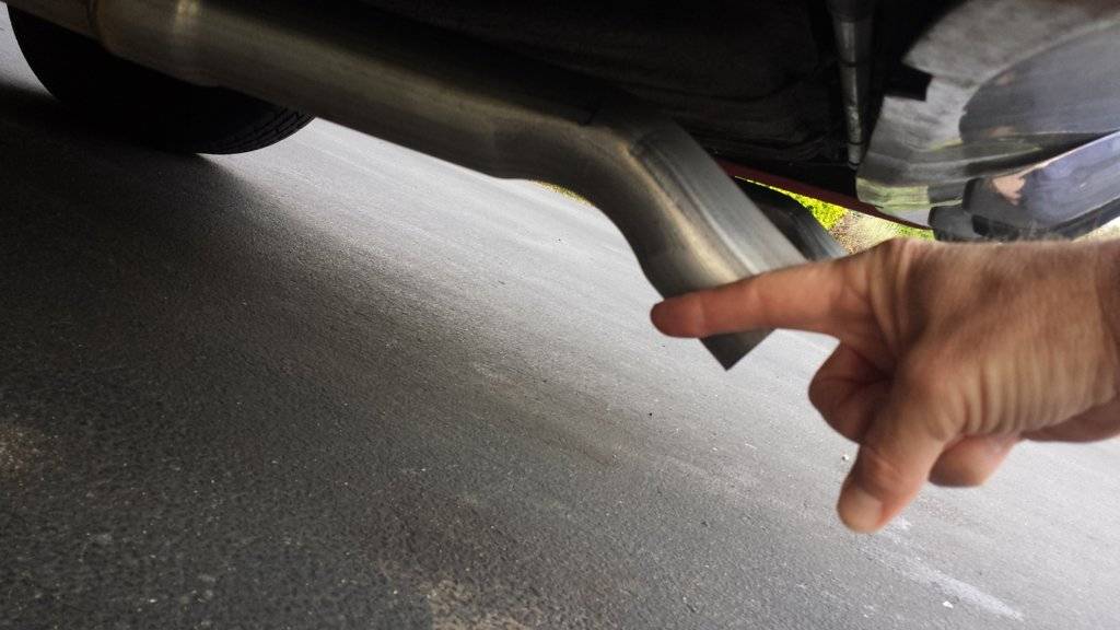

I'm no rocket scientist but, probably cut heresy....
That would be an improvement but you’re on the right track!

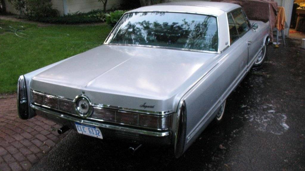

MarPar was pretty much right on. I still have an NOS chrysler resonator for those cars, and it is shaped just like MarPar's photo on the exhaust outlet.

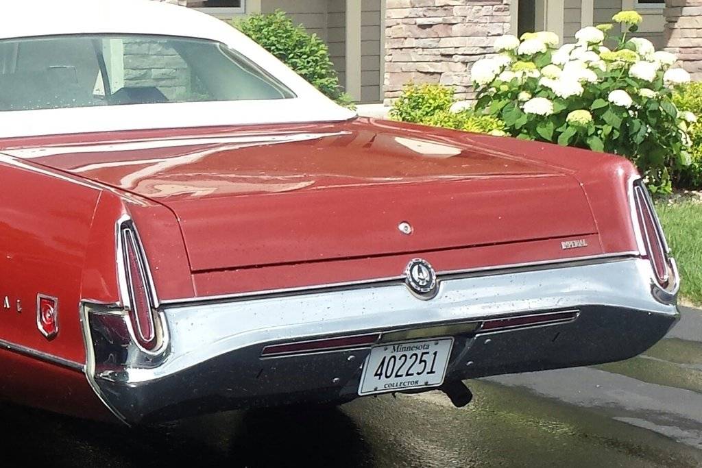

So do any of the Imperial brochures have any beauty shots that show the exhaust? That would probably be the correct angle if it can be deciphered.
Who’s to argue with the correctness of that?
I decided to google the brochure. Probably not a good source. Either your exhaust is still sticking out too far, or they did not put exhaust on the photo cars, or is a good example of early photo shop.
I started out with straight pipes and chrome tips and
Quickly got rid of the tips but embraced the straight pipes.:thumbsup:
Just go to the depot and get yourself an angel grinder and a couple of cut-off discs.
And of course some safety goggles from work.
^^^^^Yes^^^^
And be careful with the angel grinder Doc. I know you rely on your hands and eyes to make a living and buy more Imperials. This will be a plunge cut so to turn the tool on before you make contact, both hands firmly grasping the grinder and slowly work your way around the pipes. Remember the gas tank is back there. Once the disc has made it through the wall of the pipe be careful to keep the disc steady and straight or it’ll want to grab and jump out of your hands.

Gotta side with Matt on this one. Angle grinders are jumpy and more dangerous while lying on your back in tight spaces... makes it extra hard to brace the machine properly. Watch yo butt.
If it were me, I'd just whip out a sharpie then take her back to the shop.
