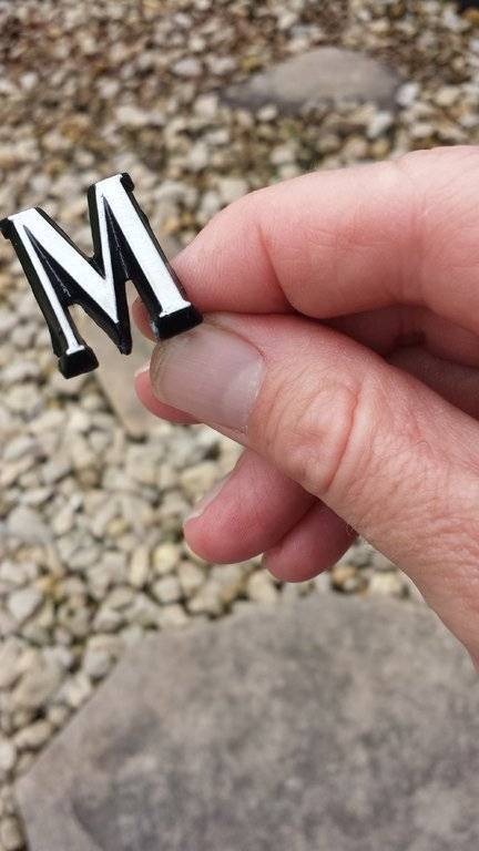

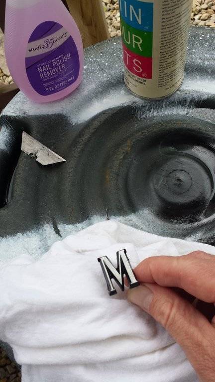

First set of Imperial lettering came in mail...little flashing around edges. Tried the black paint/acetone method just to see effect...probably should grind off flashing first.View attachment 138123 View attachment 138124
Well...15 more letters to get it right.looks good! ya, you probably should have sanded the flashing off first. lol

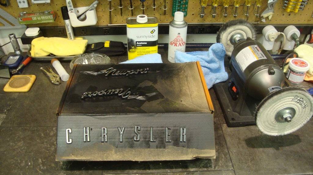

A handy trick!indeed it was sir.
