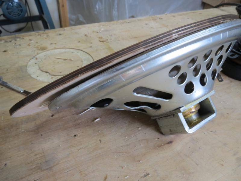

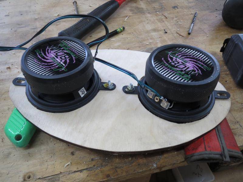

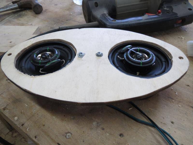

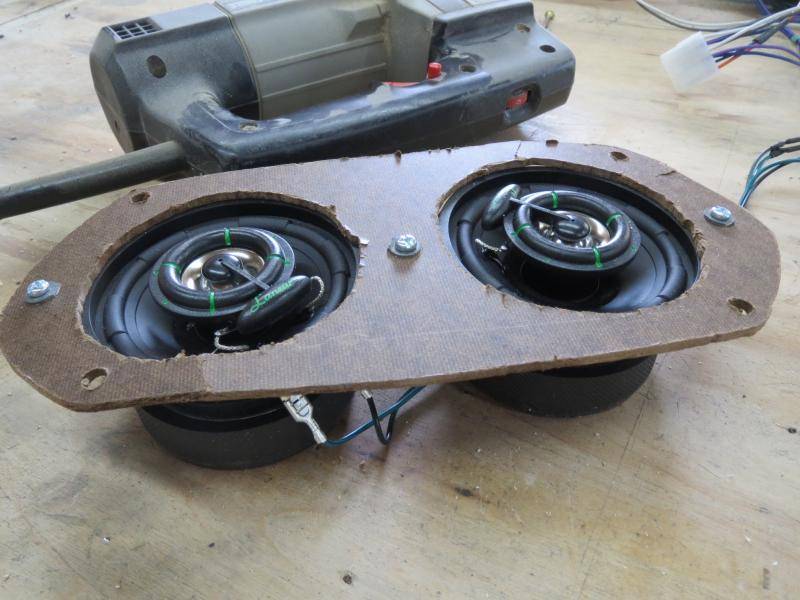

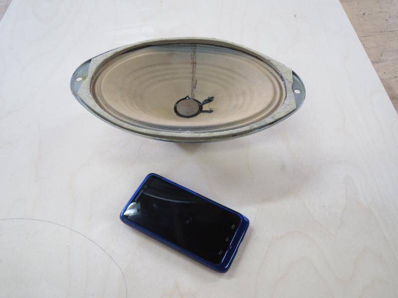

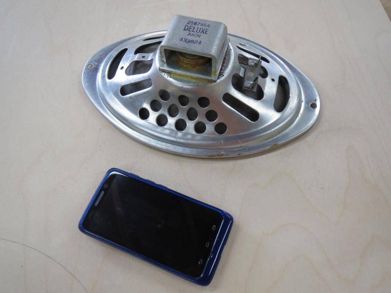

I had an original AM radio modernized with new guts so that it is AM/FM and jack for iPods/mp3 player. To do this the dash speaker had to be changed out and this little pair was suggested by the guy that did the conversion. I posted his info in the past but let me know if you want his contact number. I have to say that I am 100% positive that I am the first person to mess with anything under the dash, its truly immaculate! Here's the original 6 X 9 dash speaker. I should also mention that the radio, speakers, fader and power antenna worked flawlessly in this car and anything I take out will be boxed up and saved. The guy that did the conversion was no carpenter and I think he was also assuming that it was a much smaller speaker so I remade the mount for the front speakers out of a much more rigid material.

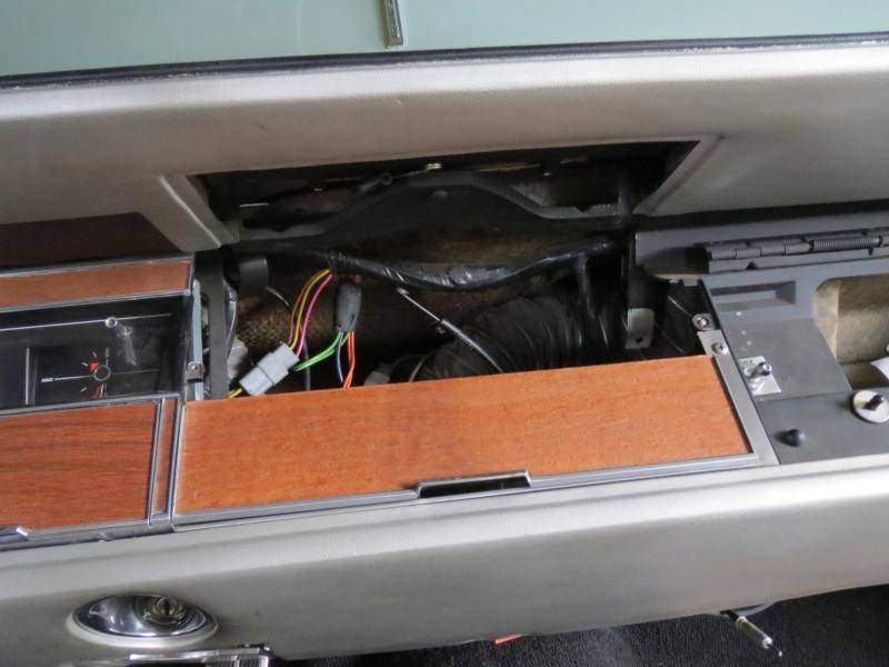

Here's the hole where it was. I got the fronts in, the heating system put back together and the new radio in. That's when I removed the rear seats so I could run the wire for the rears which I haven't bought yet. Originally this car only has one rear speaker and a rear defogger taking up the hole where the other speaker would go. I no longer have rear air...
later years they made a bracket that would allow for both but I borrowed one from a friend (CLover) and there was no way it was working on a '67/8. I then verified that no such part existed in the '68 Parts Book and no mention was made in the FSMs.
Im not going for audiophile quality sound here, just want to be able to hear the Tigers play on the FM band and play music from my MP3 on long trips such as Carlisle. I'll get some decent rear 6 X 9s. I hooked it up and the fronts worked.

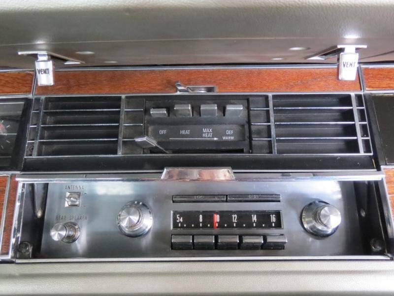

Here's the new radio installed, looks like it belongs there, right?
Flawless! :) I like the hide-away-door. Who did the modernization and how much did you spend, if I may ask?
I found a local guy that did the conversion for me and I would be glad to hook you up with him if you're interested. It wasn't cheap but I would have likely spent about the same money for a nice aftermarket system. It was $500 + by the time I put rear speakers in it.
