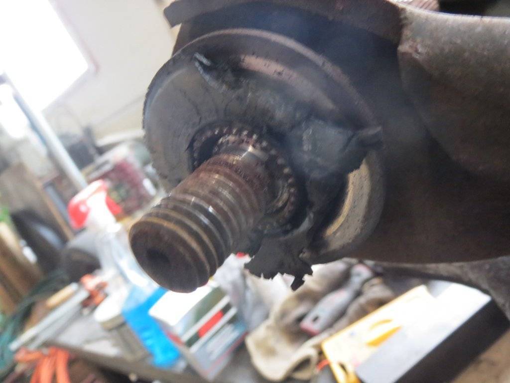

Finally time to start chipping away at replacing all of the worn out joints and bushings.
This car has been creaking and cluncking its way through the 15,000 miles that I've put on it and I can no longer ignore the worsening issues. A new clunk started which really lit the fire under my butt because I really want to continue driving the rest of the season. In fact it's taking us up north for the Labor Day weekend so I concentrated my efforts where I thought the new noise was coming from.

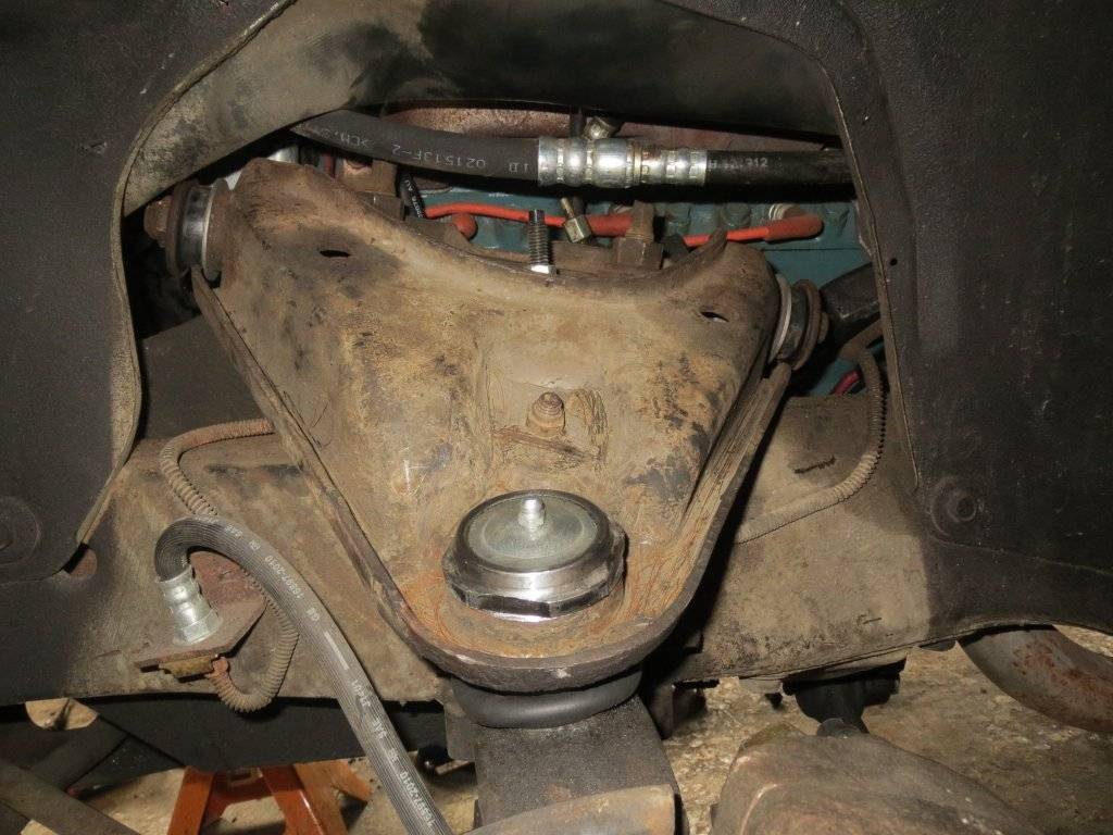

I figured it was either upper control arm bushings, the lower control arm bushing or the front strut Rod bushings so I started with the uca bushings and upper ball joints while I was at it. The ball joints were fine but the boots were shot and the new joints are probably only a few dollars more than just the boots so I replaced them. The bushings came out of the arms very easily and the new ones went in just as easy, I didn't even need a press!

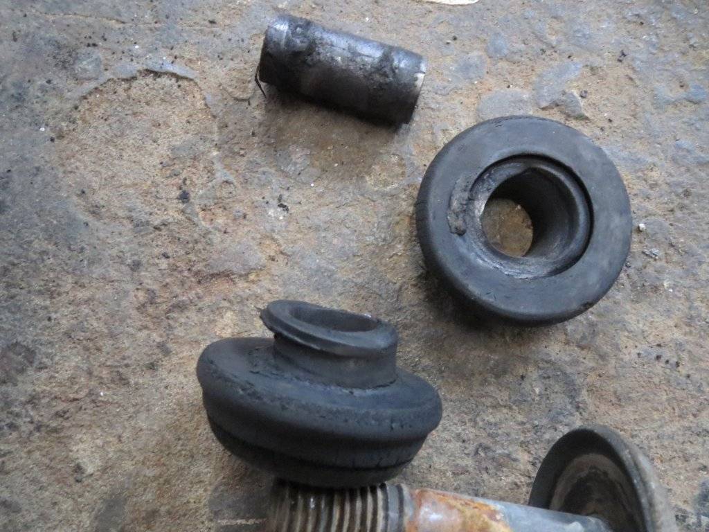

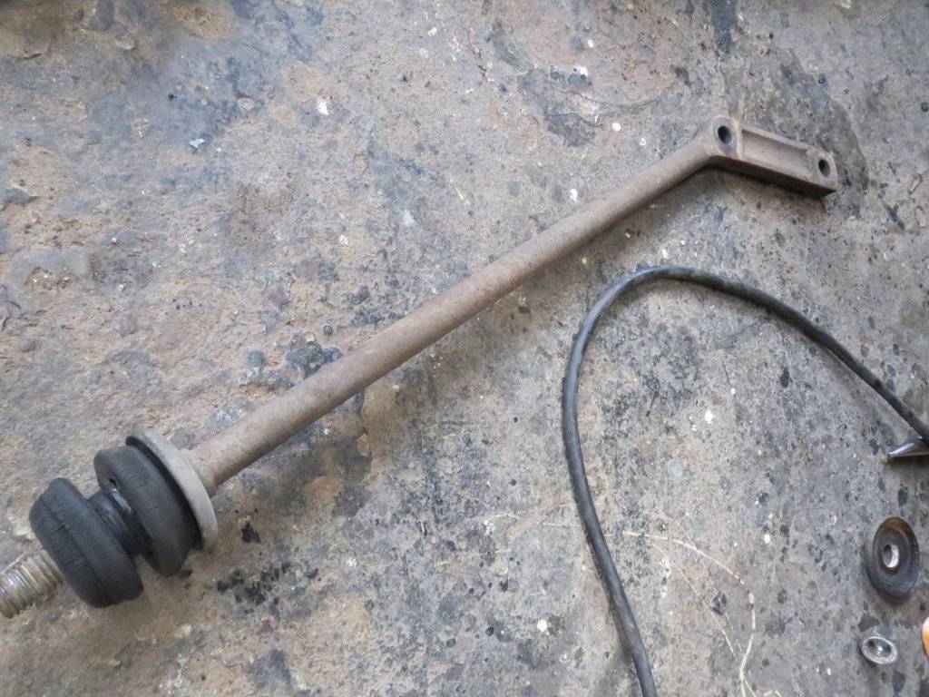

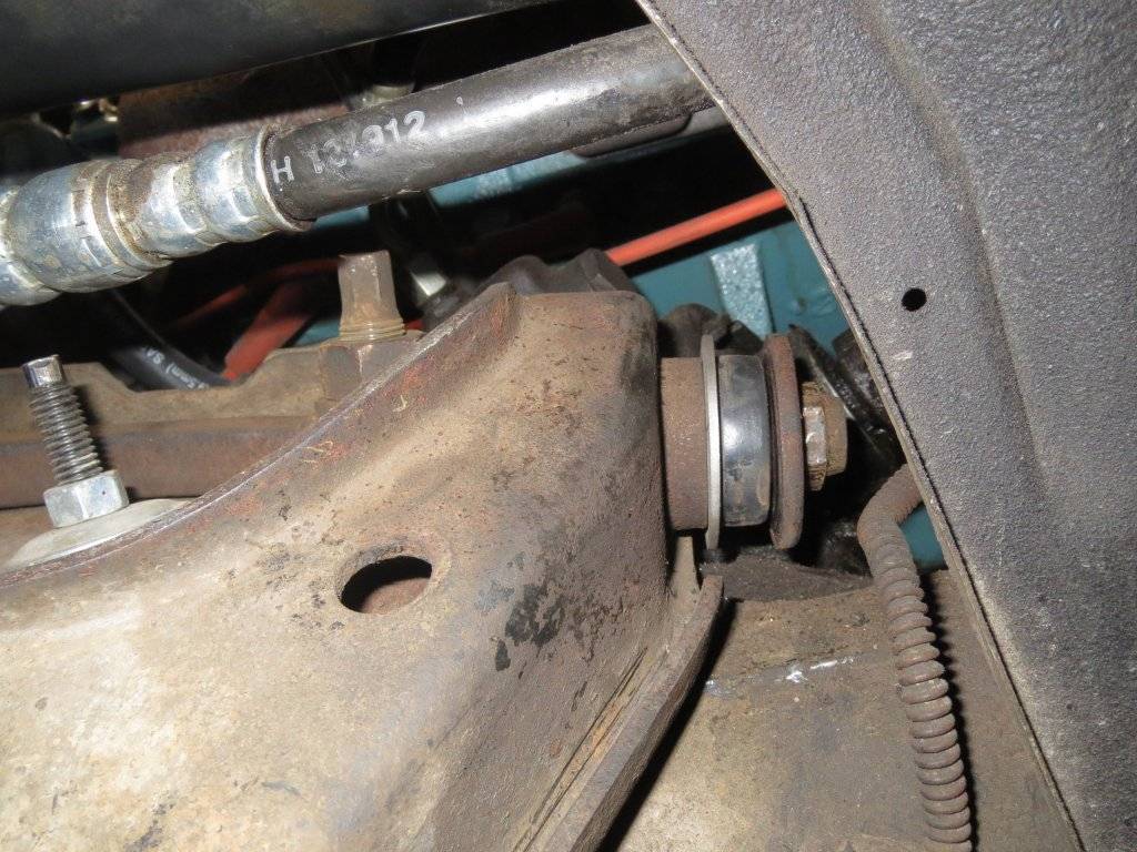

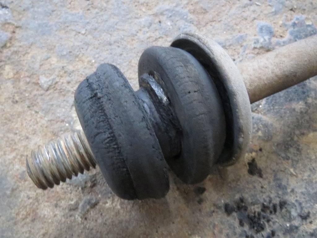

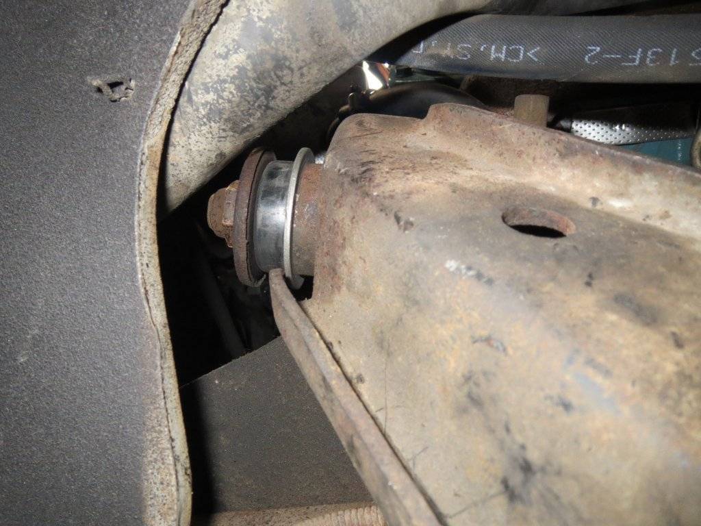

I learned that the strut Rod bushings are the same for the B-bodies and were in stock at one of my parts stores so I replaced those at the same time. I actually think these were the cause of the new clunk but I can't be sure. So here are some before pics.

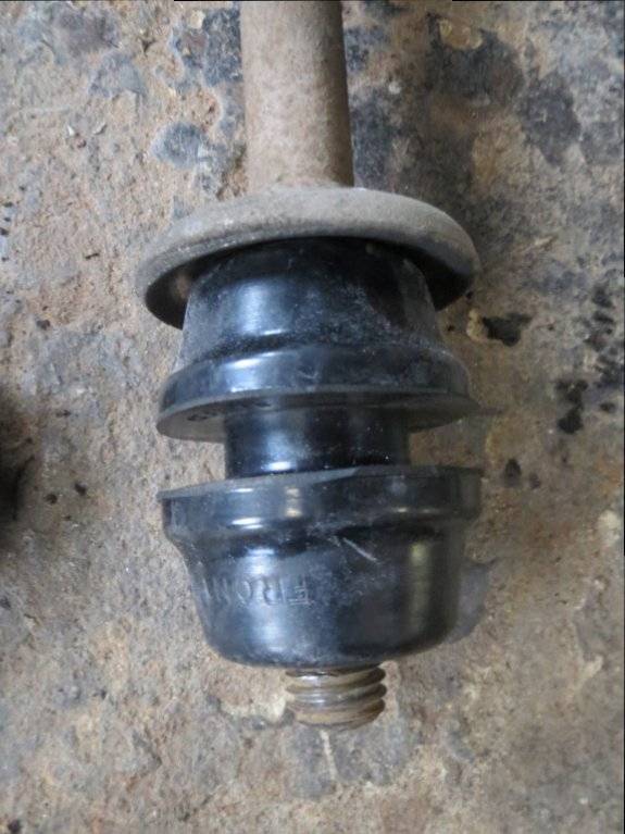

These are the old strut Rod bushings and they were, well let's just they that they were long expired...
Here's one side all new and the new strut Rod bushings. The front end is considerably less noisy and I'm very pleased with the outcome. Next time around will be the lca bushings and lower ball joints.

Thanks friend. Do you have pictures of the Uca bushings removal? I'm scratching my head on how to do it with the bar in the middle?!
Yep I scratched my head for a while on that one too. I thought maybe I was going to have to carefully cut them out as a last resort but I was able to support the arm with a bunch of clamps and scrap steel in my press frame for starters. Then soak with penetrant. Once supported and braced I was able to take a pickle fork and place it on the inside of the outer sleeve of the bushing with the shaft going in between the forks, you follow? Then proceed to beat squarely on the fork with a bfh until it's out. You will want to have the end of the handle of the fork supported on something so that the tool is square with the bushing. I didn't take any pics of this embarrassment as I did have my hands full and also keep in mind that this car comes apart as if it were assembled 3 weeks ago, your results may differ. The shaft is a GM style assembly though and I'm sure you could find a machine shop that can r & r the bushings more efficiently.
Jep, got it! I will give it a try, but I thing this will not work with my crusty old parts :/ Thanks anyway!
