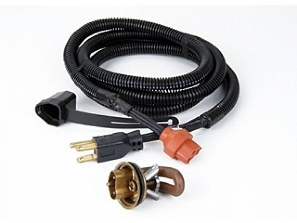

You could put one in just as a conversation piece.
It just pops into the freeze plug location. Stock will be the plug closest to cylinder #1. When it’s plugged in the little heating element makes sure the block gets warm to keep the oil less viscous so it’s a lot easier to start in colder weather.
Ahh so that’s how they work! That’s actually really neat… Would be a cool conversation piece for sure!!
If I were to use a block heater, this would be the One. Kludging them into the drain plugs, as the old one I inherited with our "pre-cracked" 1968 383, and altering the coolant flow with that arrangement is one I'd avoid.
