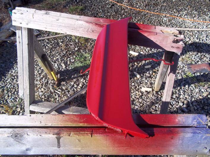

My other news is that i've decided on and purchased my paint. It will probably be spring time before i get around to painting the car tho. We've run out of good weather i think. Still a bit of work to do to get the rear quarters done. But here is a bit of a teaser pic. We sprayed a fender skirt to get an idea of the paint in the sunlight. Not wetsanded or buffed yet... Just sprayed and cleared to see what i looks like. I like it alot. I'm gonna worry about figuring out the wheels later on.

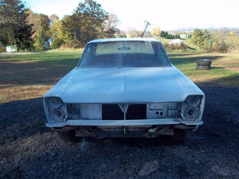

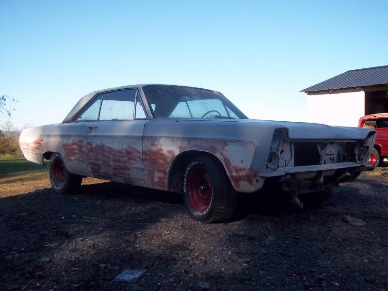

And, for the sake of documenting progress, here is what is going on with the body work... Not proud of these pics ha ha! The only thing left to pull off the car are the door handles. Putting that off til the last minute. We misted/tiger striped some red primer over the entire car. It allows me to see the low spots/ pings and dings in the white paint while sanding. Then i started hand block sanding her down. Got the top, hood, and trunklid sanded. Starting to work further and futher down.Don't think i'll ever become a full time body man. It's alot of work! Once i get a panel done we're shooting a urethane primer over it. Then repeat the process... Slowly starting to shape the rear quarters as well. Slow, slow going...

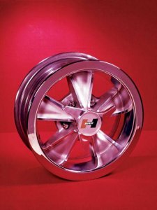

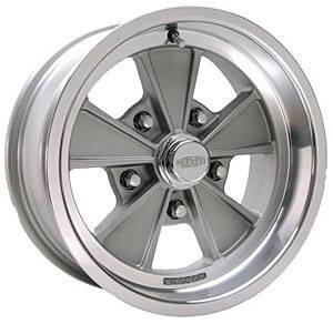

Hey y'all. I decided on and ordered a set of wheels! Since the weather is'nt co-operating i have been surfin the web and lookin at wheels. Another step forward! I think these will look good on the car with the paint i've chosen. I ordered 15x7s for the front and 15x8s for the rear.
New wheels:

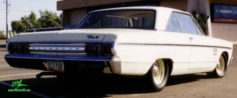

The stance i want:
Hate to say it, ha ha!! but i do realize i may have to lower the rear a little! What size tires do y'all think i would need to get there? I like the wider rear tires...
New wheels:

The stance i want:
<img src="http://www.forcbodiesonly.com/mopar-forum/attachment.php?attachmentid=7110"/>
I think the biggest 15" 70 or 75 series profile tire that will properly fit on a 7 or even 8" rim will give the baddest look and still fit properly.
