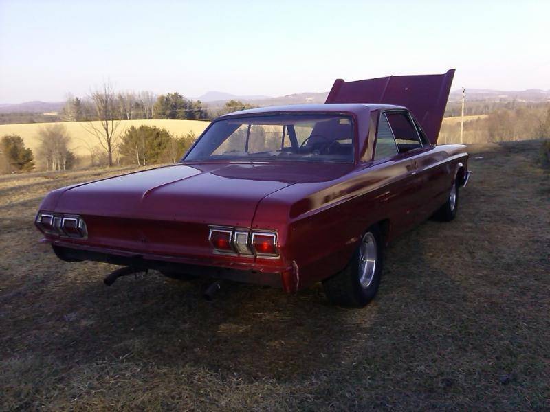

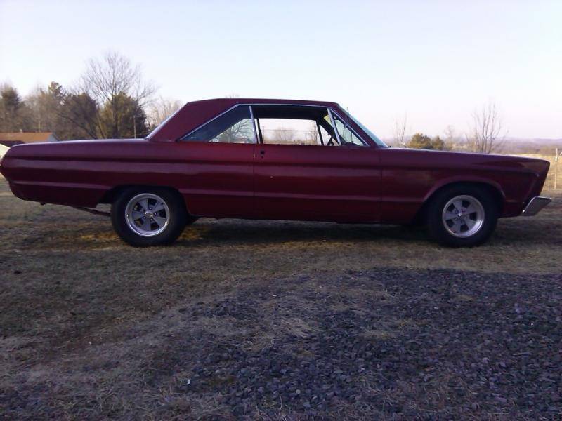

Thought I'd put up a couple pics. Got my new vacuum secondary carburetor on today. Car is much more well behaved! Tomorrow I'm going to finally solve my rear gearing question. It has to be a 2.??? something... I'd like to have a better pull from take- off. Guessing a 3.55 gear set and maybe a stall convertor will be next on the list. In addition to the carb I also have a 20 gallon fuel cell and a set of shorty headers as well as different mufflers to install. Got a lot to do before spring!!!

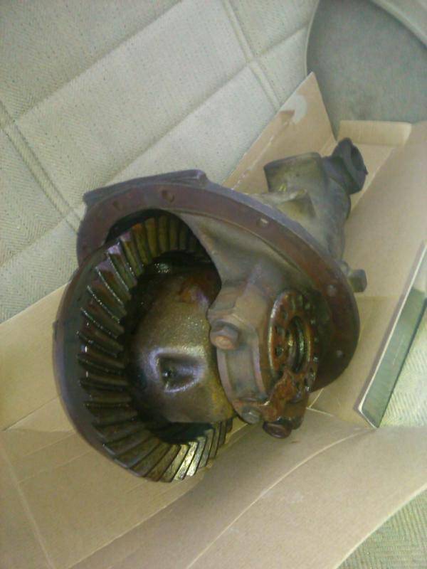

Okay, so I got a good deal on a 4.10 gear set from an older Dodge truck... And while that was a little deeper than I planned to go I couldn't pass it up! With the taller tires on the back of my car it will probably be more like a 3.91. Not that there's that much difference. It rolls smoothly and all the gear teeth are in great shape and show good wear. I will be putting the Sure Grip unit from my housing into this one as it is single track... Should be a different car come the weekend!!!

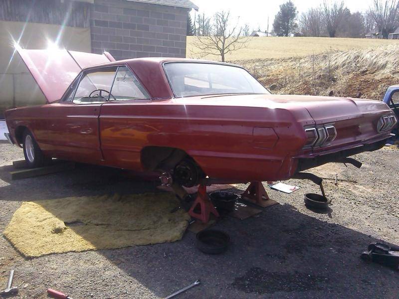

Got my center sections switched around earlier today! One word - WOW!!! Turns out my 2.76 set was a single traction unit as well... All we had to go by was with the rear of the car on jackstands if you turned one wheel by hand the opposite would turn also... It still does this with the new center section? I'm a bit confused by this I'll admit... At any rate, Mopar meant for these cars to plant and hook. So no tire fire today ha ha! But, talk about a difference... Its like night and day! The old Fury pulls hard throughout the whole band now! Feels like a very strong car! I have to reset the timing and maybe tune on the carburetor a little, but I am extremely pleased with this modification. Fuel cell is next on the list.IMG_20140308_132753_130.jpg
Today we reset the timing with a timing light and also put a vacuum gauge on the carburetor. I thought the car felt strong yesterday! I will now officially call it quick!! It truly surprised me!!! It still won't break traction. Just puts everything to the ground and digs and pulls... It is a wonderful feeling! I've had fast Mustangs before, one that was Procharged and ran 6.80s in the 1/8th mile. And while that was fun it in no way compares to the feeling of the Fury launching and pulling. If I had to guess, I'd say she'll run solidly into the 8 second 1/8th mile range. Which to me is a very respectable time for any street car, let alone a car of this size. I'm kinda surprised that I don't see more of these cars hot rodded... While I love an original restoration, these cars seem to work very well with only a few parts thrown at them. Still need to get the headers on and the rest of the exhaust straightened out. Couldn't be happier... :eek:s_dancing2:
