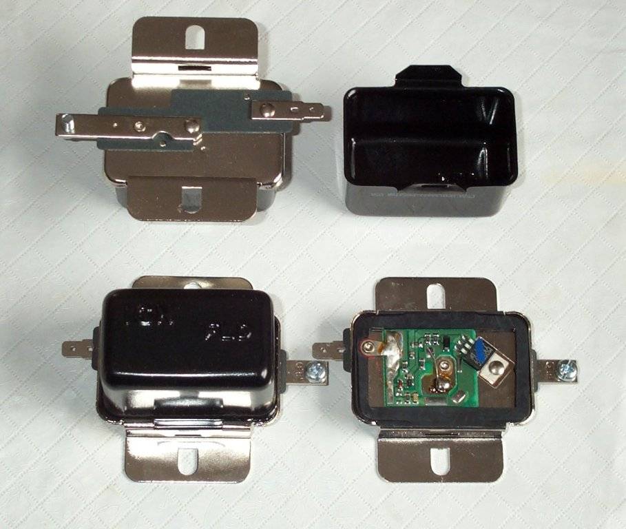

In stock form, the early regulator is mechanical. There are points that "make and break" rapidly to limit the voltage to the field. The later regulator is electronic and does the same thing electronically and much faster giving a more constant output to the alternator.
So.... an electronic ignition conversion "requires" an electronic regulator giving a constant voltage. At least that is what Chrysler has always dictated in their conversion kits.
Since the conversion kits have come out, electronic voltage regulators for the early alternators have become more available.... and there are a number of people that have used the mechanical regulator on the conversion with no issues.
As I said, not a bad conversion and if you want to do it, there's nothing wrong with that.... but you can buy an electronic regulator from one of our members here pretty reasonably and leave all the wiring alone. Talk to
