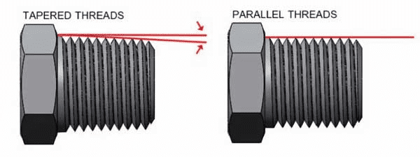

NPT= National Pipe Thread. Pipe threads are tapered rather than straight.
