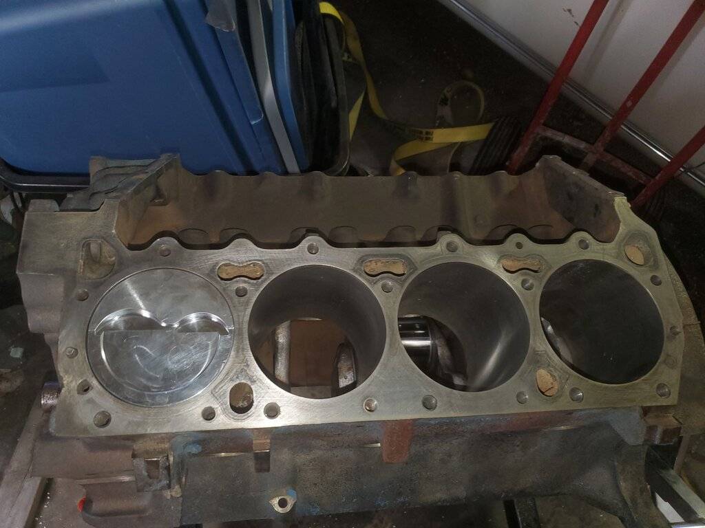

Starting basic mockup before it heads back to the machine shop after...whats the best way to check piston to deck height so a guy can get zero deck height? Straught edge and feeler gauges? Dial indicator?

Ill have to buy a deck bridge and dig up a dial indicator unless i can get something rigged up. Thanks guys.
I'm not certain as to if I'm seeing that piston in your post correctly, and for a mock-up it wouldn't matter, but that piston looks like it has specific locations , as installed, with the bigger valve notch provision for an intake valve. I see it as being in the wrong cylinder hole! That one would reside in locations 3, 7, 2 and 6. But maybe I'm just seeing things!
It probably isnt oriented correctly valve wise i just put it in to get an idea of deck height to see how far down it would be in the hole.
