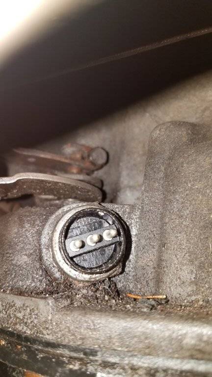

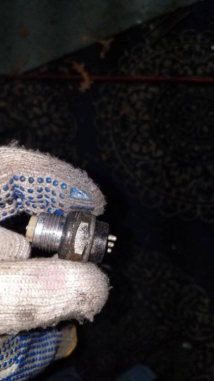

Good morning all. I found a 46rh with a 3k convertor to put in my 71Fury. Got it for a song and a dance. I'm relatively close to starting it but the case connector is different both 3 pins the 727 has longer pins. Can I safely do a swaparoo with hurting the RH. I haven't put the PATC OD kit on yet I just want to make sure this thing actually goes into gear ( I did buy it used ). I know the connector on the RH handles OD and lockup of convertor as well as backup lights. They look very similar but plug doesn't fit .
There is usually a reason that plug configurations change, usually that means the plug now has some different function. A-727 3 pin connector is used to complete the circuit to the backup lights (The two end terminals) the center terminal supplies the ground to complete the circuit to the starter solenoid. That is probably not going to play well with the 46RH. You need to spend some quality time with the wiring diagrams because I doubt this can be made to work without some type of after market controller for the RH. I think there are some posts on the web on how to do this conversion into older 727 equipped cars. The other question, is that the RH was noted for locking convertor failures, usually this spread friction material thru the transmission and pretty much ruined everything, that is why they are so expensive to rebuild. Might want to consider putting an OD unit on a A-727 without the locking convertor. RH was cheap, but likely will not be such a good bargain over the longer term.

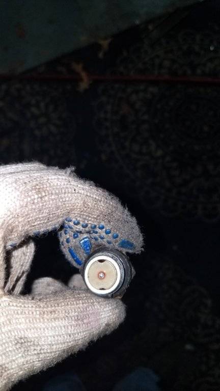

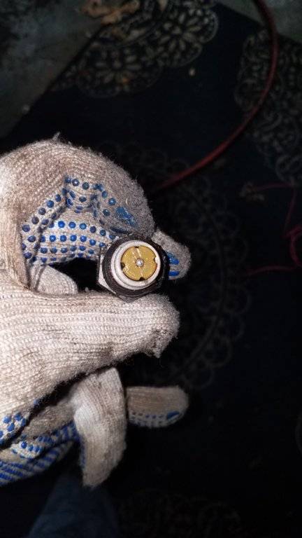

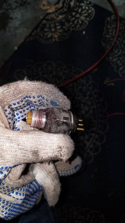

Switch is fine use your 727 to be compatible with your car. They changed the connectors on the trucks and vans to finally rid the goofy 70s connector.
Thanks all. I ordered the kit from PATC should be here next week , I'll work out the OD. The car now has 3.90 gears so I wanted the OD . The 3k convertor should be ok , the motor is a mild built 360.
Tonight I installed the switch from the 727 and fired it up with the rear end on jack stands to make sure itll go into gear and no vibrations . So far so good . I'll take it around the block tommorrow still have plenty to do before I'll take it for a long run but it seems like the RH should work out alright .
