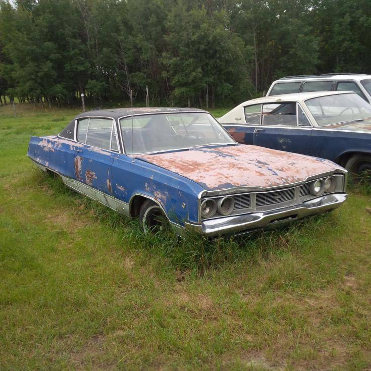

This one:
I gotta agree. Really nice ride and I like it all. :) That's what alot of time and money does to a car.

I would drive the hell out of it. Love the blue, it looks nice on that body. The wheel aren't doing it for me, but that is a minor fix.
