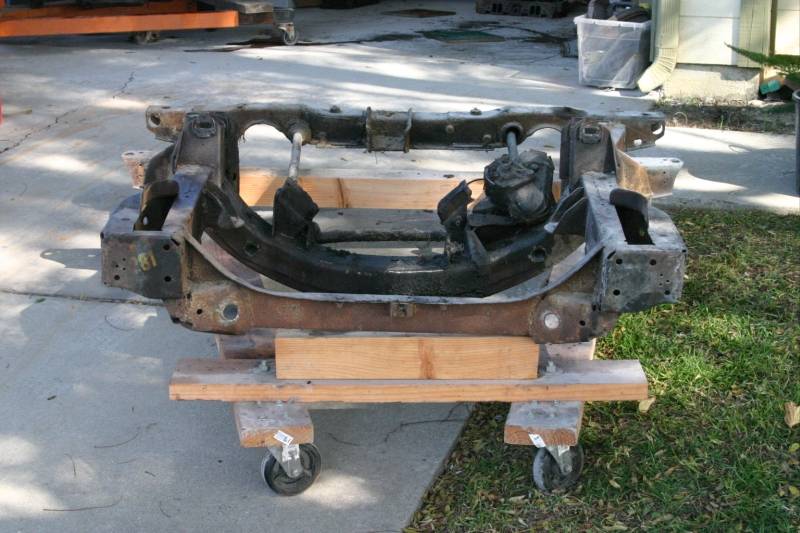

The steering column in a 69 C-Body in not inline with the center of the car, the left side of the steering wheel is closer to the dash than the right.
It may be hard to see in this picture but the steering gear points to the side.
Alan
Alan
That's exactly what mine does. Just kind of odd once I noticed it .
I noticed that on my Imperial, it is something I try to push way back in my brain. I was thinking of trying to straighten with some readjustments. But seeing the steering box in photo has me thinking other wise.
