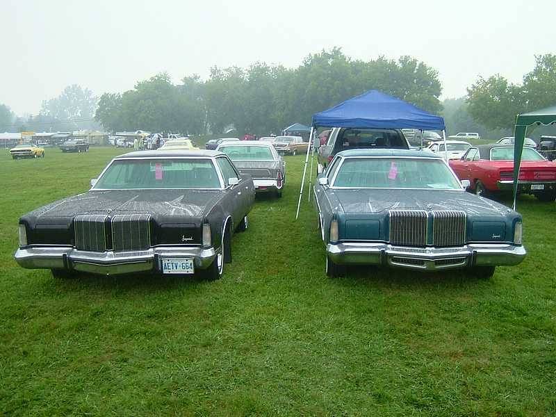

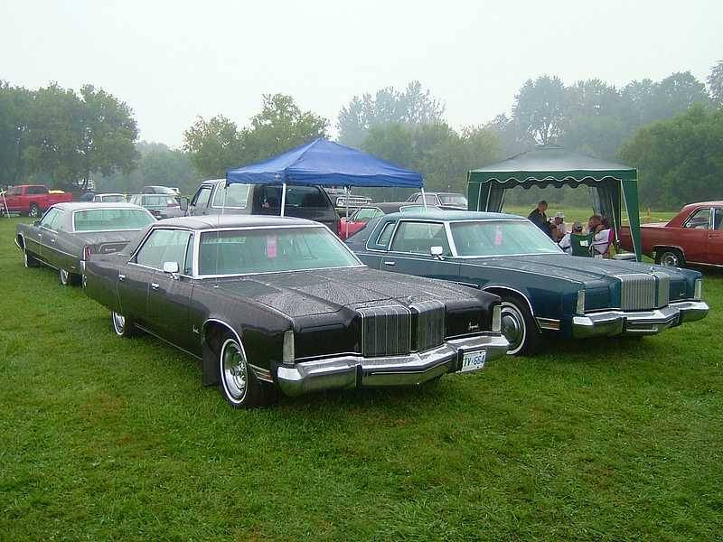

My friend and I attended Moparfest one year in our Imperials. He had a stock Cali emissions 75 Imperial (air pump and all), and I had my Canadian emissions spec (i.e. no cats single exhaust at the time) 74 Imperial (now Cantflip's car).
The 74 absolutely smoked the 75 in performance/ power. I don't know if the cam spec was different, but those Cali spec cars were just slugs. Early days of emissions just killed what little performance was left after the post muscle de-tuning.
Some pics of the Imperials that day...
