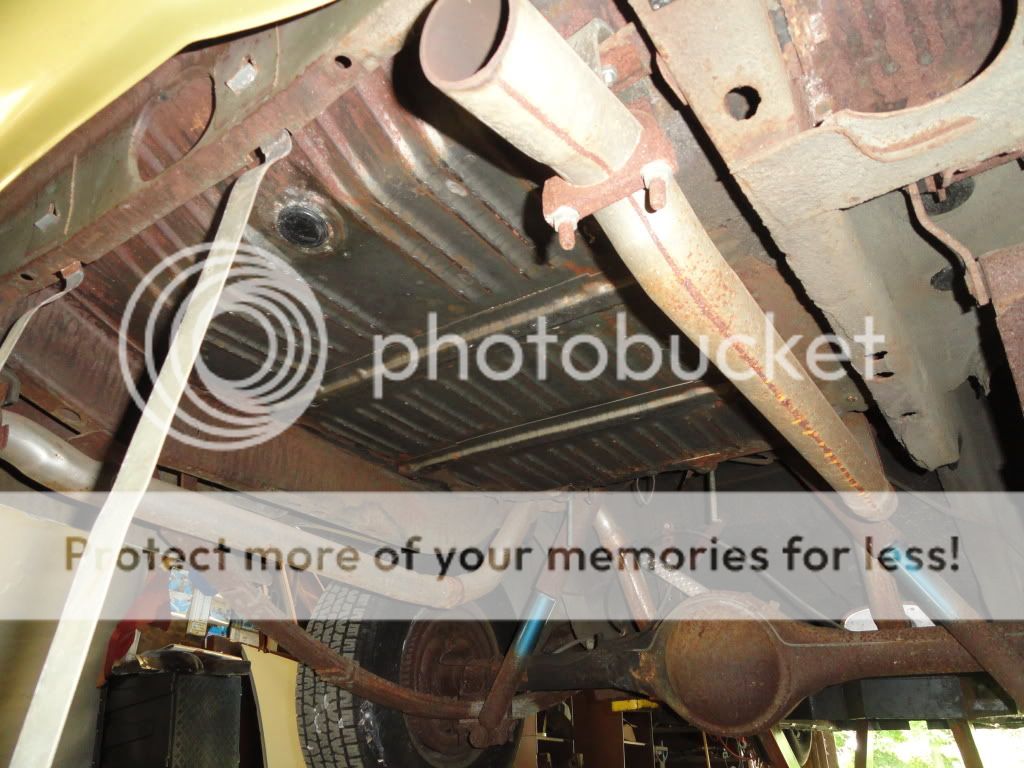

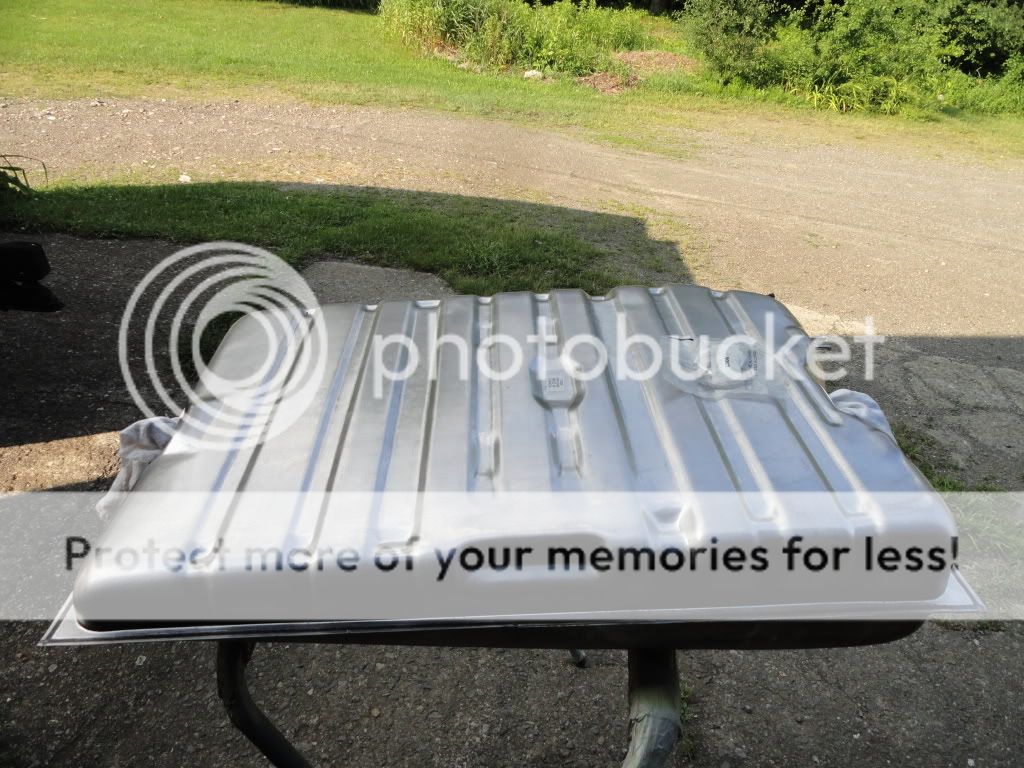

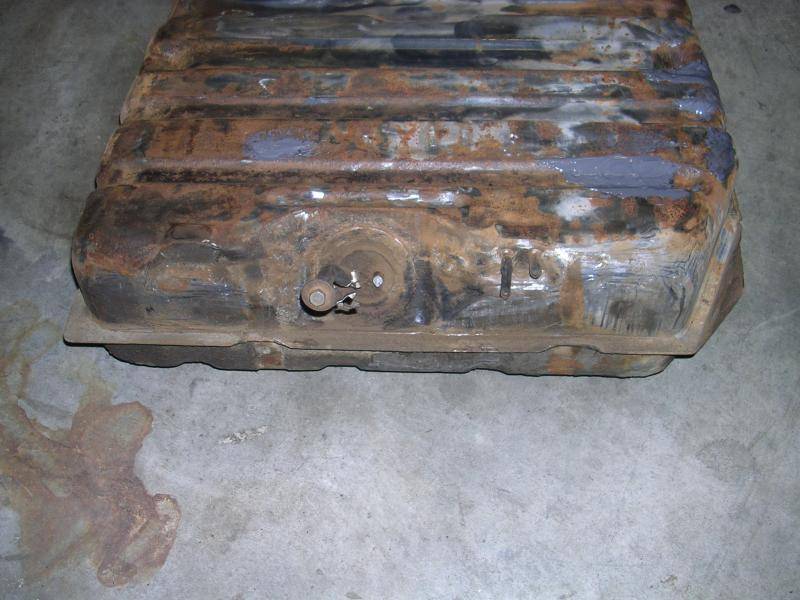

I read your thread. I have a 1970 Fury, which is basically the same car. I love the 70-71 Hidden Headlight Furies. You bought a great looking car. I noticed no response on the fuel tank question, so I thought I'd take a stab at it. These are my notes from removing a fuel tank last year from a 1970 Fury Parts car. Note: After removing the tank, take it to a shop to have it professionally cleaned out, but if they offer some $200 internal coating, reject it. It's a rip off. Cleaning out the tank should be no more than $50. As far as they fuel lines, if they look OK, I would just replace the fuel filter and let it do its job. Inline fuel filters are cheap. You can always run a clear plastic one for a few miles and look for rust particles. If present, replace it with another.
9-16-13 FuelTank
· Siphon as much gas as possible out of tank. JackCar: jack front of the car high, 6 notches on front jackstands. Jack rear at axle: 5 notches on jackstands under frame forward of axle. Car level with plenty of room to drop fuel tank
· Filler Neck: remove mtg screw, 7/16 socket, 10 ext, 3/8 BB
· Hoses: 1/4 socket, 1/4 ratchet (R) to loosen clamps at fuel hose and 2 vent hoses
· Fuel Hose: plug at tank with 5/16 thread bolt and clamp
· Fuel Line: plug with 5/16 hose, 5/16 thread bolt, and clamp
· Filler Neck: turn 90 degrees C, so mount clears hole in frame as tank moves forward when dropped
· Tank Straps: spray WD40 on front studs. 9/16 wrench to start CC until within depth of 9/16 long socket and 1/2 R.
· Jack Under tank: best to set up slightly forward of center.
· Tank Straps: finish remove 9/16 nuts on front studs
· Fuel Tank: push forward and lower to floor: not many leaks, but wish I'd assistantto hold steady.
· Fuel Tank Pad: good condition
· Fuel Tank: 3 pin sized holes at top front left.
· Trunk Floor Above Pin Holes: rotted out in 6x6 area. Cleaned out with pry bar and channel locks
· Sweeping: lots of sweeping up rust

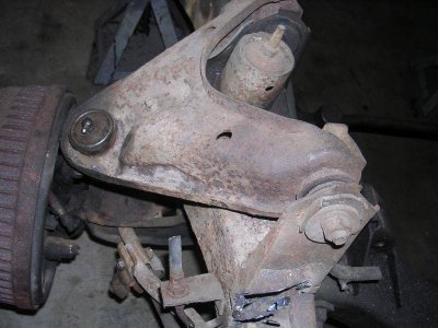

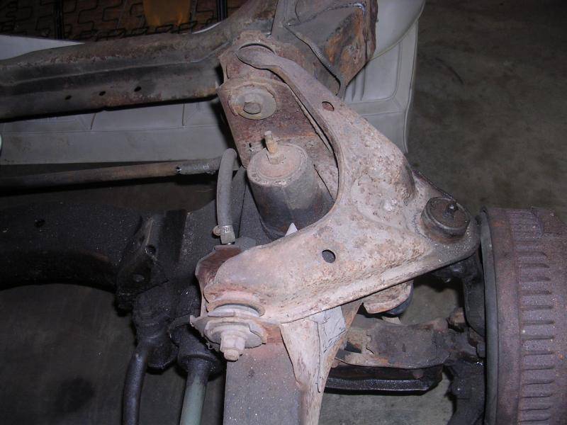

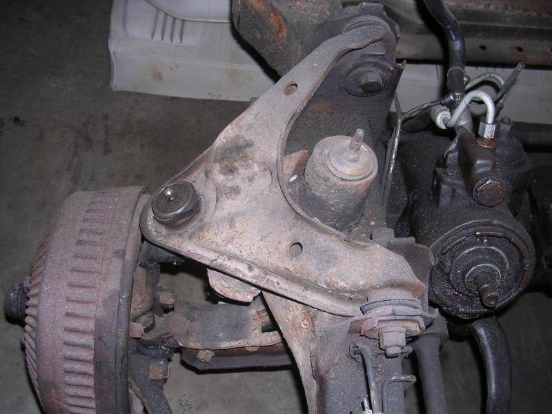

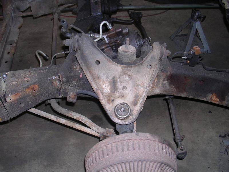

Replacement Upper Control Arms
These are from a 1970 Plymouth Fury. I actually drove it for a year before deciding to part it. No handling problems. They are an exact fit for your car. $50 plus ship for the pair if you want them. Note the passenger side pictures don't have a steering gear beside the upper control arms. PM me if you still need a set.

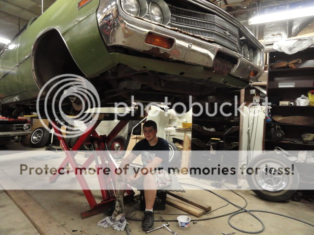

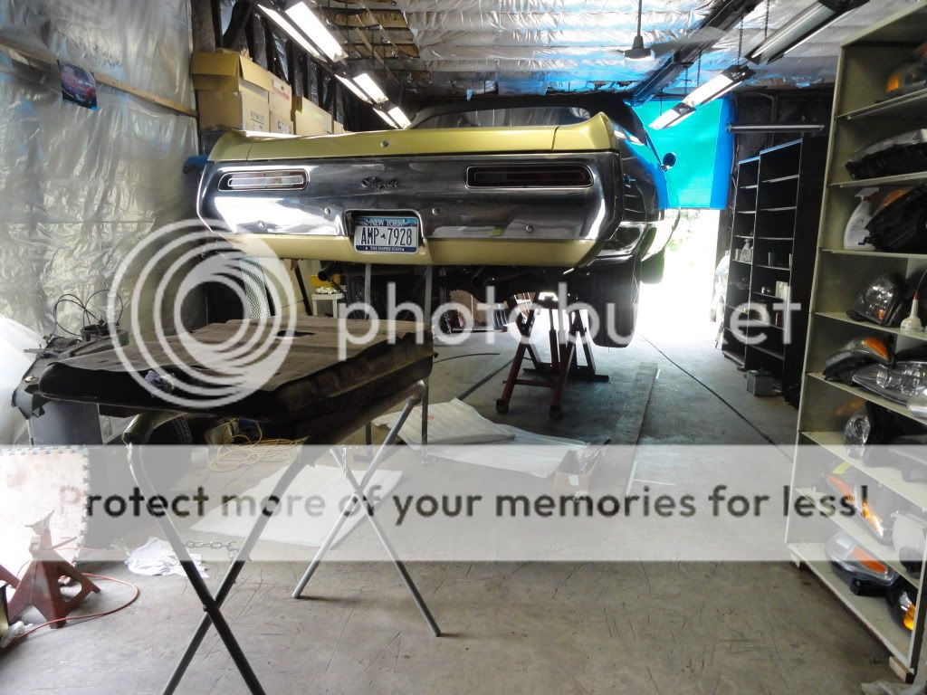

Boy that stand looks very precarious (the one under the car). That is a lot of weight up there in the air.
Sweet, I will look into the upper control arms 70FuryConv. Thanks for the offer, let me look at mine before I decide. I might have to go with a new gas tank. Is there a good product out their that you can put into the fuel tank to clean the Carb jets. I heard of Sea Foam? Any ideas?

My friend with the ford's has a hydralic jack like the one pictured above. Let's just say I would'nt feel too comfortable working under that car with just that jack for support.
Jon
Its a SnapOn dual piston scissor lift rated for 3-3.5 tons
:laughing4: :laughing4: :laughing4:
I love showing that picture to people and hearing their reactions haha. I was changing the starter in that picture. As long as you take precaution and use common senses its going nowhere. The pump doesn't even struggle to lift it up!
They use three of these lifts in my son's auto vo-tech class. They are really great lifts, and amazingly steady. I've been tossing around getting on for my shop. These also work well in a normal attached garage.
Yes. Haha. It's not going nowhere until it does. Then it's called an accident.

better hope the lock and rubber o ring holding it all up aren't made in china...bottom line that setup is a accident waitin to happen...
