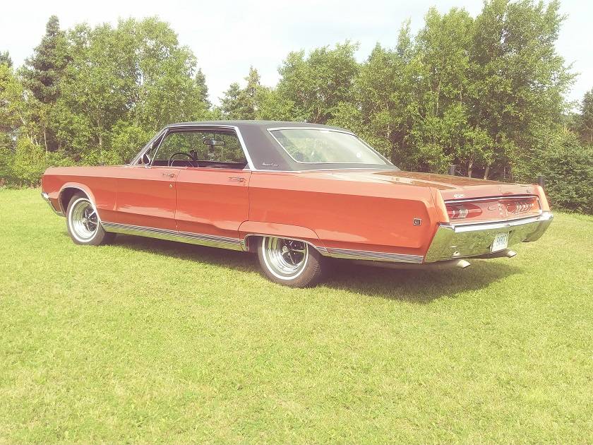

Tips should be at least 2-4 inches past the lower portion of the bumper but not sticking out past the top of the bumper.
This also reduces drone and not look stupid at the same time.

I have a set that is just under the bumper, every now and then I get some exhaust fumes wafting into the cabin. Guess I'll just have to drive faster!
Thanks! it sounds awesome....nice deep rumble but not intrusive. It really has a wide open exhaust now as neither the Borla's nor the resonators have any baffling.
That guy did a stellar job!
Got everything tucked up nice and tight, and terminated the tailpipes properly.
Can we see the rest of the car?
