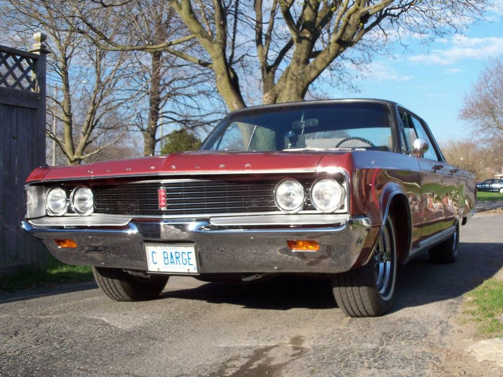

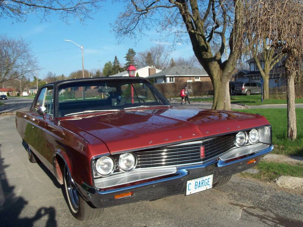

After a long and anxious winter here she is!!

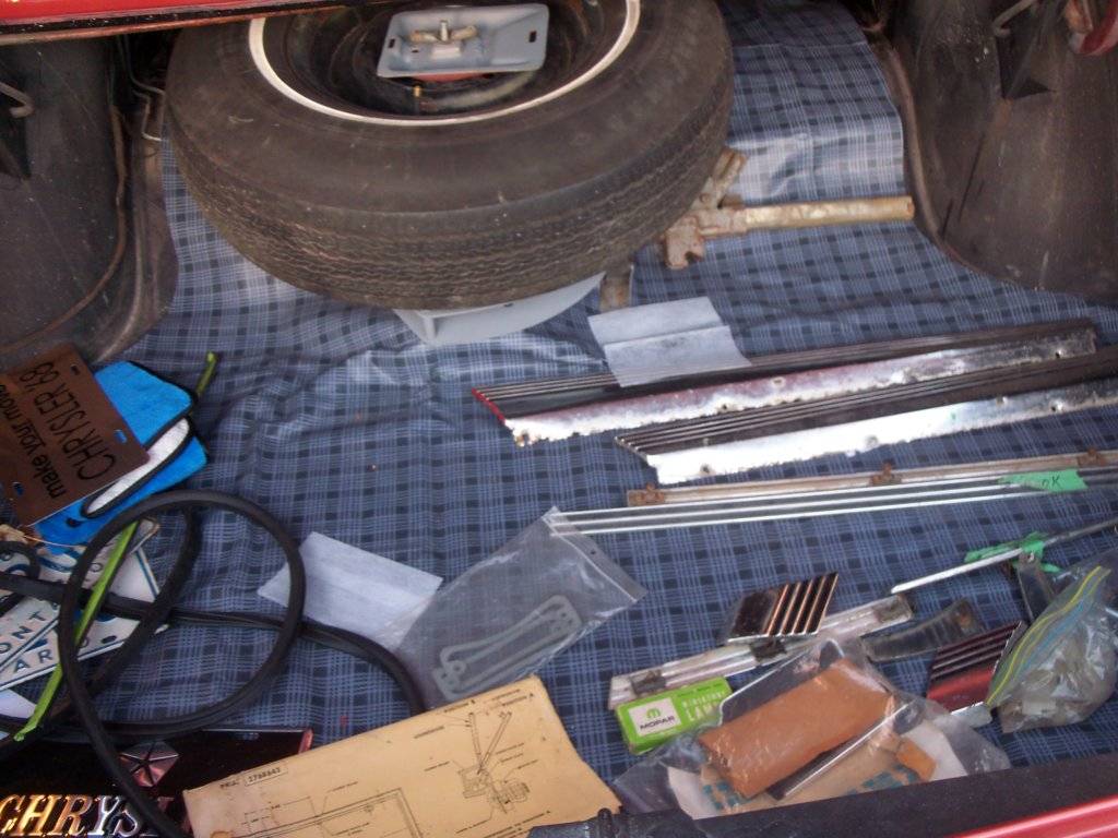

I have to get back to work to finish odds and ends. The side trim is in the trunk..some assembly required..LOL
3rd time? As soon as the drivetrain was installed and functional, I'd have spinning those wheels!

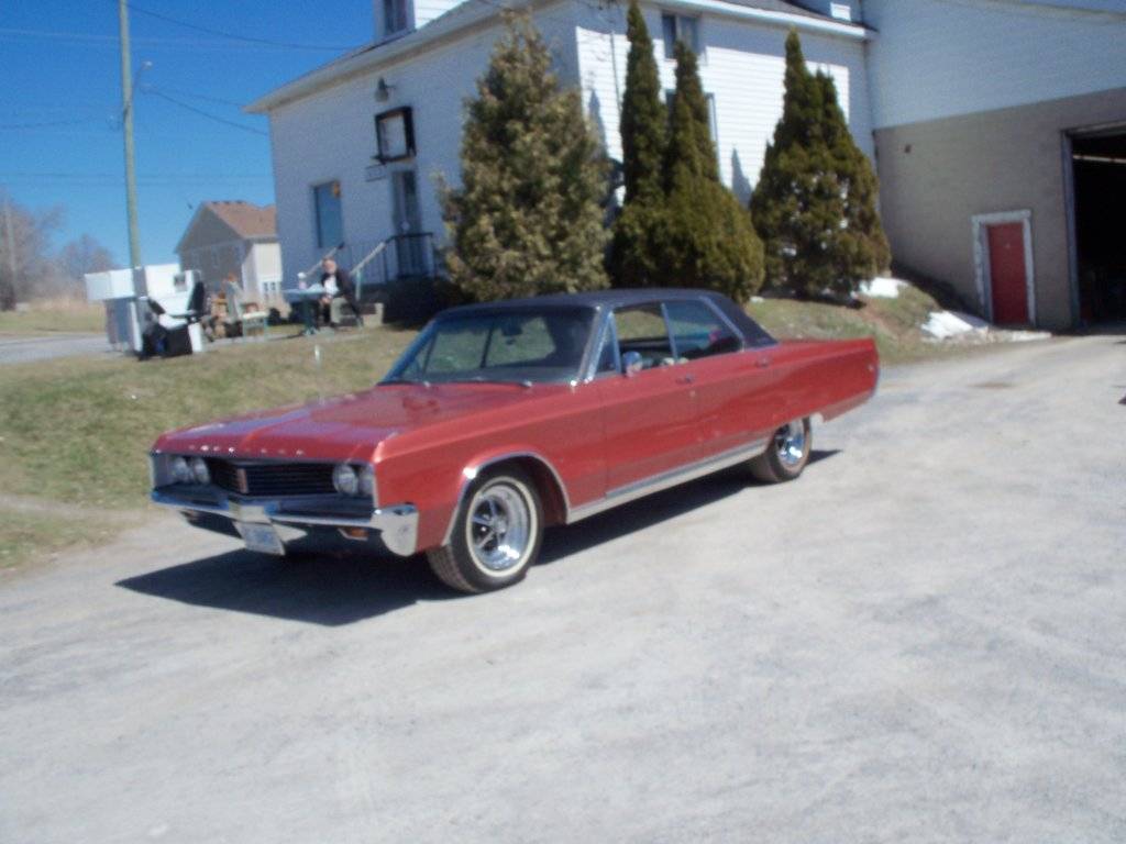

Got more trim on the car today. I should have all trim done tomorrow.
