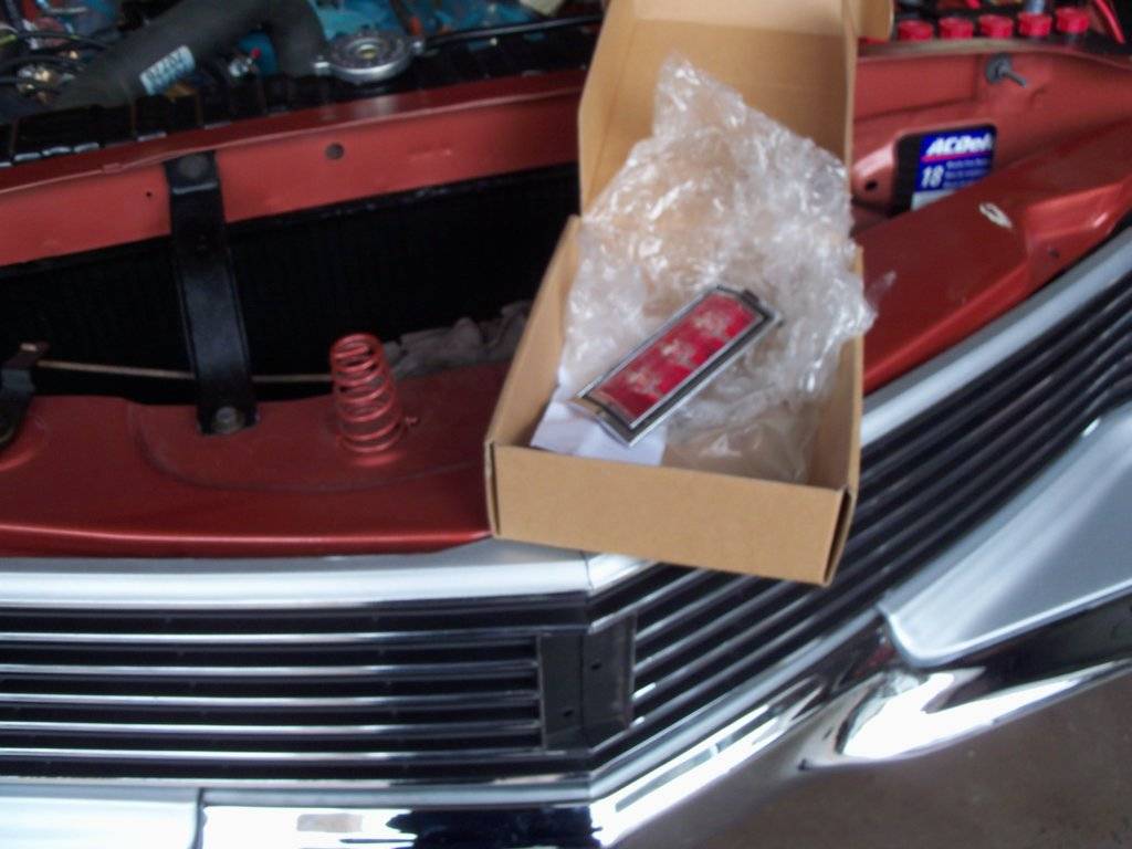

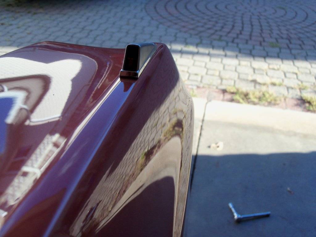

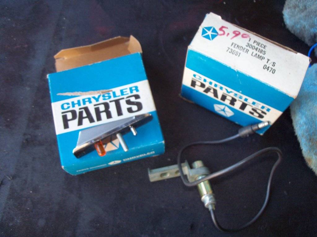

Installed my NOS fender mount turn signals now 'cause it is easier to get to the holes before installing the rest of the fender trim.

NOS eyebrows,and hood molding is on.

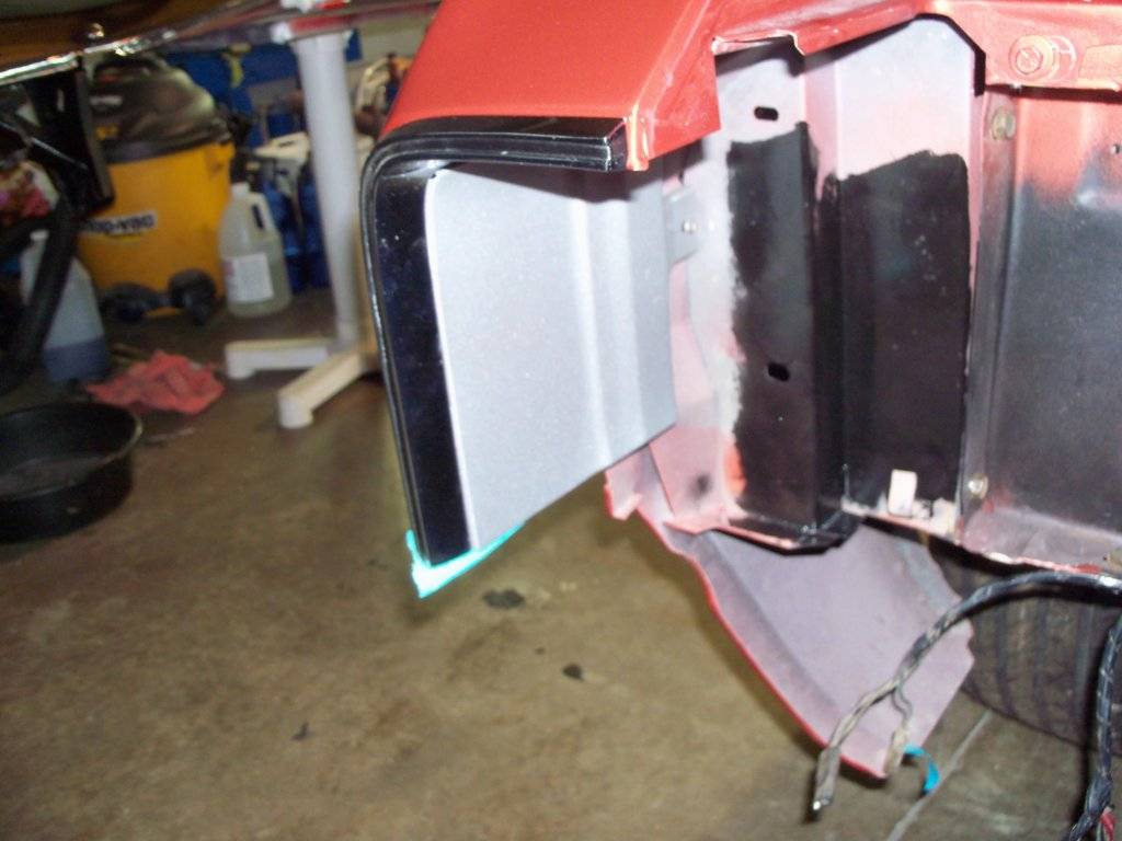

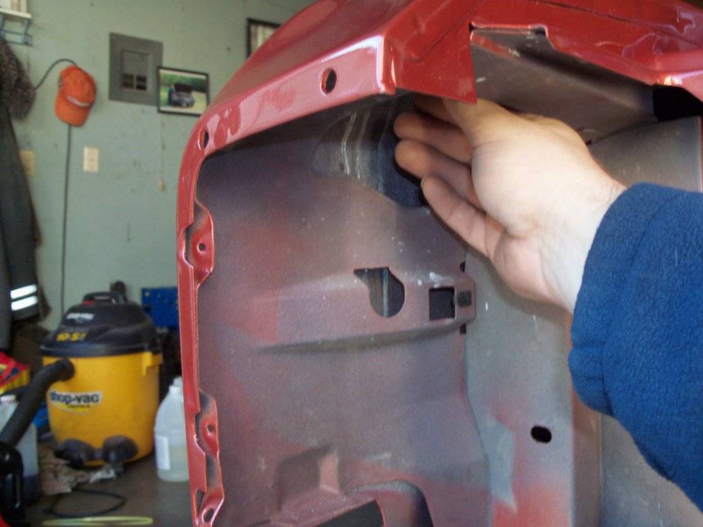

Painted and intalled the filler panels.

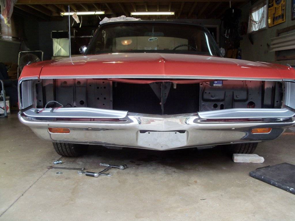

Assembled and installed the front bumper.

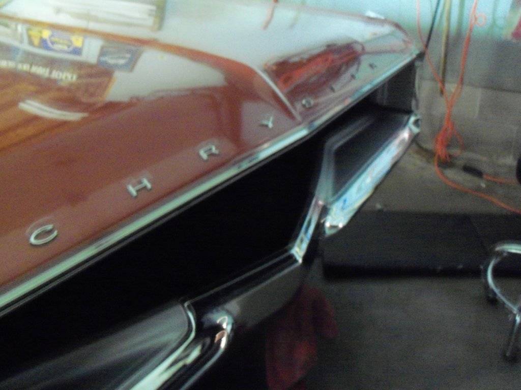

Cleaned and installed the hood letters.

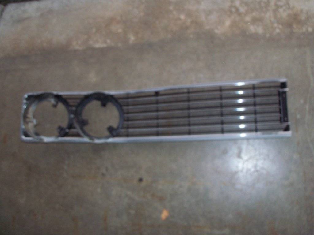

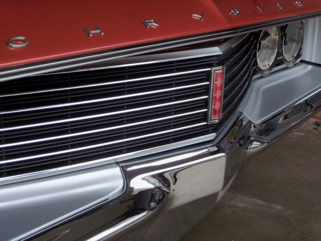

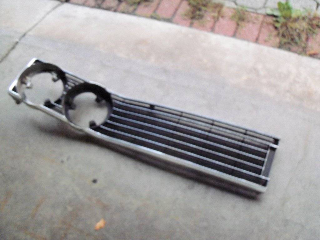

I think the grille is kinda plain.
To live up to its "Custom" part of its name,I did my own spin on the grille.
First with the dremel I polished the chrome ribs.
Then I Painted the backside and front of the grille flat black.
While the paint was still wet,I wiped the paint away from the chrome ribs.
Once the black paint dried,I covered the face of the grille and painted the Argent silver on the surrounding frame .
I will post a better pic after the grille is installed..

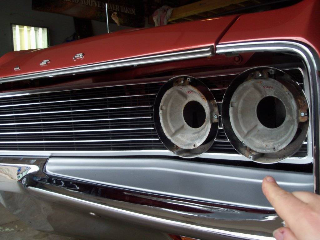

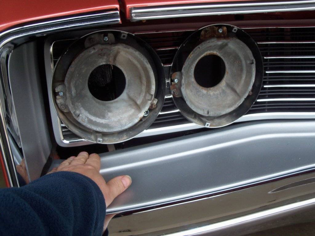

Test fitted the grille and the gap between it and the filler panel were huge.
On and off numerous time until there were no more allowable adjustments.

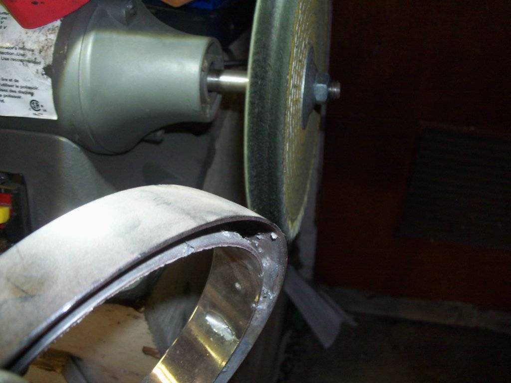

Polished the headlamp rings and bezels
Then installed and aimed the headlamps

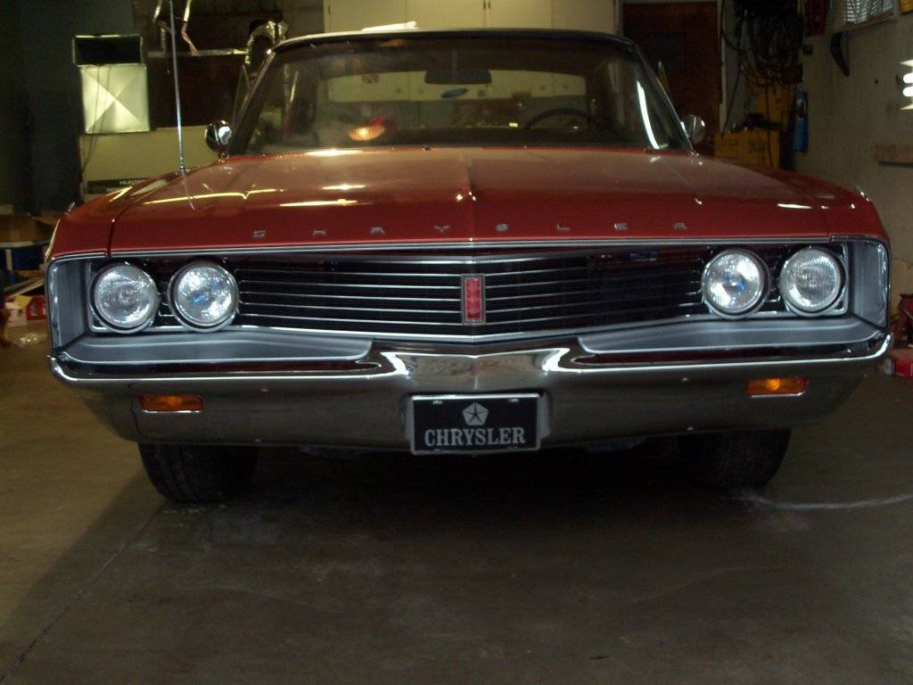

With the engine running she's got heart.
With her face back on she has soul..
Ladies and Gentleman..
Say Hi to the BoaB...

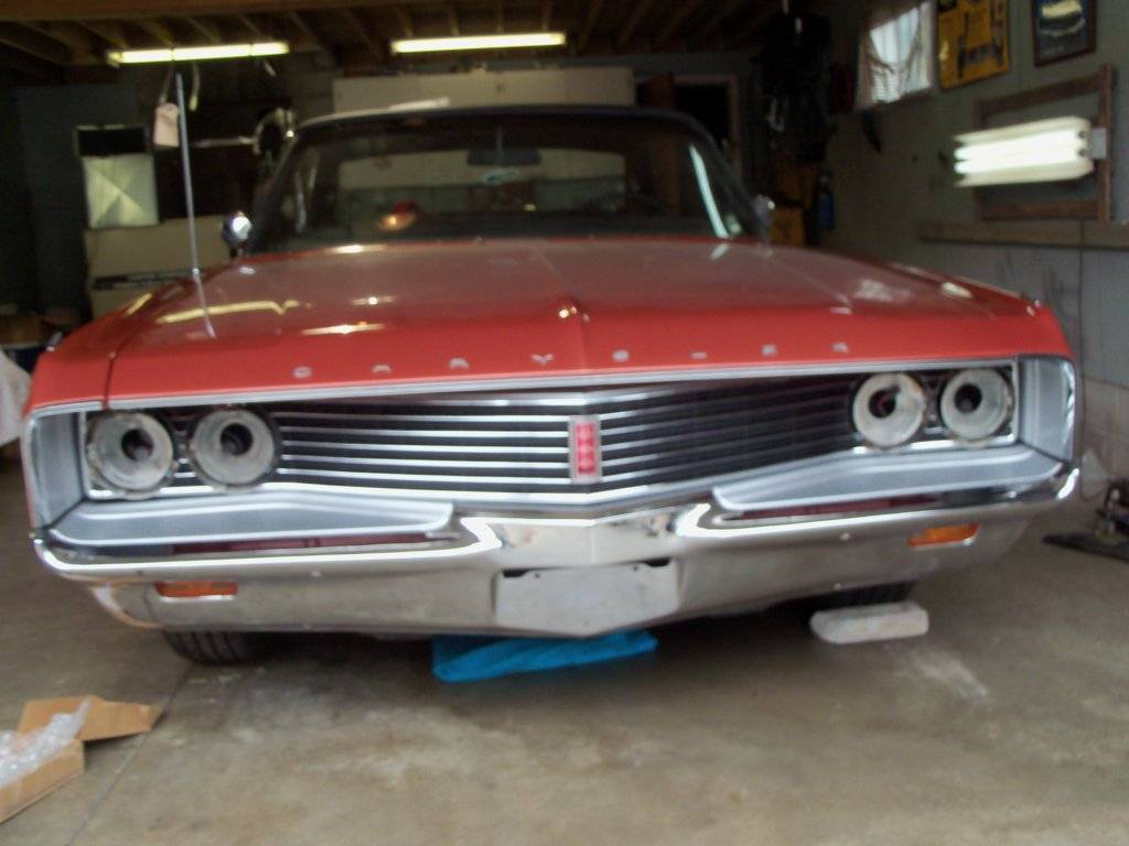

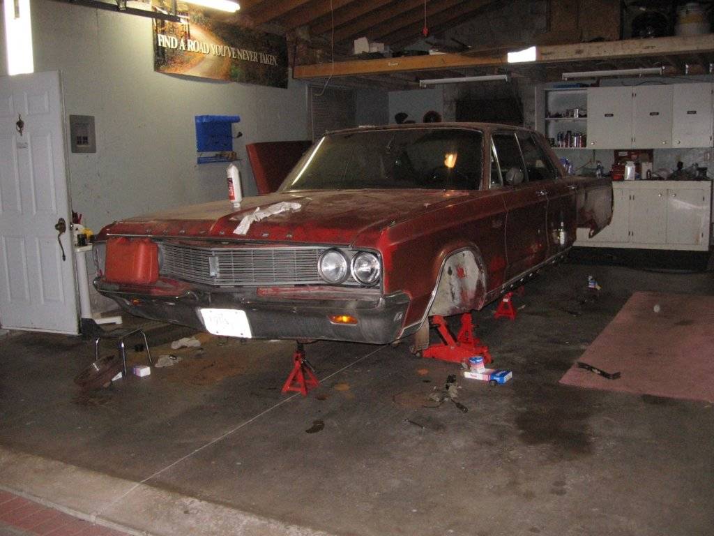

Found an old pic of the original toasted grille before I tore her apart.
I am glad I did the grille which I got from Chris Sherman
Thanks Chris!!

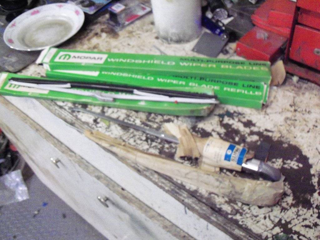

Almost finished,but yet still some trim to refinish and install.
Including NOS wiper arms,blades and refills!!
