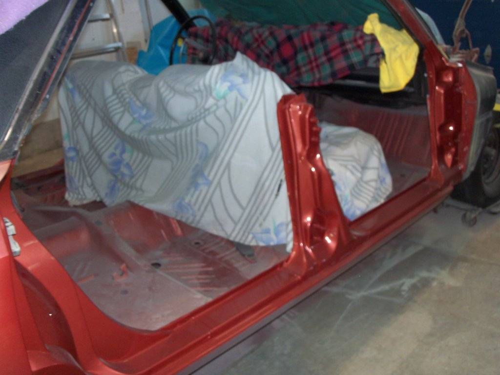

Door Jams in living color!!
Next os put her back to gether and ready for the big paint job!!
Really stoekd!! so much closer to getting doen I cant even spehll!!

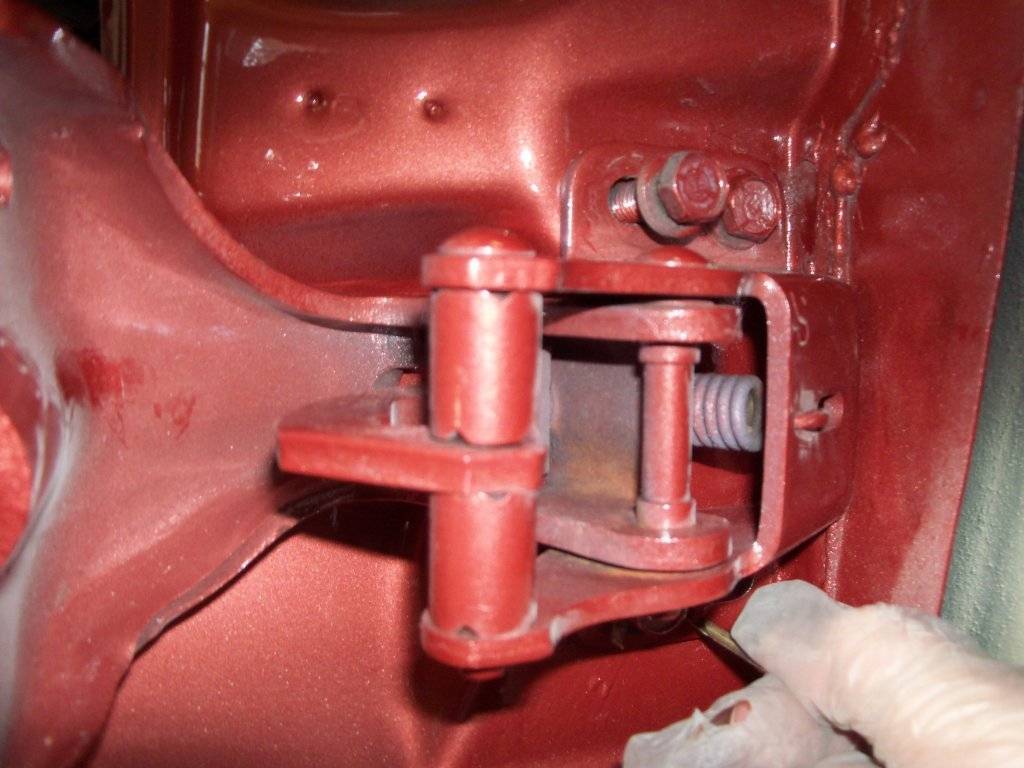

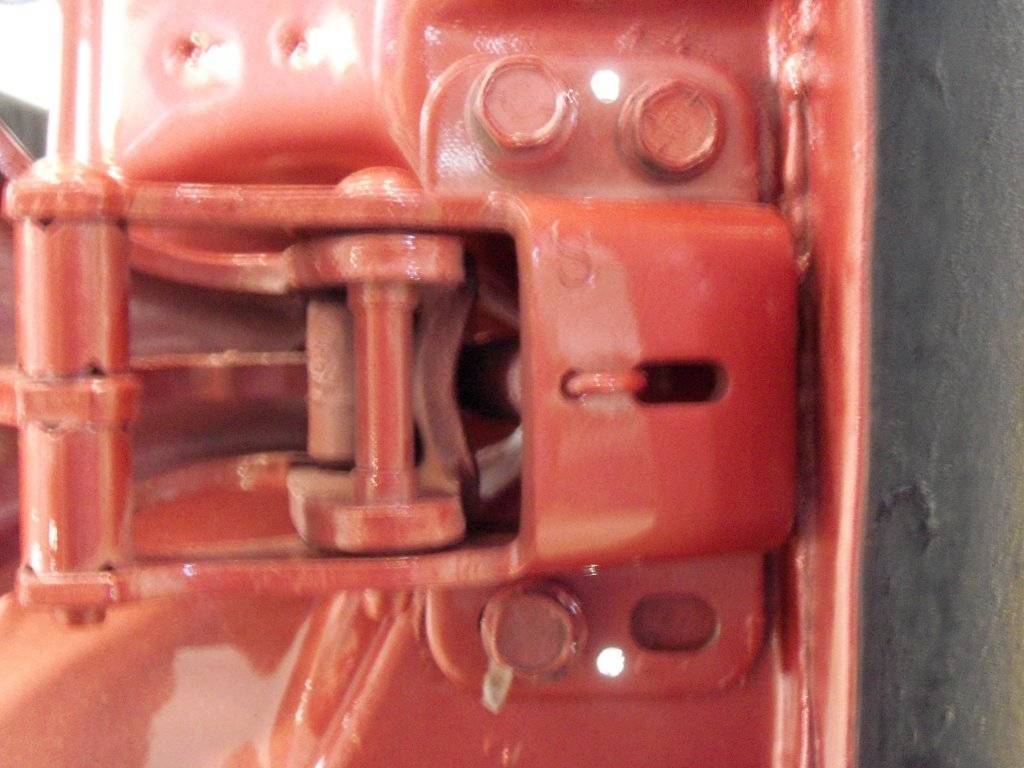

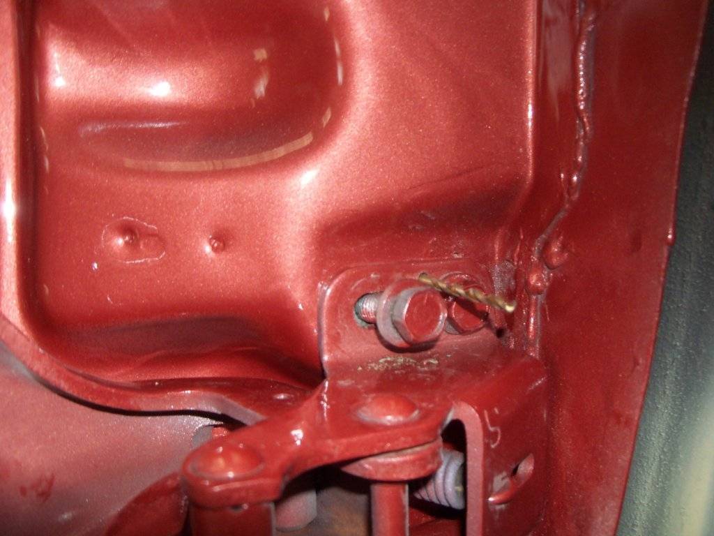

Hung the doors today.
I did drill the hinges prior to removal and made the re-install process much easier.
Using a flashlight and drill bit all lined up too easy

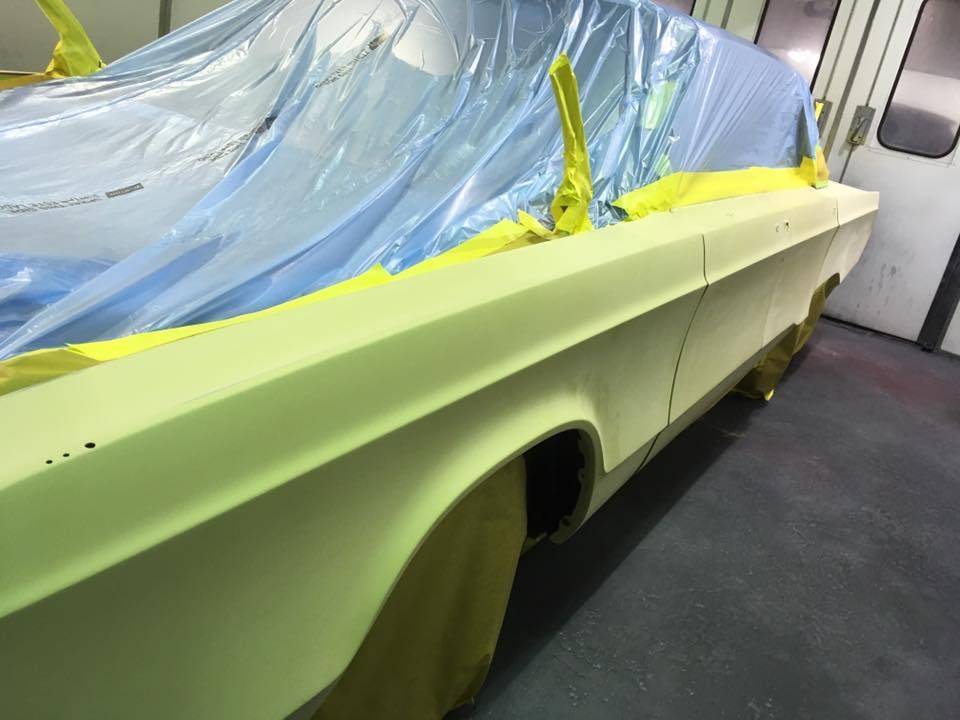

okay..She is back together for the ride into the paint booth.
Paint will happen Friday,then the final cut,polish,buff will happen right after that. She should be home in ten days!!
Pics from the paint booth in a week !!
