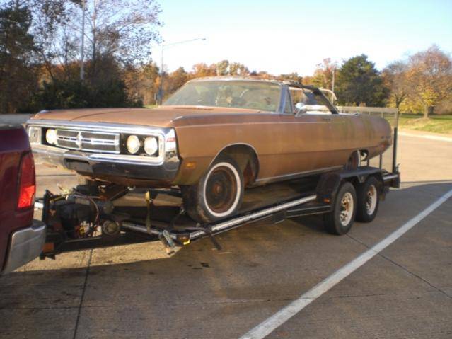

New Guy from Indiana with 69 300 Vert
Yea man, I know the pedals and Z bar are almost unobtainable but I will find them. I have most of the rest. If this carhad its original engine and trans I wouldnt think about it but it doesn't. I've had 4 speed B bodies and loved them. This will make this car the way I want it.]

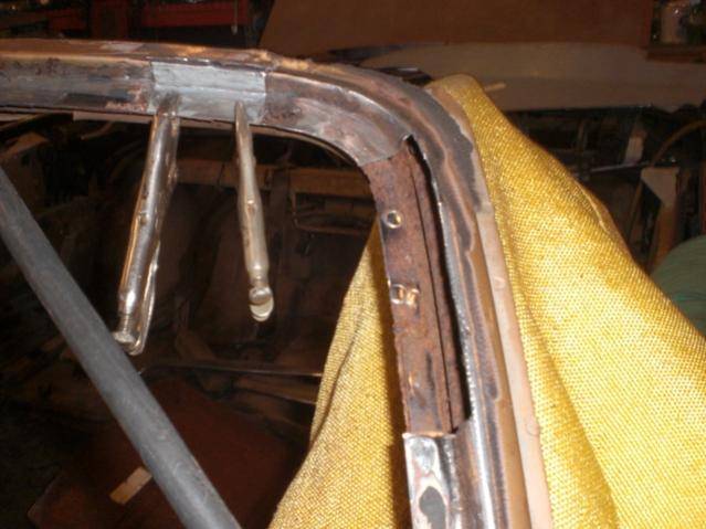

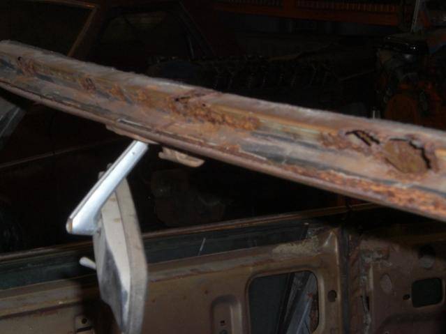

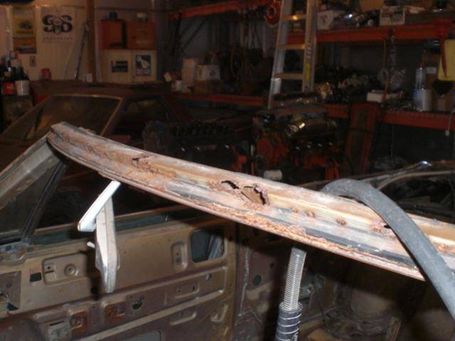

Well I finally got around to starting on the 300. The windshield frame was pretty rotten in places.
I thought this car was extremely solid but I was wrong about that. Its stillnot bad but besides the rear lower quarters and one of the rear floor pans having what I would consider minor rust the trunk floor was completely gone and someone screwed barn metal over top of it.

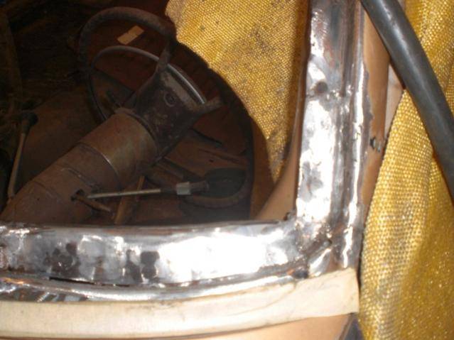

I have started on the windshield frame first.

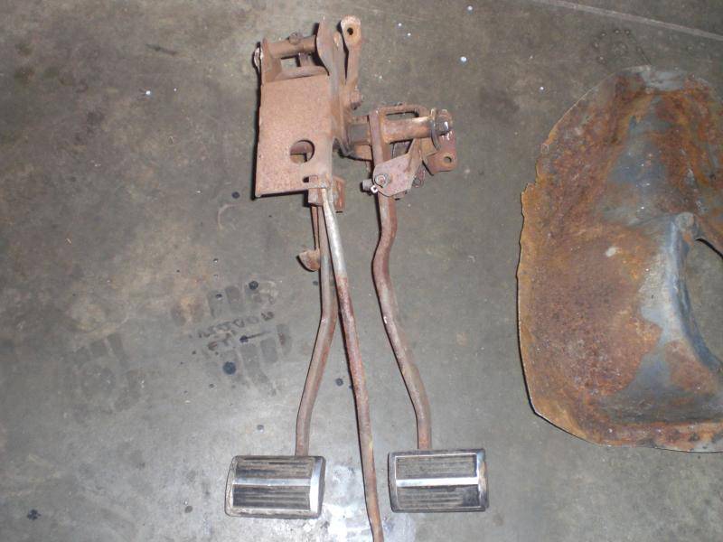

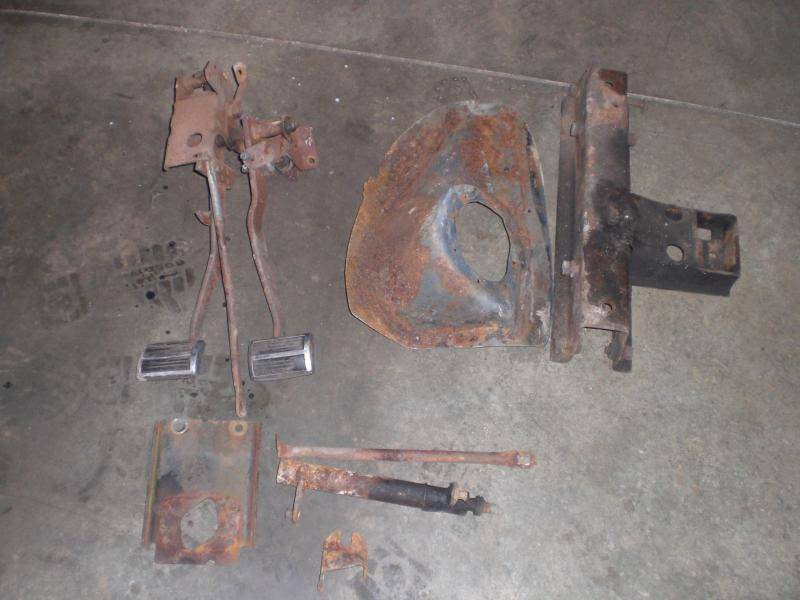

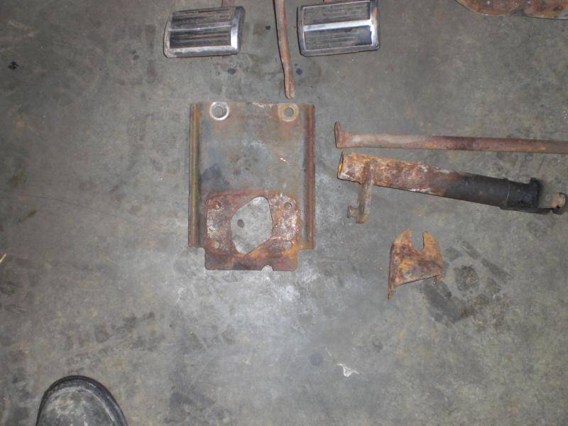

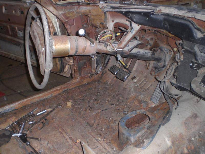

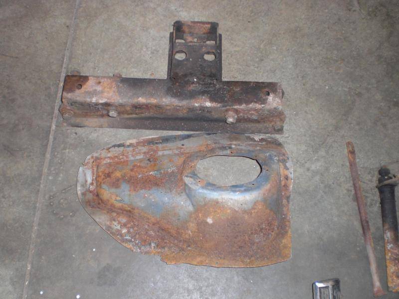

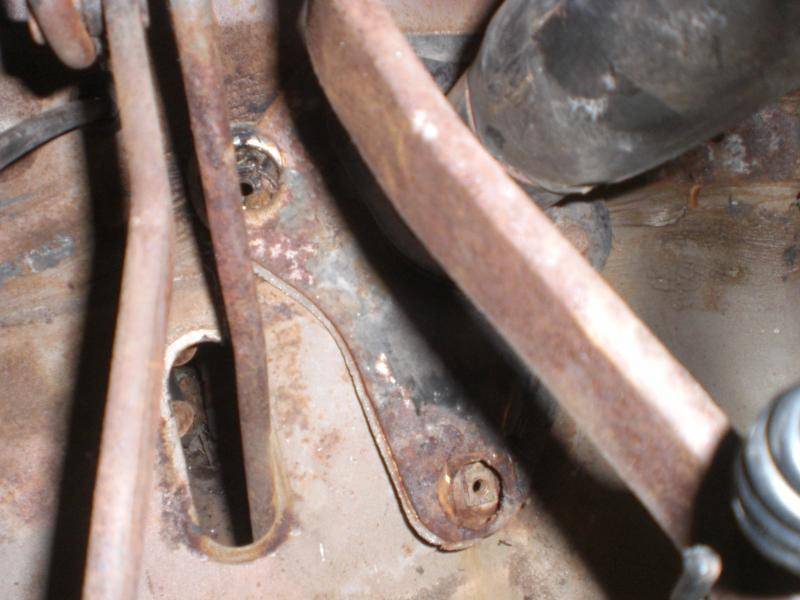

Picked up everything I needed for the four speed conversion.
Thanks to Clay and Clayton Kossuth of Catawissa, MO!

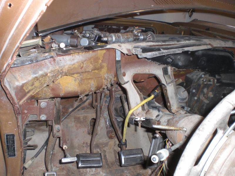

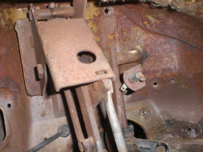

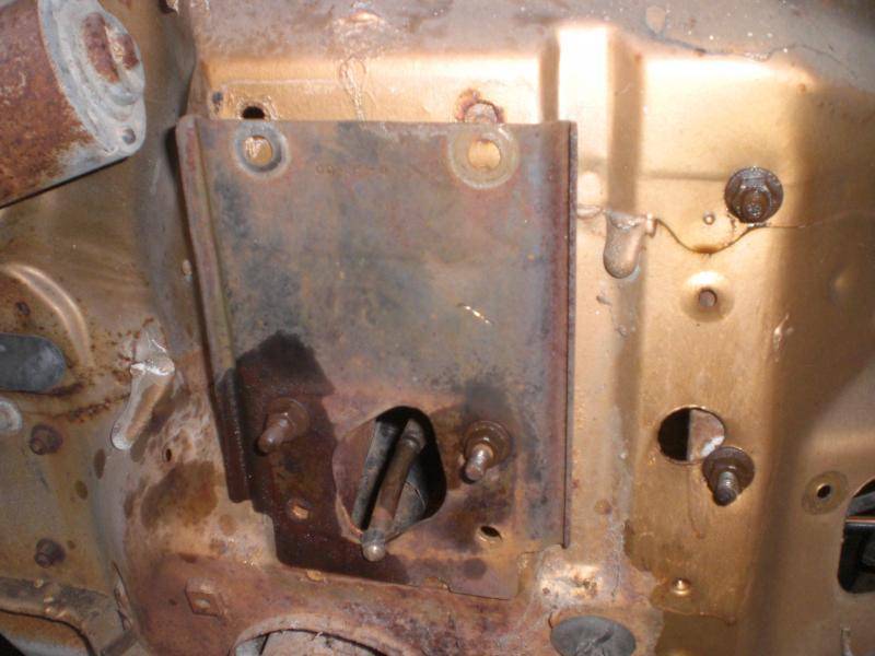

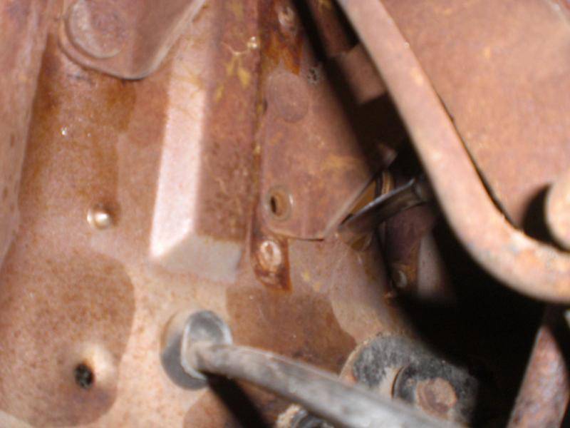

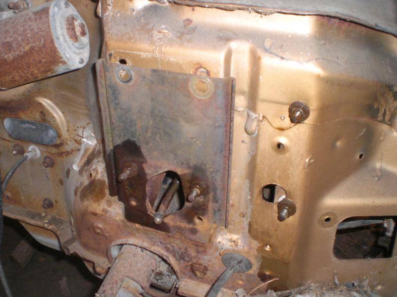

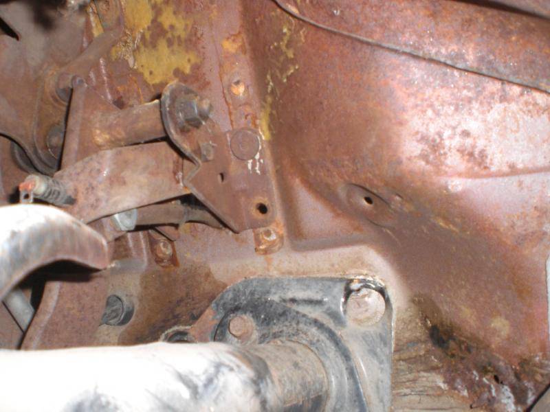

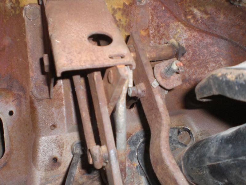

Its all from a 68 sport fury. I know the pedalsare not supposed to "fit"
the Fuselage body but I have done a mock up and I think the are going to work.
I wil be switching to manual disc and lose the power.
Ive been waiting for years to be able to watch how this is done on a Fusie. Thank you for the great pics.
How does that hump fit?
