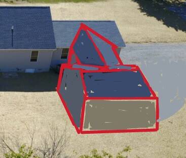

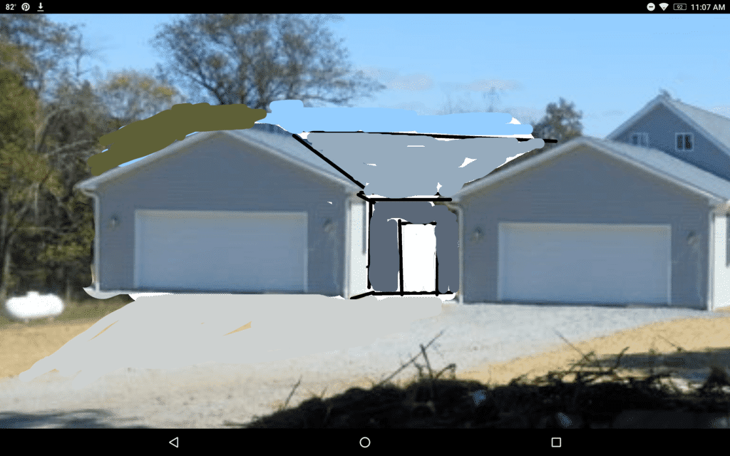

Build a breezeway.Key word is "secondary". That probably means free standing.
I'd build an attached second garage turned 90 deg. From the existing garage.
Bingo.Build a breezeway.

I think that is on top of the vent for the septic tank.
Make that garage another 20 ft. deep and another double door to the patio.I like it except it's not big enough.
The garage is more important. Move the vent....I think that is on top of the vent for the septic tank.
That's what erasers are for.I like it except it's not big enough.
Note to self: Always build the garage first.it is on top of the well, actually! The septic is in the back of the property. All good ideas and I will have to discuss with the code guy and maybe find out when/how often the zoning hearing board meets. What do you mean by councillor, Stan? Someone from the township, I assume?
This afternoon I was over and measured from the edge of the front of the garage along the driveway to the road....154'. i then measured from the same corner the shortest distance to the road (about a 35-40 deg angle from the driveway) and got 131'. I measured the shortest distance from the road to get to 131' at the place where the front of the garage would be, marked it and continued until I got to the corner of the concrete pad by the man door and it measured 164' so using the shortest distance from the house to the road, that gives me room for a 30' wide garage but opens the possibility of them saying no b/c of not enough distance between the garage and house or saying i cannot use the 131' measurement from the house to the road.

An attached garage isn't really an option either as I plan to make it a pole building. Stick built is abt 45K which is not a possibility for me, at least not anytime soon. Pole building is less than half that.
