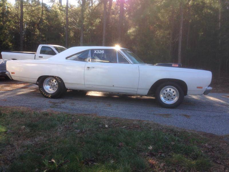

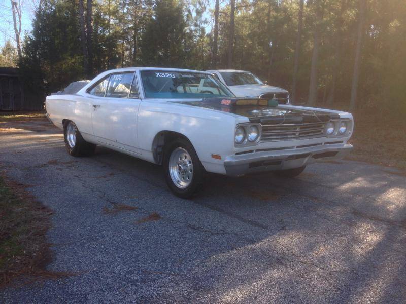

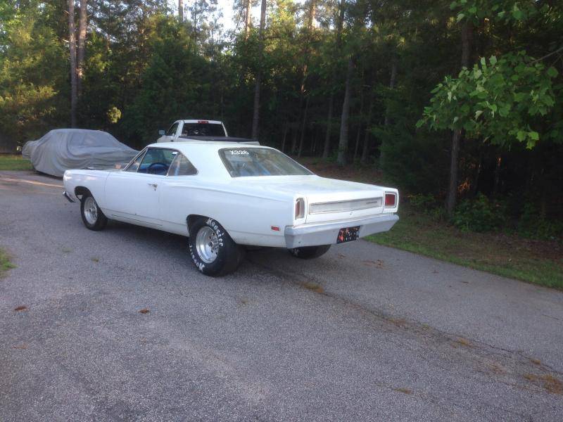

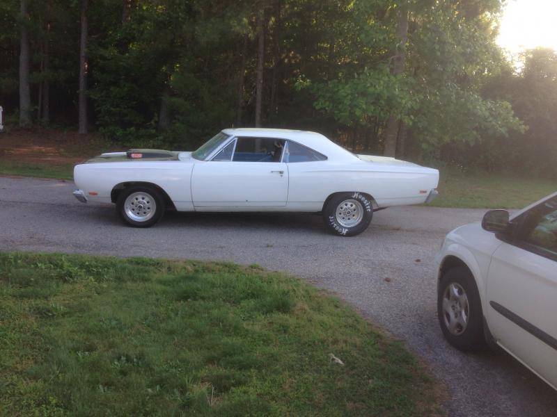

New look for the Satellite. I fought traction problems & tire rub problems all season. Looking at pics the car raised up in the air evenly front to rear. I think this was unloading the rear suspension. So I imstalled 2 inch lowering blocks, removed 1 short leaf on drivers side & 2 shorts on pass side. I also set the 3 way shocks to 50/50 (soft). In my driveway which has no traction. The car launches a bit violently now. Not a full on launch. Just 1200 rpm & a quick jab of the gas. It really lifts the left front & squated the right rear. My intent was to soften the rear cause my lil 318 didn't seem to have enough to load the SS springs. Before/after pics. I like it better raised up I just couldn't make it work.
I just hope this fixes it. It sucks to have a .009 reaction time & spin off the line. Trust me
