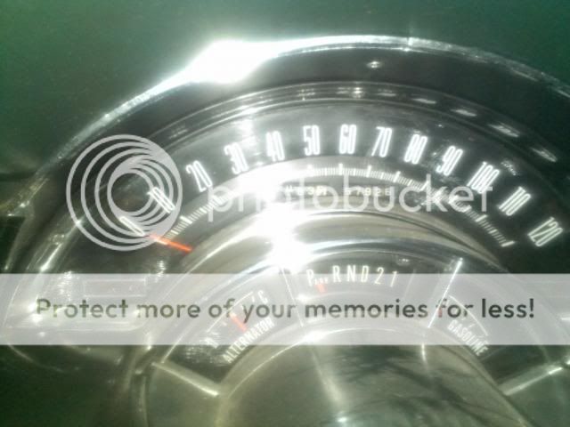

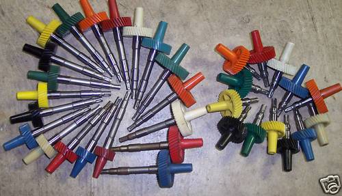

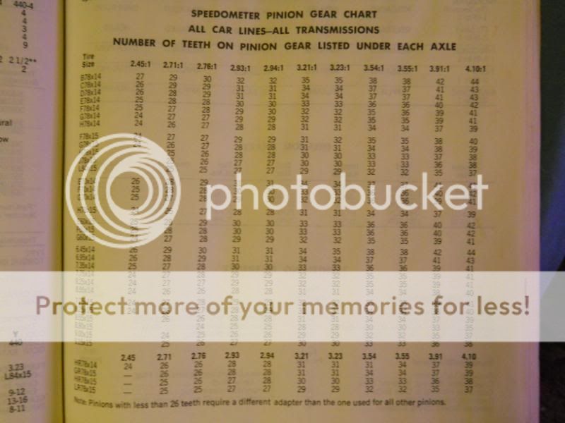

Tallhair, I bet you are right. When test driving I was at low speeds and it seemed accurate, but when I drove home and it said I was doing 100 mph and people were passing me I knew something was up. ;) The faster I go the more off it seems. I pulled over for gas downloaded a speedometer app on my phone and used that till I got a feel for it. At 70 mph it was roughly reading 100 mph. Being close to a MPH-KPH conversion just a coincidence haha! I don't really have a way to know if the gears were changed, I can say it does feel like acceleration is better than I expected out of an old school three speed auto so between the speedo and that I would bet anything you're right.
