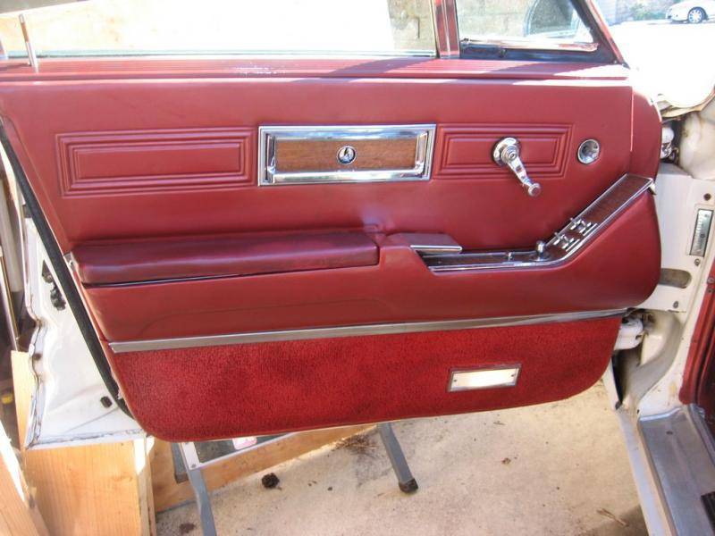

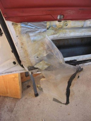

As part of dealing with my windows, of course, I'm pulling the door panels. I'm pretty happy with their condition. There's only one clip missing, and the fabric all seems intact. It needs some cleaning, but that will be easy to do with the panel removed.

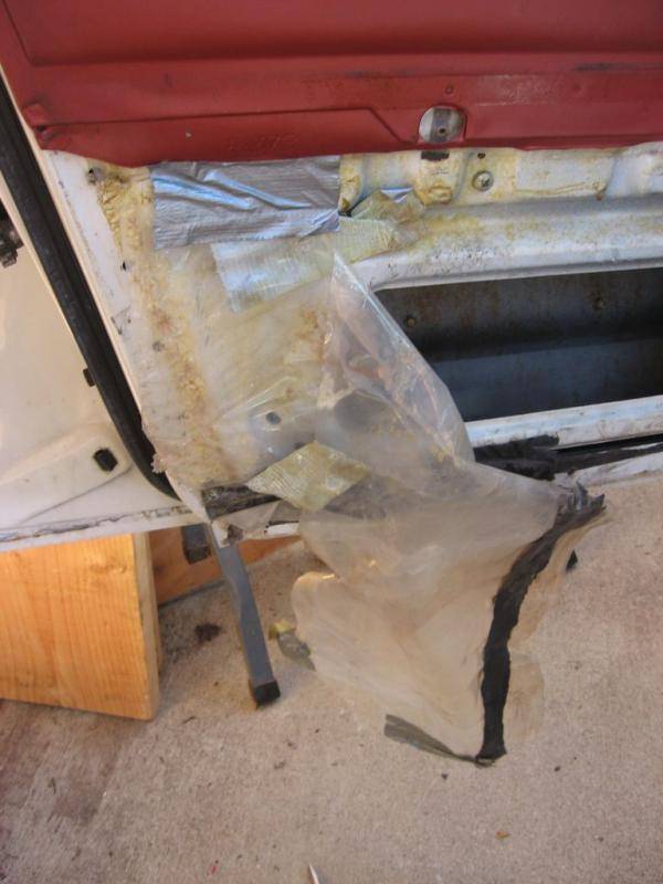

Someone has obviously been in there before, and thought duct tape was a really good way to keep the plastic on:

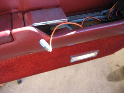

I found a courtesy light that didn't work, so I'll be going out and finding that bulb.

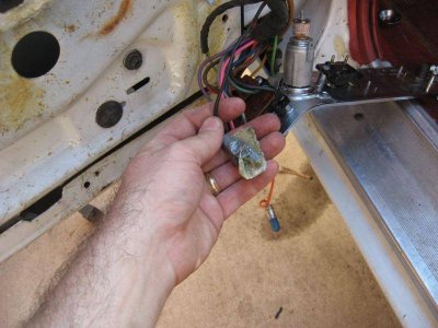

I also found out that the cigarette lighter didn't work. Maybe that's because the duct tape used to hold the wire in place had hardened over time and released it. The brown puck on the end of the lighter says something to the effect of: "this is a fuse, and if you want to reset, pull it and put it back." Do these go bad? Should I be sourcing a replacement?

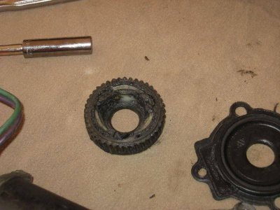

I had two choices: 1) take out the motor, or take out the motor and regulator together; and 2) use nylon bushings or 1/4-20 nuts. I decided to take out the motor and regulator together. I didn't really have a good visualization about where the bolts were to drill holes, and I wanted to see how it all went together before I tried an alternate. I also used 1/4-20 nuts, because I had a bunch in the garage, and I forgot to buy nylon bushes when I was at Home Depot.
I used the instructions on this thread:
http://www.forcbodiesonly.com/mopar...d-Chrysler-Power-Window-motor-clutch-assembly
I'll go back to that thread and add in some additional pictures of removing the regulator assembly, in case the next person like me wants to see how it's done.

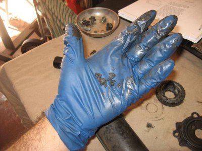

When I got in there, it was kind of weird: there was lots of grease, so someone had been in there, but the pucks were still totally disintegrated.
But it all went back together pretty easily. Or at least, the motor did. It was a real pain in the behind to get the motor and regulator back in to the door, past the forward window channel. Next time, I'm going to drill holes and pull the motor alone. I know where to lube now, and it will be way easier. Detmatt said it was a 20 minute job to R&R. I believe that. It's 20 minutes to remove and repair. Getting it back in was the hard part!

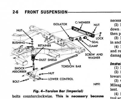

While it was up there, I took the opportunity to look at the mounting of the torsion bars. You can pretty clearly feel the torsion bar loose in the mounting. It's different on Imperials than it is on C-Bodies, there's a C-member there with an isolator. You can see the torsion bar, and move it by hand. I didn't have a chance to simply try tightening it. I don't know about parts availability. But it's encouraging that I've actually seen and touched the source of the clunk myself.

Dave, it's not the crossmember exactly. I just put up a post in the Suspension section, but I'll repeat some here. The "isolators" seem to be rubber, well, isolators designed to separate the mounting of the torsion bars from the stub frame. I'm guessing that it was Chrysler's way of making the Imperial drive a little smoother in the transition from body-on-frame to unit construction. FSM says C/Member and isolators can be removed separately from transmission crossmember.
