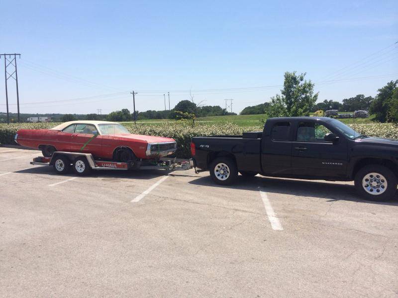

Little teaser. Car is loaded and left dallas this morning. Not too many pictures but lots of video to come. Try to update tonight from the hotel. Getting on the trailer was harder than expected. Three completely blown out tires!
cheers,
Sam
One thing's for sure: The rental Trailer is safe in rear end collision. Take care. ;)
Thanks! Yes this thing is a tight fit! If the front tires weren't flat I don't know how I'd have got it to fit. Then there's that other 6 feet of trunk hanging over! You are right that the trailer is safe in a rear end. That's a half a cars worth of overhang! Thanks for the wishes, 600 miles to go. Just stopped for gas in Barstow. Almost there!

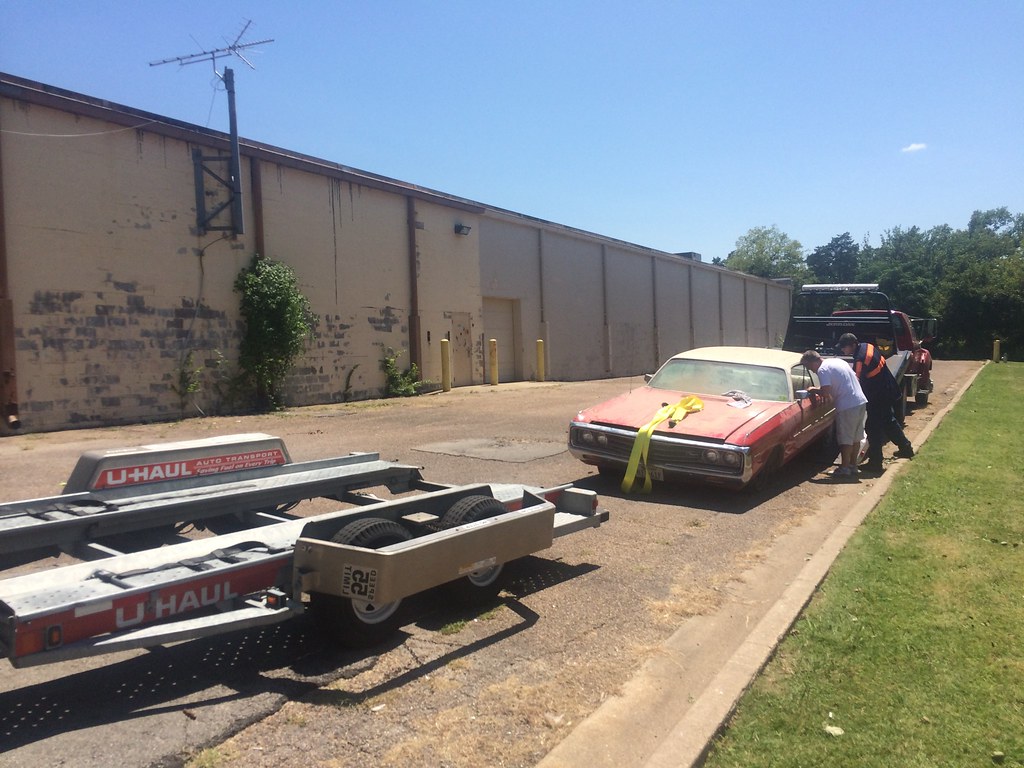

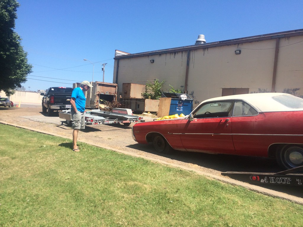

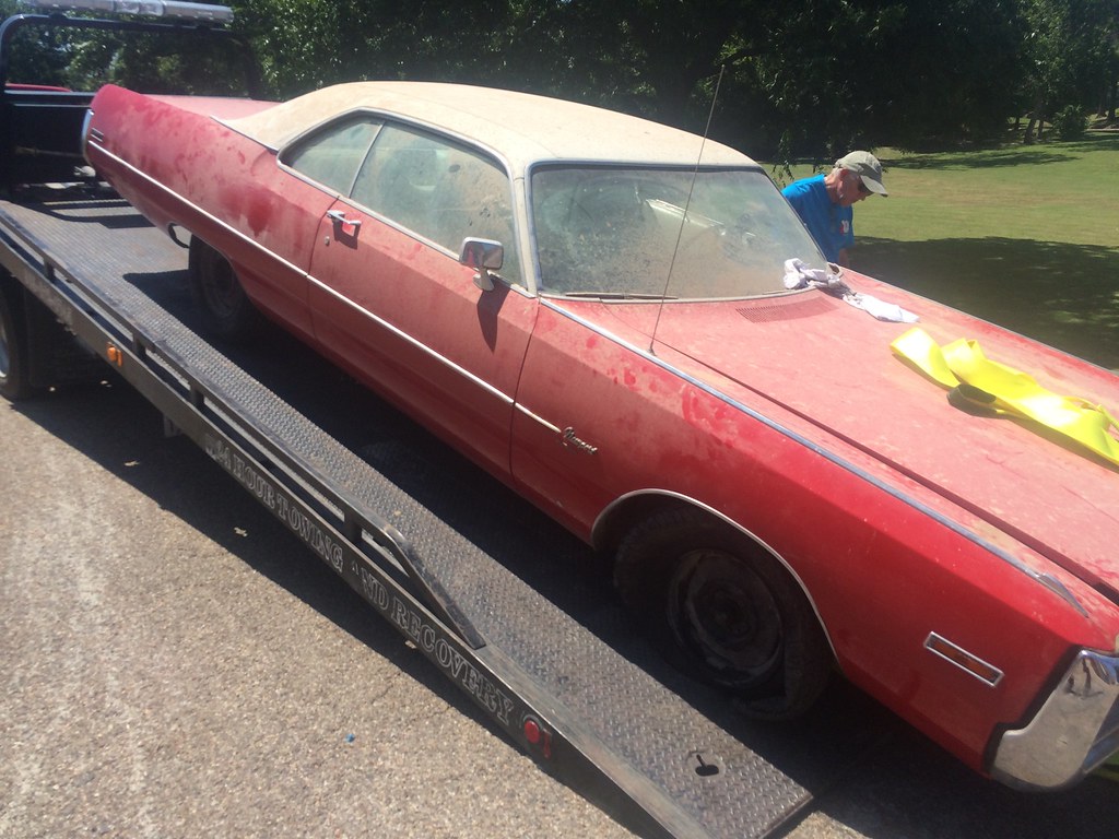

We picked up the car on Thursday morning. I planned for everything relative to 4 flat tires. However i didn't consider that three of the four flat tires were blown out/dry rotted. So my whole theory of using a come along onto a uhual trailer wasnt happening. I tried. But failed miserably. So called in a flat bed and had them dump it onto the trailer. Worked out so i just used the come along to pull it off the flatbed onto the trailer and we were good to go.
