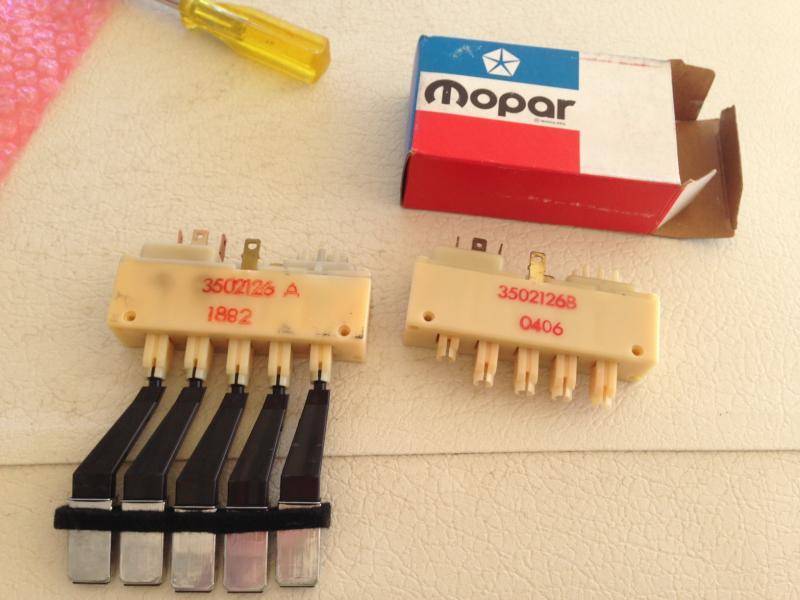

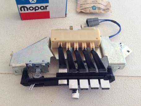

Thank you!!! It's a standard control, not autotemp. Any idea where I could get a wiring diagram for the A/C controls? My problem is the clutch power wire is hot all the time. I replaced the head end controls (vacuum switch and clutch switch) and still getting power at the clutch in the OFF position. So I have it disconnected for now. Everything else in the system works great though.
For some unknown and seemingly futile effort, Chrysler wired the a/c clutch on all the time for the 1973 C bodies. That means every time you start the engine, the a/c is operative. I believe I recall the reason was to avoid suddenly steaming the windows when heat was called for in the winter, yet there was excessive moisture in the evaporator. Running the a/c all the time of course took care of that problem, but created more problems than it was designed to solve it seems to me. The move meant a/c breakdowns probably very early in the life of the vehicle and poorer fuel economy than those smog engines already delivered. I have not looked into the best way to shut the compressor off, but certainly a toggle switch put in series with the a/c clutch wire should take care of the problem. I am not sure, but perhaps a different head control from a previous year would already contain the correct internal wiring (this assumes the control unit you replaced the original one with was the correct for 1973 part number). The wiring diagrams are most easily found in the service manual for the 1973 models.
Wow, thanks for the info. That's a bum deal they did it that way. Here the whole time I've been trying to diagnose it as a problem when it's been a "built in problem". Will get a wiring diagram and figure out a work-around before next summer!
