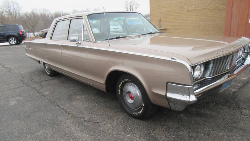

Thanks for pointing that out.. I thought that looked odd. Yes, dual exhaust is probably the only change that I will make to the car. I do want to make sure it looks correct, so I'm trying to find pictures of how that would look. Down turned tips?
Check with Waldron's for your dual exhaust system. I have their stainless steel system on my '66 300 convertible. It looks great, sounds great and fits correctly with the appropriate turn downs at the end of the tail pipes.
Another thing: In addition to dual exhaust, see if you can find and install a correct twin-snorkel air cleaner. That upgrade with the dual exhaust will bring your engine up to TNT specs: 365 HP instead of 350 HP.
