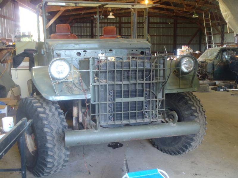

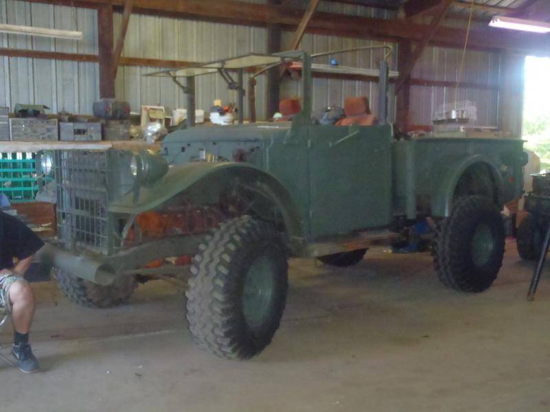

I definately like you fury more and more, and the M37 brings back memories of an ex Pacific Campaign WC51 Radio Dodge weapons carrier i restored many years ago.

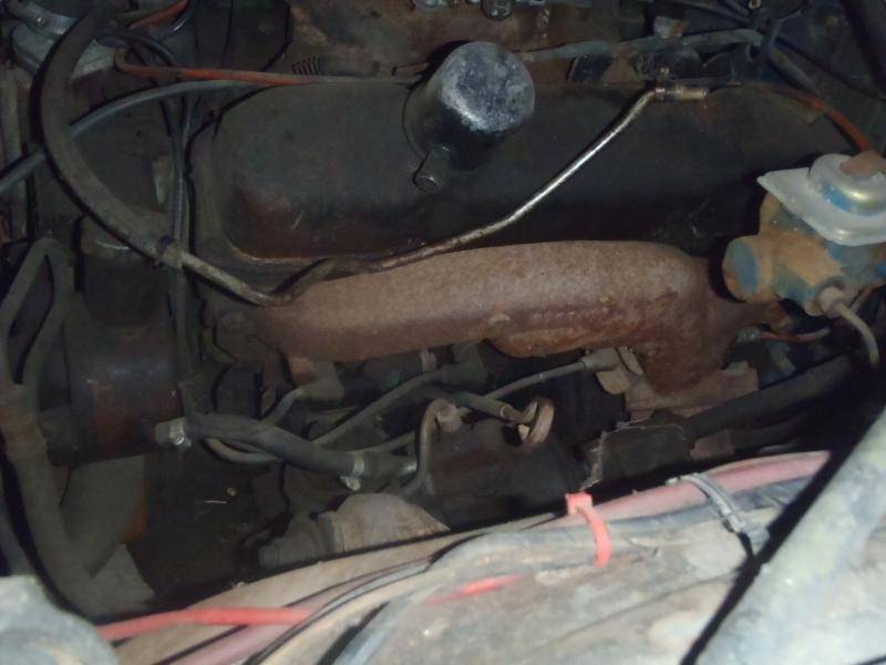

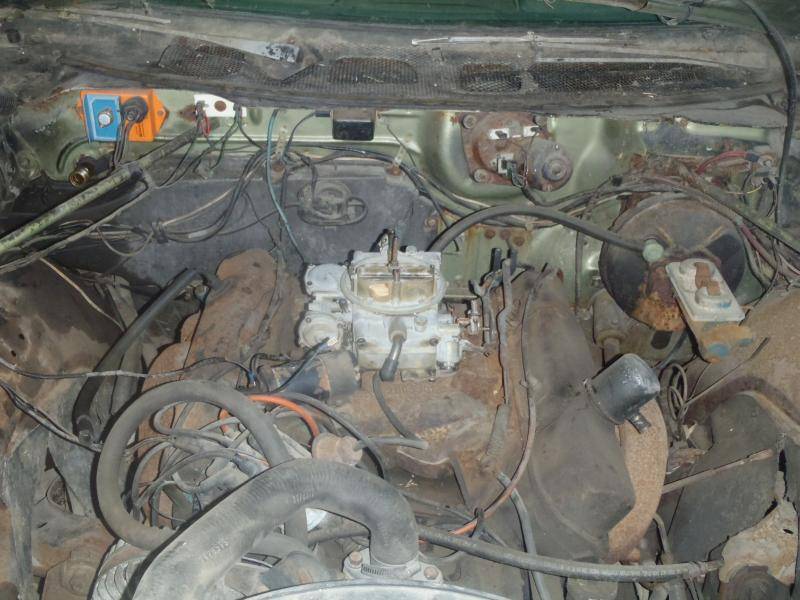

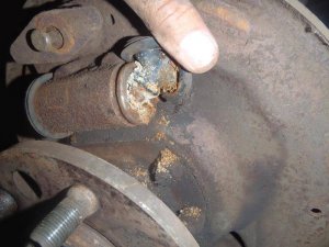

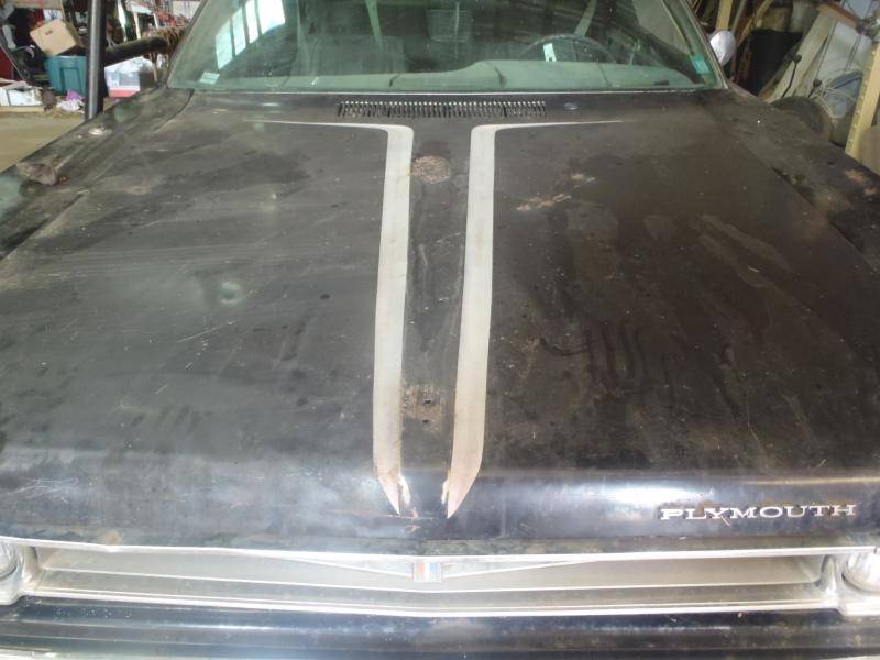

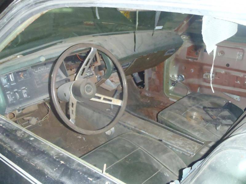

Well I said it was going to be a project. I believe the last time the brakes on the old fury were touched was around 1980. Too many years of neglect. I found out its got hp exhaust manifolds and the hd 727, so that's a plus. Surprisingly the trunk pan is in great shape with only minor surface rust, so looks like ill only need a front passenger side floor pan and a bunch of sandblasting. Ordering all new brakes for the rears including parking brake cables. It felt great to finally start work. :eek:ccasion14: I actually haven't had the pleasure of driving her much yet besides to the gas station a mile out (in 2005). Since then someone stole my brand new eldebrock right off the manifold (was never started on it)... Isn't life sweet. I picked up a used holley 4180 at the mopars in the park this year, only to find its missing a bunch of parts and probably not worth the effort. I've sourced a Holley 3130-2 750/780 cfm, anyone have any experience with this one?

That's a cool fury big block, hp manifolds, there are a lot of c body disc brake parts out there everything up to 73 fits don't use smaller car disc setups the spindle too short and too small the drum brakes are powerful just a little grabby and pulls a bit, go to gym lift weights no problem lol good luck.

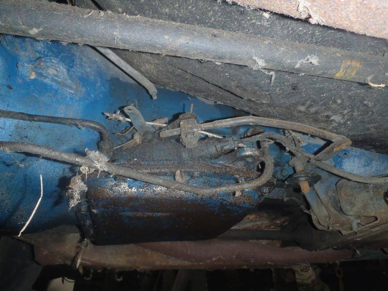

Is there supposed to be a circlip or something to hold that linkage in? I'd hate to be cruisin down the road and have that pop off again.
I'm looking at the side of your 727 right?
Not sure how helpful this photo is, I can take a better picture of how mine is attached, not sure if there's a difference in the kickdown and throttle on the BB cars versus the SB cars, I'll look in the Service manual aswell.
Nick
Yes Skaye there should be at least a split pin through the bottom of the kickdown arm coming down from the top of the motor, if you look closely you will see a hole through the side of the shaft at the bottom.
Thanks for the photo Nick. Do you have a sway bar on the fury III? I just noticed mine does and if its a sport fury option I may have an extra one for ya (gotta check). My grandfather has always praised how this sport fury handled for a boat. I however, have not had the chance to decide for myself. You have a great lookin motor and trans. I'm not trying to push my parts on ya, just trying to help a c-body brotha out. Thanks for the info wollfen, I'll check it out.
