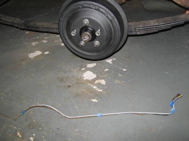

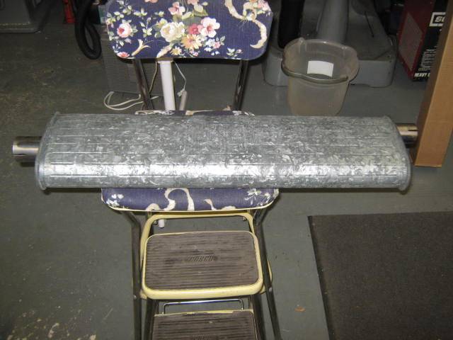

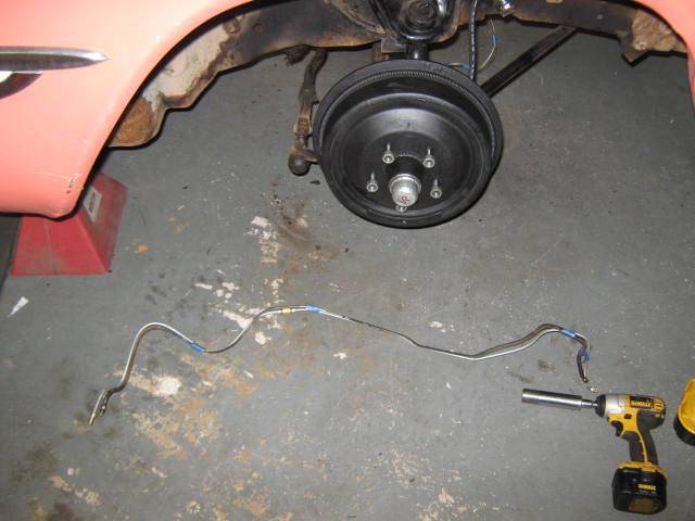

The brake lines came in a day late so I got busy bending them using the old ones as patterns. The brake assemblies and drums are all mounted and pre-adjusted. Tomorrow I'll install the new brake lines and bleed the system. Also, FEDEX delivered a NOS '57 Desoto muffler which will be going on in the not too distant future.

How old is that stool? Did that come with the DeSoto?
I think the stool came into our household about 50 years ago. So it is a little younger than the '57.
Finished installing the new brake lines and bled the system. All is good so-far. Good solid pedal and the brakes engage and release properly. After a few more under the car chores, I'll take if off the jack stands and go for a "first time" test drive.
