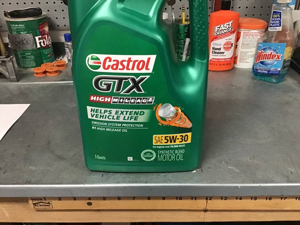

Could someone tell me if this oil is ok for my change ? Is the 5w to thin ? I normally use 10w 30w.
No. That oil is for roller cams in modern engines. You need a high zinc oil. Find some Lucas Hot Rod Muscle car oil. I am not saying to use Lucas exclusively, just saying this is the type of oil you need for old flat tappet cam engines.
I use Lucas in clients cars as it is pretty easy to purchase up here. For my personal cars and clients that want it I have Brad Penn/Penn grade high zinc oil.
I use Brad Penn, now PennGrade oil myself. My preference is 15-40 with a good Wix filter.
That said, you ask 10 different guys here and you might get 10 different answers. The main thing is to use a high zinc oil to protect the cam and lifters.
