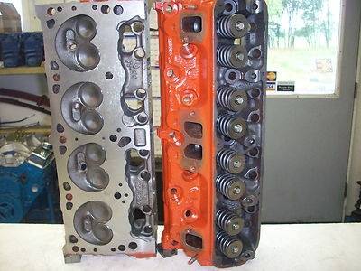

Current bid $635. description from eBay ad:
Mopar 318ci Heads. High swirl, and velocity ports!! 4323302 casting heads, will fit 318-340-360ci. engines
Heads were hot tanked, and magnafluxed.
Large 1.88nt. valves and 1.60exh. valves.
Mopar performance valve springs, 90# seat pressure and 260# @.500 lift, .520max valve lift on the springs.
All new exhaust bronze guides, intake guides checked good, all new valve seals.
Heads then received a full competition Wetflow valve job, with Mondello technology cutters, All New valves installed, Bowl area under the valves was relieved for the bigger valves, with a 75 degree cutter for great flow. Then heads were milled .005 to clean up deck surfaces. Heads are 55cc chambers.
Heads are ready for bolt on, all treads are in great shape no cracks or helicoils. A very nice clean set of "302" heads that would be a huge upgrade for your 318 engine, or use on your 360 to boost your compression and increase your airflow! These heads should make a easy 325hp with on a street engine and close to 400hp on a 360ci! Shipping is for both heads, thanks for looking!

RJ, throwing a lot of money into the heads of a 318 lugging around a C-body is really bad economics.
Sending your stock heads out for a good valve job is far wiser and cheaper.
You will never feel the difference in the real world over rebuilding your stock heads and spending way more for hi-po heads.
FWIW, my numbers above are talking stock (62cc) 302 Swirl heads. The heads in that ad have been modified with an even smaller combustion chamber. (Meaning higher compression)
My small amount of engine knowledge is saying you are going to have way high compression with these.

I get the feeling these heads are a bit too upgraded for your build. As for a valve job, I'd reckon about $200-$700 depending on what all they are doing.

FWIW I would have to agree with Stan face to face/ even better is someone who speaks mopar. The heads you have are not horrible like mid-70 thru early 80s. The 302s are good if you get a set cheap I would not spend a lot on them better to go with 308s but not on 318. I would redo yours and if you want to spend a bit add 360 valves to them as long as they cut the bowl , of course this is all useless if staying with 2 bbl and exhaust manifolds then just redo them stock.
Seeing what stan posted on the seller that would be enough to scare me away unless this guy is down the road from you shipping will kill you. Not a big fan of ebay to many bad stories seems like people fishing for big numbers on there junk without having to listen to people telling them they have junk.
