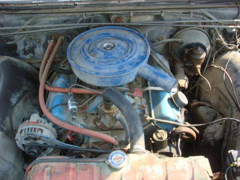

Before:

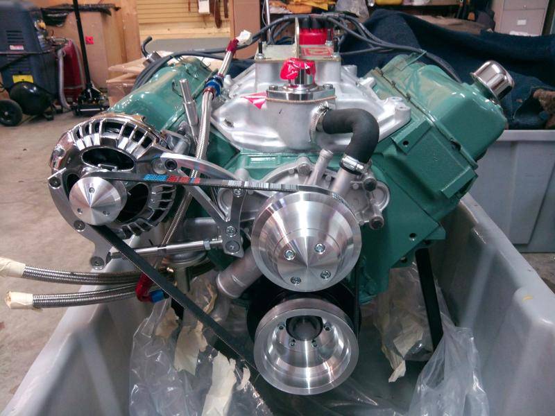

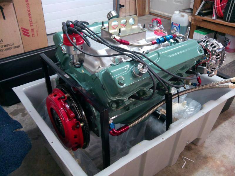

After:

At least the distributor is in the right place now....
Funny looking harmonic damper, though.
Any pics of it installed yet? Curious about the remote oil filter. Looks fantastic, I have zero hate for small blocks.
No pics yet. The K member is stripped and going for powder coat next week. Body is in the shop getting the kinks out and firewall painted before it comes home for the install. New front end on the way from Firm Feel. I was so naive thinking it would be on the road this year.
