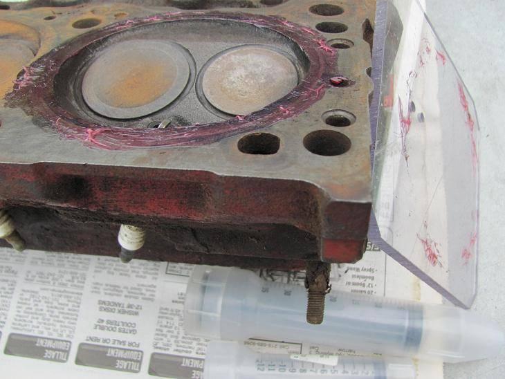

I have a pair of '68 318 heads and some 360 LA heads. If you care to make it interesting I can check the CCs in both and see if they will change your compression nearly a full point as you have claimed... :poke:

A '68 318 has open chamber heads... little if any difference in volume, (OK the actual numbers after checking CCs myself are 66 for the 318 and 70 for the 360 915s) they also have smaller valves, 1.50/1.78 vs 1.60/1.88, don't have hardened seats and have much smaller ports....
I have checked the heads and they are 4CCs different... So I used the 3.91 bore, 3.31 stroke, the 66CC chamber volume, .039" gasket thickness and .027" deck with flat-tops to get 9.25:1 compression, as advertized for a '68 318.
When you add the 4CC increase for the 360 chambers you get 8.85:1.... That is 4 tenths, hardly a full point... Maybe some idiots can do some actual math before they get mouthy next time
