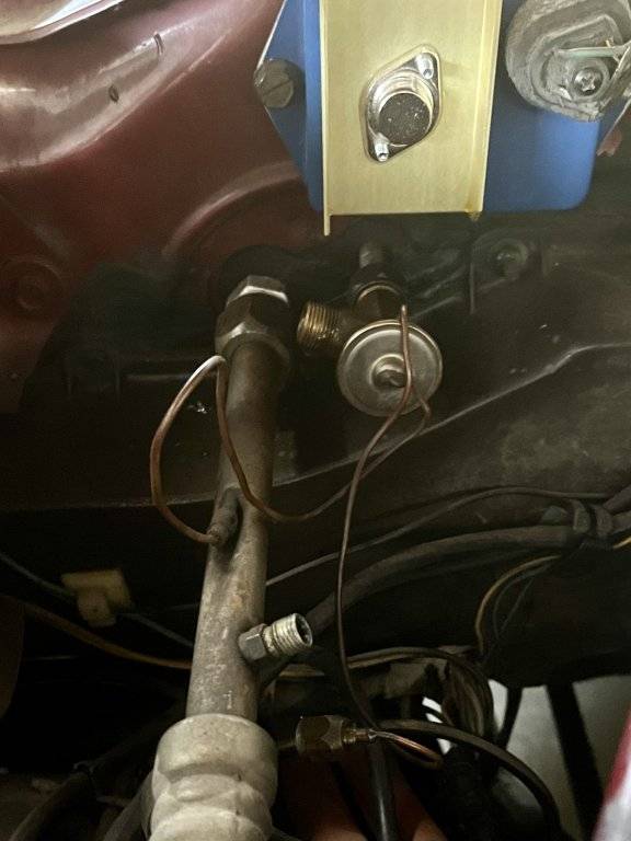

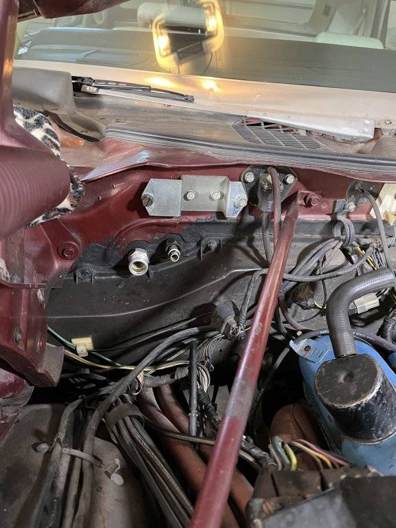

For comparison, here’s my 73 Imperial with a single expansion valve - no rear AC system. The liquid line is removed because I’m also in the middle of trying to resurrect the ATC II system.
Also for what it’s worth - I had a hell of a time getting the EV off. Used about half a can of PB blaster in repeated shots over a couple days, no dice. Finally tried a different spray called Knocker Loose and maybe it was happenstance but it came right off about 5 minutes after first spray albeit with a lot of groaning. Used 2 wrenches and was careful not to torque the firewall connection.
To clarify - you DO want to torque the fitting SLEEVE coming from the firewall connection (ie, you want to turn the sleeve rather than trying to just turning the expansion valve that fits into the sleeve) but not twist/bend the pipe. I've heard that you need to be extra careful with EV removal because messing up that connection/pipe is a good way to wreck your evaporator.
