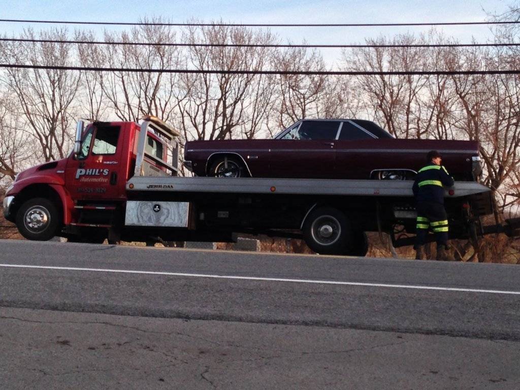

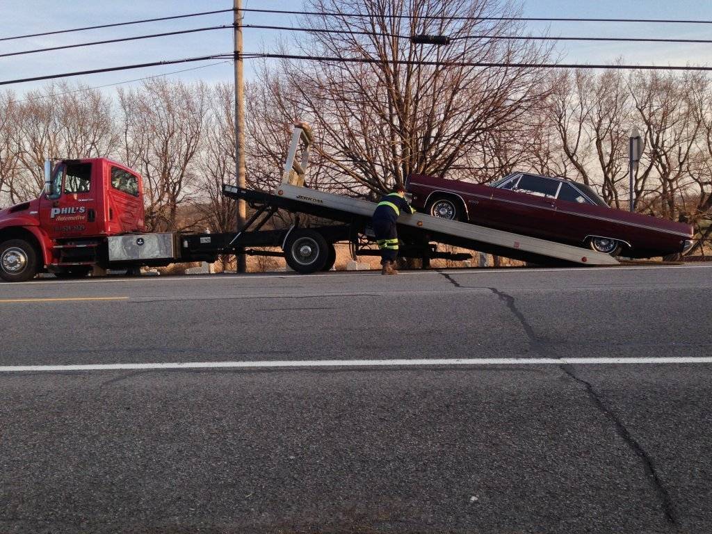

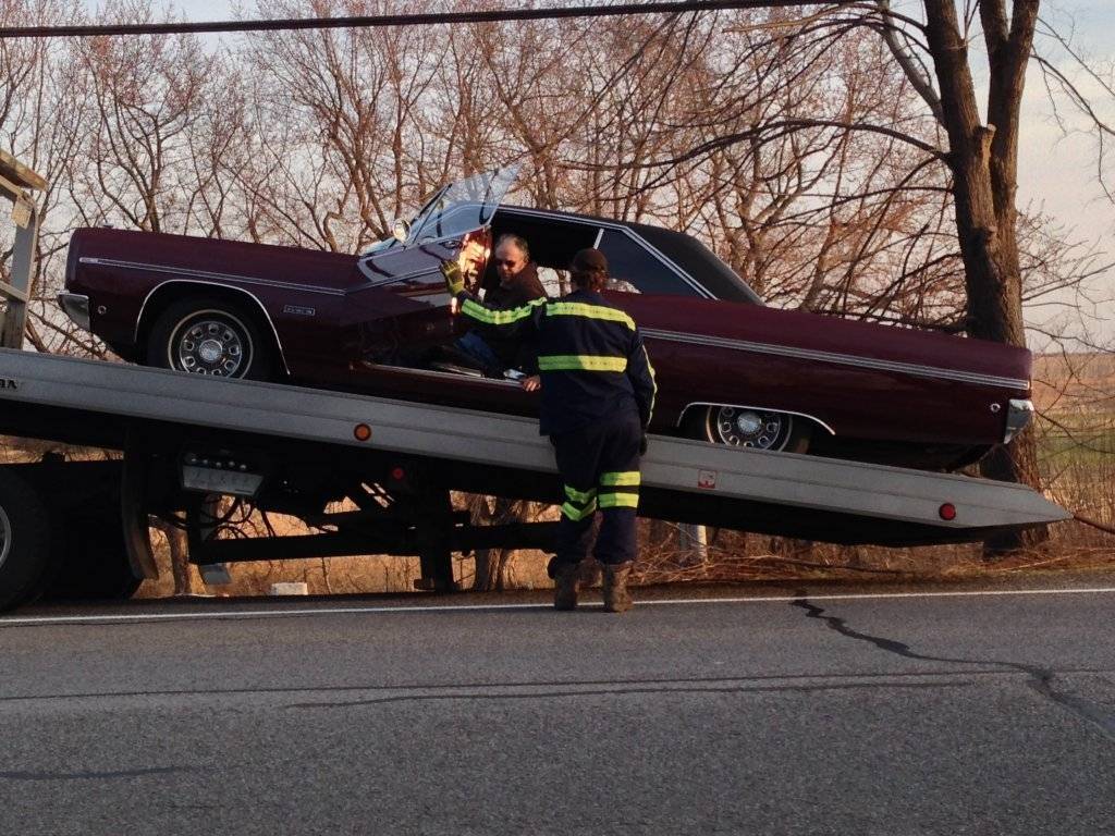

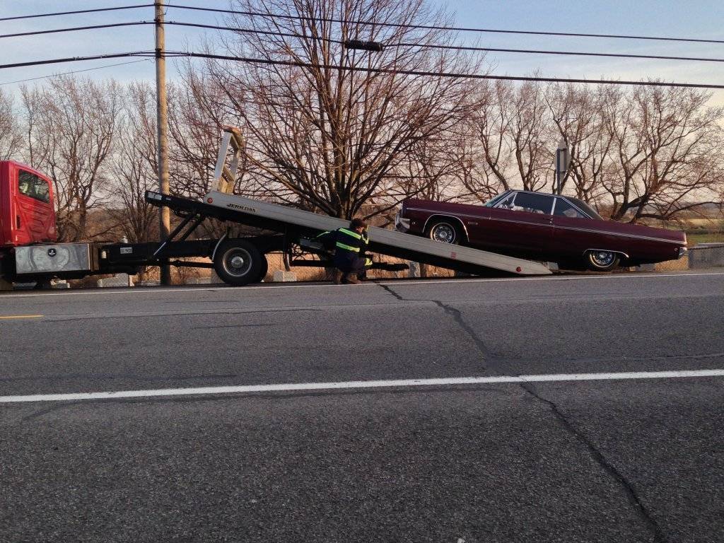

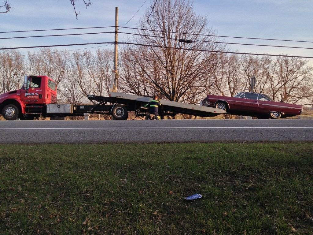

It was 70 degrees here yesterday. I had taken the car out for a short run the day before and all seemed fine. After checking all the fluids, I decided we'd take the car for ~30 mile round trip drive to visit my wife's mom in the nursing home for Easter Sunday. On the way down, all seemed fine except for a vibration in the steering wheel at 35-45 mph. Thought to myself "wheels up front must need balancing" no big deal. After our visit we set out to return home. Right after after releasing e-brake in parking lot I knew something was wrong...car did not roll well. I backed up slammed on the brakes...moved around a little in the lot...and the car rolled a little better. I decided to set out for home...taking the country roads where I could stop and feel the backside of drums a few times. I did so and they were warm but not hot. As I got about 1/2 way home I got a whiff of hot brake shoes and it seemed like I was having to give it a lot of gas to get the car going. I stopped and checked the drums again...all 4 were hot but certainly not untouchable. I tried to move car and it wouldn't budge so I had my wife call AAA to get it home. The guy did a nice job of "scooping up" the front end so he didn't have to drag it far and actually, I didn't see any one wheel drag as he pulled the car up onto the flatbed. He used straps to winch the car up and also to secure it, so all in all I was pleased. We hopped in cab and he drove us home. When we got home, I drove the car in the garage and it seemed to roll well. Hmmm. I'll have to dig into it this week. Perhaps the e-brake cables are hung up? Maybe all 4 brakes are adjusted too tight? So our first real trip in the car didn't go too well but still we were thankful for AAA, getting home safely and without any damage to the car.
