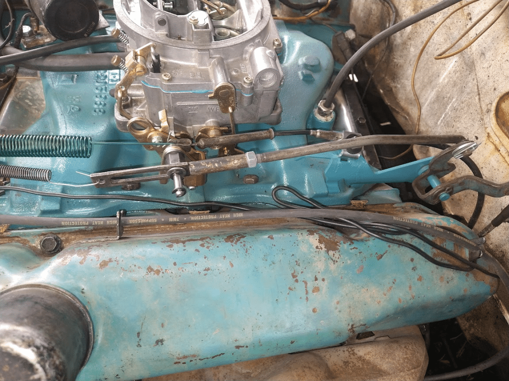

It looks great! Just one small thing , flip your throttle return spring around. The long hook end goes to the throttle cable yoke . This is to prevent the spring from catching on any linkage at WOT . I agree with you not needing the new cables , go enjoy your car .
I had the throttle cable in w the long hook to the yoke, but it was snagging too. Now, I need to focus on the timing and distributor. While it distributes decent spark, my vac advance is sending it into misfire mode. I plan to get the vacuum gauge and optimize on that. I saw today its back to pulling about 17" Hg @ 650 rpm idle off the manifold, which is what it pulled when we first got it nearly 7 yrs ago. I have it timed at the canonical 12.5 degrees BTDC right now, but may retard it a couple if that will get it to play nice w the vac advance. It bump starts w the vac attached, which is GREAT, but then misfires as soon as it gets any throttle. Ported vac works well too, sooo I figure I need to use the vac and timing light, w a prayer or 2 to hit that sweet spot. I mark the distributor clamp and distributor tower w a Sharpie when I find that, then am good for so long as my marks last usually.....

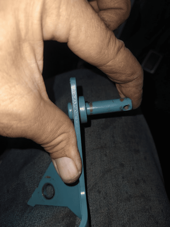

now can be told. After painting the 4 barrel throttle bracket to match the same turquoise the rest of the new heads and intake, I mounted it this afternoon, then tried to get the kickdown to work again. Nothing doing! Does the 4 barrel bracket seem to sit LOWER than the old 2 barrel one? It does! Does the bellcrank seem CROOKED? It was, too much to function, likely, BUT
despite my effort to impose better geometric integrity to the point where the rod ends in the crank, nothing would apply the pressure required for the kickdown to activate, despite the relative EASE which I enjoyed with the old, bent bracket! The Showstopper lies in the crank pin on the new bracket, fresh from the SOOOOO Reputable Mancini:
See how much dark shows between the pin retaining bushing and the bracket? This didn't show until I tried the bracket in a half mile drive. The pin IS SO LOOSE IT SPINS WITH A LITTLE FINGER TWISTING! It also WOBBLES, as clearly shows in the pics above. This bracket can NEVER deliver sufficient pressure to the transmission kickdown with such a gross defect! Had this showed on unpacking the bracket, I nver would have wasted expensive, hard to get Early Mopar Big Block turquoise engine paint on the useless paperweight. Nor would I have shucked out the lucre to Mancini.
I'll be telephoning those people tomorrow, sharing my thoughts on their Quality Control and money that could have bought some shoes for my wee daughters instead of this gew-gaw.
Upon restoring the 56 yr old 2 barrel bracket, the kickdown resumed working very well. Think I'll keep it. Notice the new throttle return spring? It has a bit more snap to it than the 54 yr old one that came w the Carter BBD setup on Gertrude's original engine. That one works, but will serve better with another 2 barrel Carter methinks....

Broken spot weld, or just simply needs to be spot welded, easy.
Yes, easy to FIX, but the necessity of doing so w a brand new purchased product galls. A BETTER way would be to press it into a tighter bushing. Since Mancini instructs those who buy this bracket to remove the pin for manual transmissions, I suspect they just pressed it in, though my guess has no factual basis at all in their case.

Pressing the shaft in, with an arbor presss, would be adequate if the interference fit was sufficient, aka BFH fit, a very tight fit, but here, you're suffering from shrinkage of the shaft, which is not a good thing, they don't even make a pill for that yet.
The quick fix, fire up the Miller and throw a couple spotwelds on there, which is probably what a Chrysler robot did way back when.
