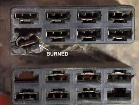

My latest challenge is that once I got all of the AC stuff installed I wanted to pull the old girl outside. Slide behind the wheel put the key in the ignition and as soon as turn it. One loud click and no power inside - nothing, no dome light, headlights...
I've got power to the firewall. I pulled the bulkhead connector and I have power on J. Looking at the wiring diagram power goes to a circuit breaker for the accessories (kind of on the side) and then to the ammeter. It doesn't look like the circuit breaker could be the problem so, do I dig into the ammeter this afternoon?
Thanks for any guidance.
