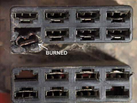

Sometime ...,,, Well maybe a tad more than sometimes the main power connection at the bulkhead connection will be / get corroded if not have an outright melt down. you can have power to one side but not the other. just a good thing to check out !!
I've checked mine. No signs of corrosion or heat. It's been cleaned and had a liberal amount of De-oxit applied to it.
