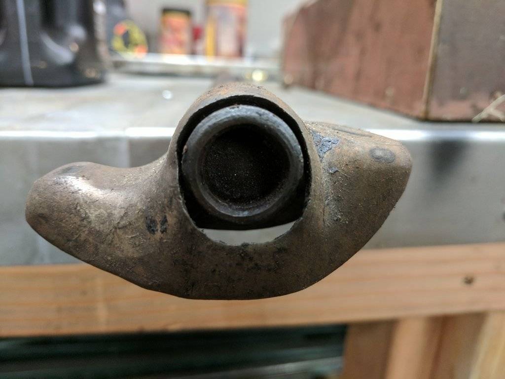

My valve-train seems noisy, I have not opened up my valve cover to take a look but I have a pic of a set I have laying around. My assumption is that this is worn out, as to how oval it is. When I look at my rockers on the engine and if I find something like this, I assume time for new ones. If this is the case, what brand do you guys recommend?

If yours look like the pic you have some work to do, like Bob said you need to check oil to the top end.
today oil sucks , add some zinc treatment to the oil . ,and how may of those are like that ? i've got a 5 gal pale full of them , and bars to . there used but still in good shape from tear downs .
That's the way they look. The oval shape is normal and new rockers will be the same.

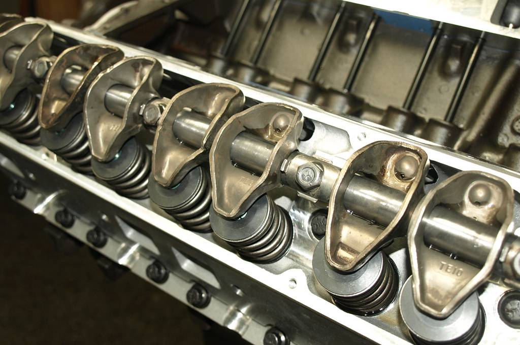

The arm only touches the shaft on one side. The valve spring and pushrod holds it up against the shaft. I found a pic on the web that shows this. Note the light shining through between the rocker arm and the shaft.
If you hold the arm and look at the "bearing" area, it should be smooth and not galled or scratched deeply. Same for the end that wears against the valve stem. You may see a groove where the stem has rubbed against the valve stem and if you do, replace them.
