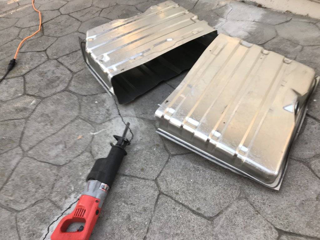

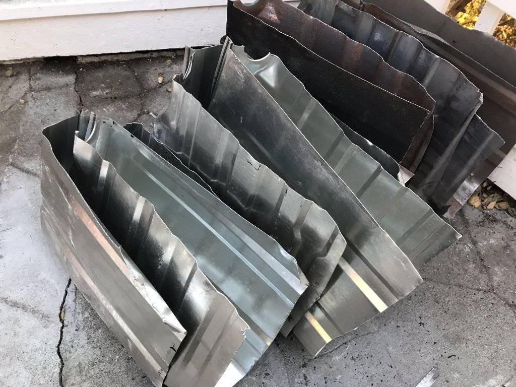

I had a leaky tank from them a few years ago. When I contacted them about it they made me send photos and would only send a replacement tank if I removed and cut up the defective tank and send them photos of that too. That was kind of a biotch. Also, the new sending units aren't accurate - rheostat winding is nothing like the mopar version.
Cutting up a gas tank with a long sawzall blade sure made a racket....
Ridiculous....

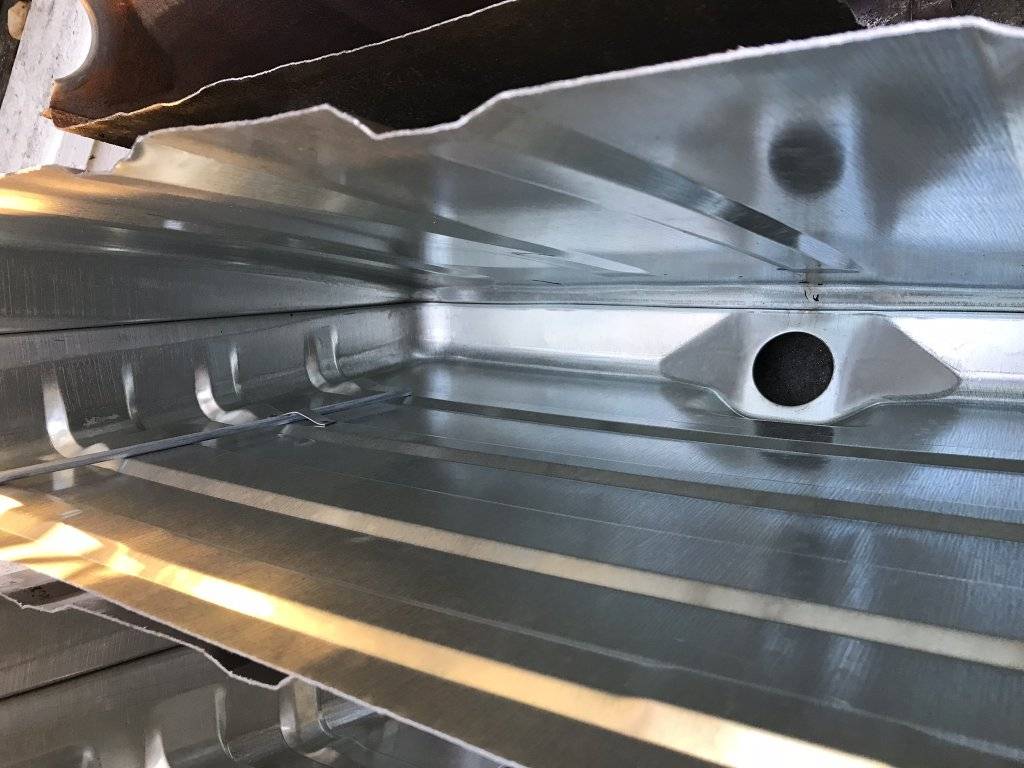

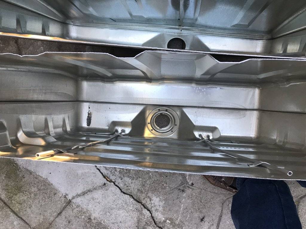

Thanks for the interesting pictures. Now we know what is really inside!

I'm fortunate that I had the means to cut the tank up. Some people would have been up the creek, or if they had to have their mechanic do this they would have been charged for that too.
More pics.... which remind me the soldered joint where the vents exited leaked too (on the tank that replaced this one). Fixed that with epoxy.

For all of the damage, how was the tank packaged?
Thanks for the extra pictures,
