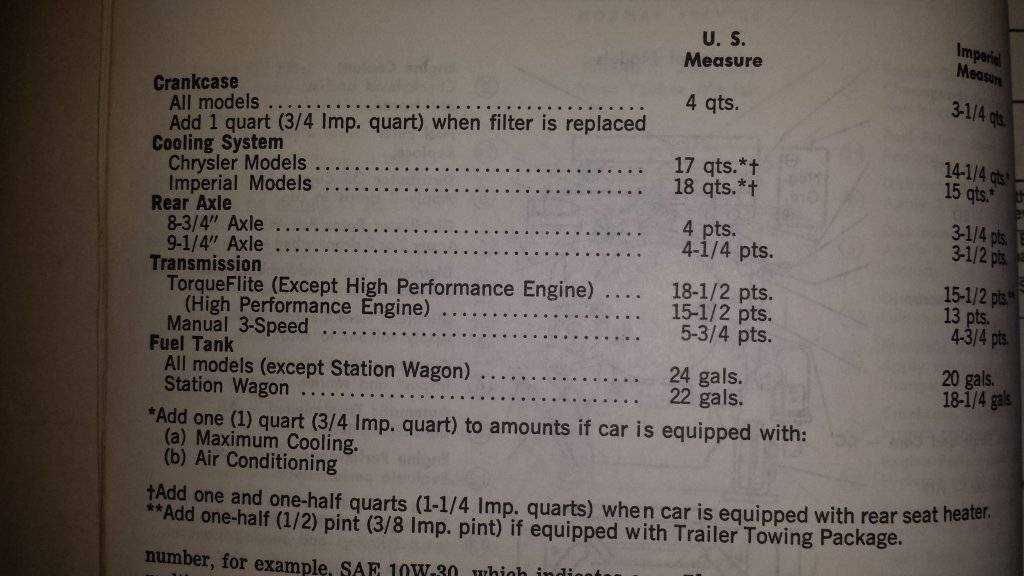

I am using FSM...PAGE 0-1..Add one qt to capacity with factory air or heavy cooling..
Sounds odd. I checked my 69 manual and it only refers to an extra quart of coolant for the max cooling or A/C cars. Can you scan it?
I see you did that while I was typing. That refers to the coolant and not oil.
I went back...I am wrong...it does say add for coolant...but my dip stick was 1 qt low on stick....so I guess I will go with what stick says....But rarefish..is correct..I am wrong...
I friend just purchased a all original 1968 New Yorker. He tells me that if you have A/C which his car has then the oil capacity is 6 quarts with the filter changed and cars without A/C have the 5 quart capacity. I told him that he is wrong and that they are all 5 quart capacity. He claims that he read the 6 quart capacity with A/C in "the service manual" Not sure what manual he is reading. He also told me that with 6 quarts in the pan, the dip stick read full. Any opinions on this???
Jon...You are right...I am wrong....After rereading...it does reference cooling .not oil capacity. ....but being a qt low on stick..has me confused...
