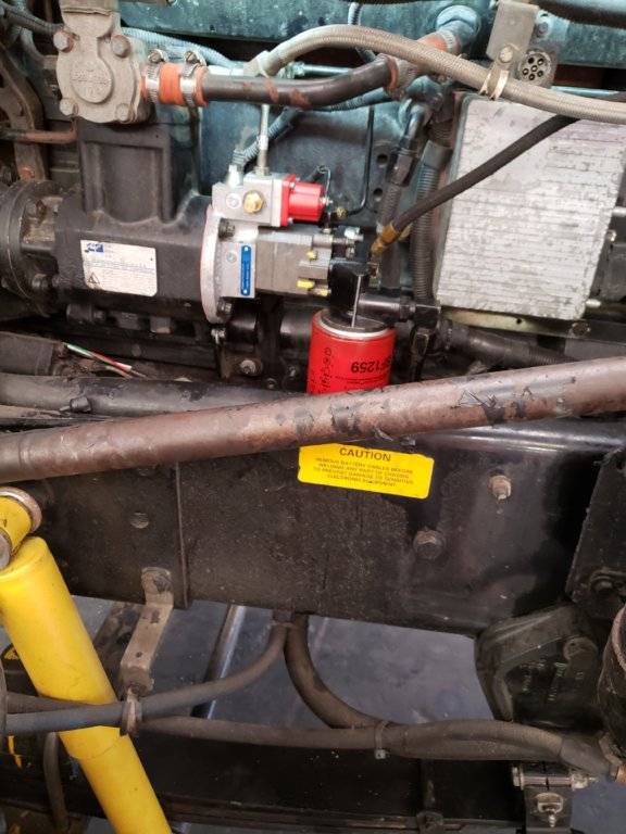

What are they getting for those pumps nowadays?Another day not working on my Fury. Had to get her towed in Tuesday. Worked Wednesday, pulled the fuel pump off Thursday, took a run to Mobile so I could go by Cummins and pick up a new pump, put it in today and gave her a bath. The driver can get back in her Monday morning and I can take the rental back. Maybe next weekend...
$900 for a Cummins recon pump, gasket, and a few O-rings to swap over the filter head. I probably could have got by with a new shaft and spider gear. The splines on both where wore slap out and letting the spider spin on the shaft. I'm not a diesel mechanic by any means so opening up the pump I wouldn't know what else should or could be replaced. With close to 2 million on it I just changed it out.What are they getting for those pumps nowadays?
I have one here I have to open up and put a new input shaft in. It was $200 for the shaft, wtf
I was just curious. The pump I'm talking about is my spare now.$900 for a Cummins recon pump, gasket, and a few O-rings to swap over the filter head. I probably could have got by with a new shaft and spider gear. The splines on both where wore slap out and letting the spider spin on the shaft. I'm not a diesel mechanic by any means so opening up the pump I wouldn't know what else should or could be replaced. With close to 2 million on it I just changed it out.
They ain't cheap, lolI'd hate see what they want for a PT pump for an NTC engine.
