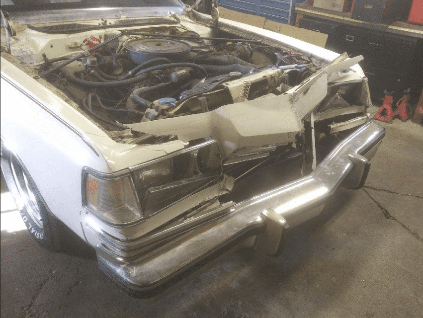

For what it's worth, the color will be EW1, Spinnaker White. Some of you may recall my Magnum took a little poke in the nose last fall. (Multi-car in I-75 construction) It's fixed beyond this point now, I have the needed parts. This is also why I'd never consider lowering a car. It's bad enough that anything you hit is going to be an SUV that your bumper will miss. Luckily the bumper finally hit something on the Jeep and stopped the carnage. My fenders will keep their original paint, hood won't be so lucky :(
