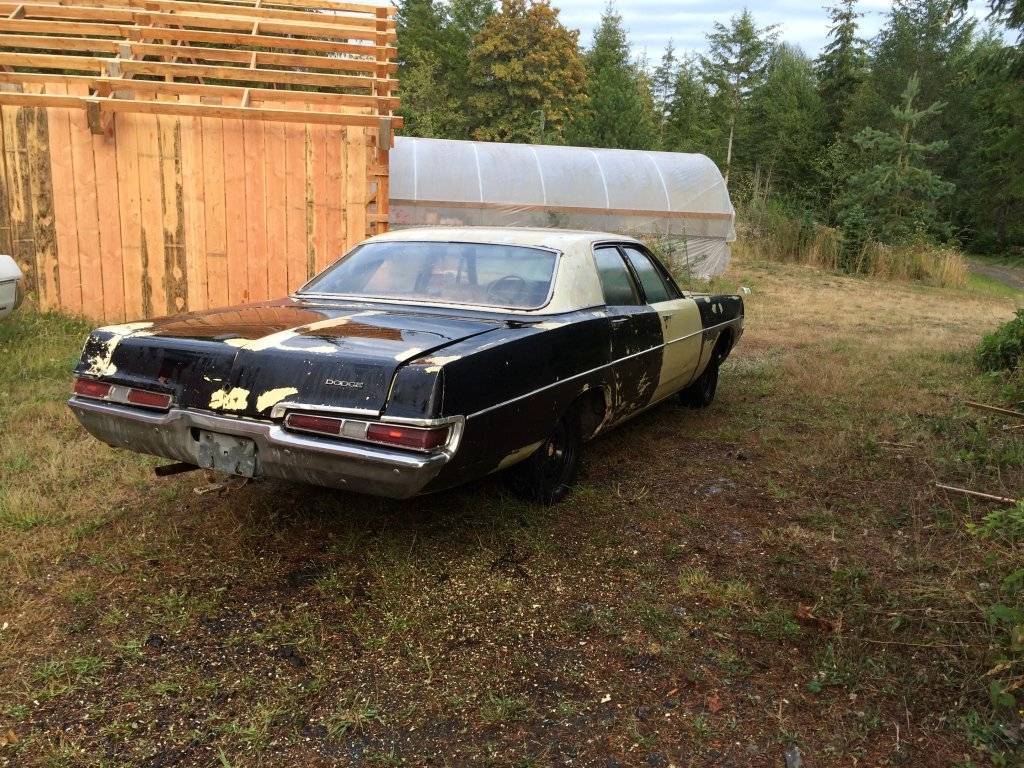

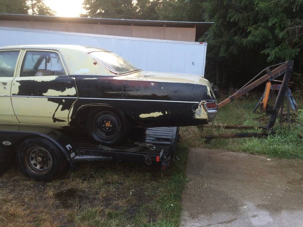

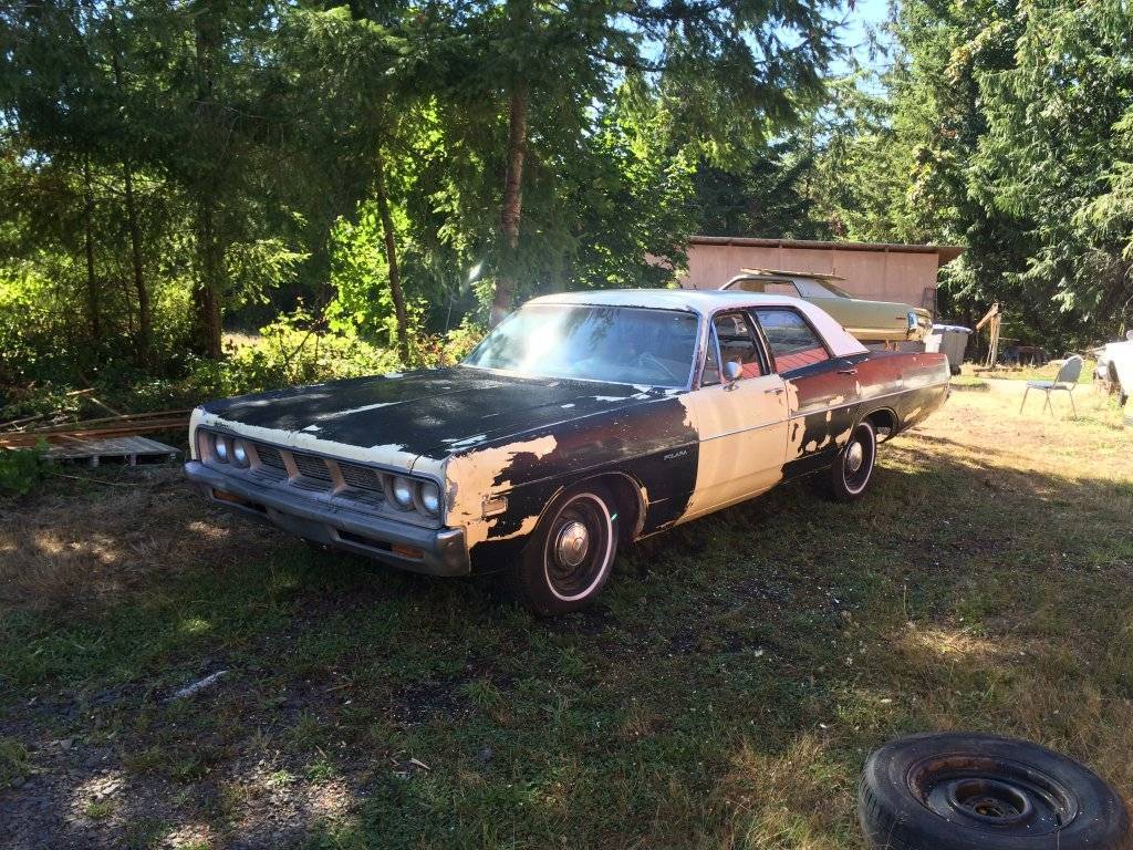

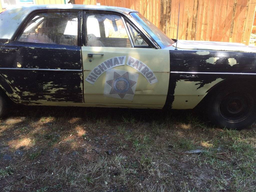

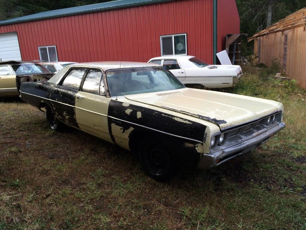

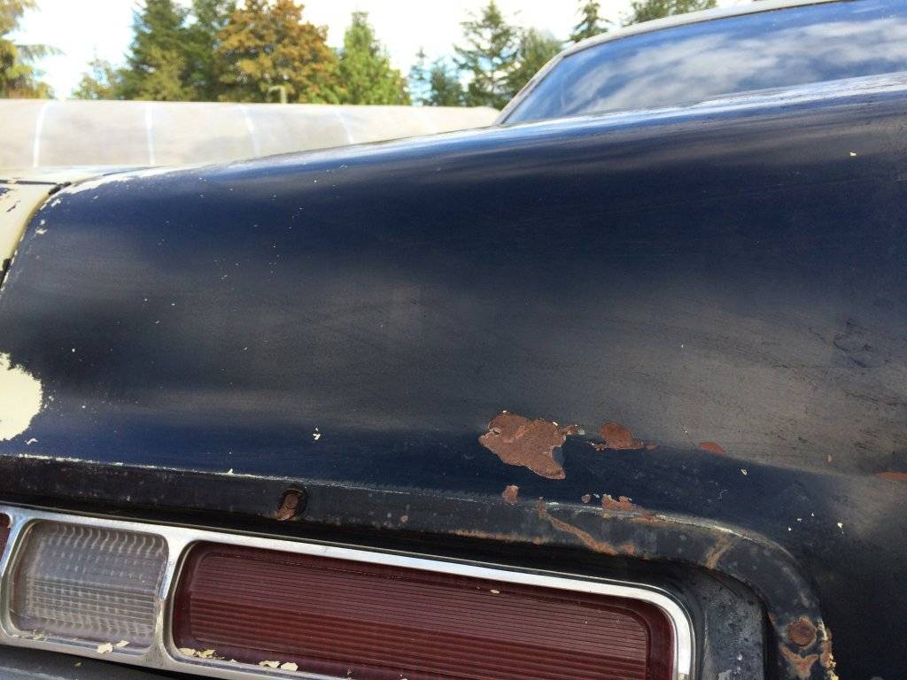

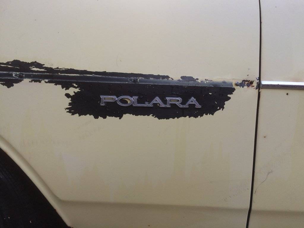

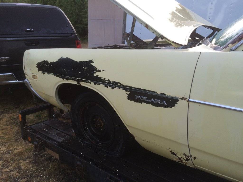

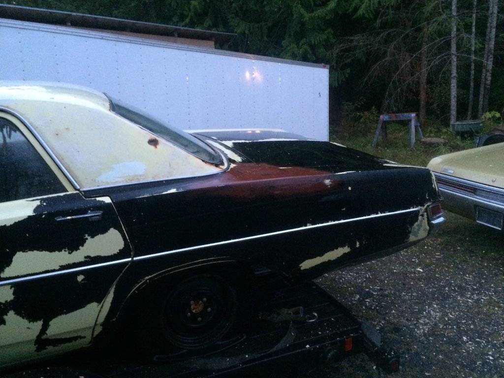

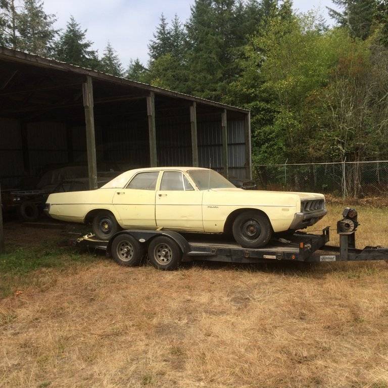

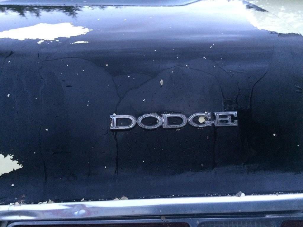

I've been trying to remove the original applied CHP "day two" yellow paint. I finally succeeded with the help of a pressure washer.....more to go....we should have a nearly original CHP paint uncovered after 45 years soon!!!!! You can see the "shadow" of the "HIGHWAY PATROL" decal on the deck lid. I'm really happy about the out come. It's hard to save original paint..... Enjoy!

Wow... that's awesome that you can get the newer paint to break loose like that...
I suppose they didn't scuff the original paint before respraying...

Thanks! It is awesome! I'm a big fan of original paint I was really stoked when the "civilian" yellow paint started coming off.
The CHP did scuff the Polara before painting it for civilian resale,...but it was a quick and dirty job....they didn't use primer thank God! It also helps that the car sat in 105 degree heat for 35 years and cooked the paint.

*** if you look closely at the Dodge emblem on the trunk lid you can see the "L" from the original "HIHGWAY PATROL" decal ***

I'm going to take it to my shop and spend about 2 weeks wet sanding it to remove all the yellow paint,...then I'll cut and buff it.
