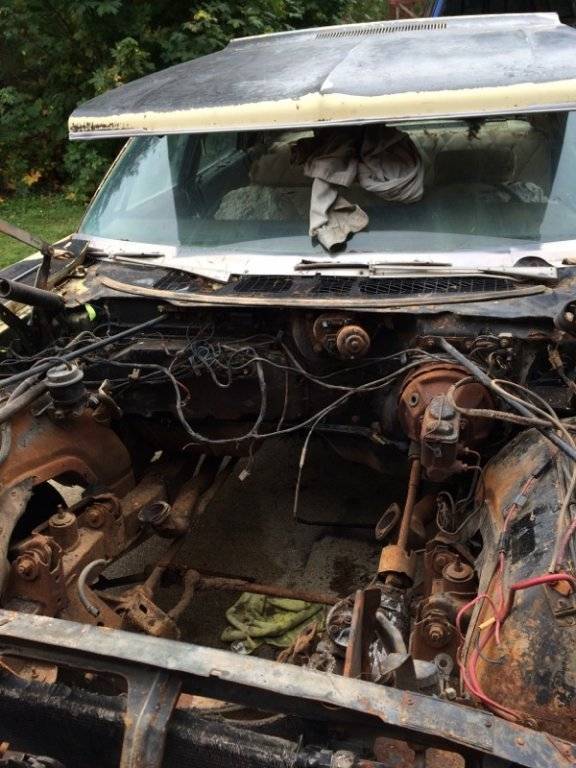

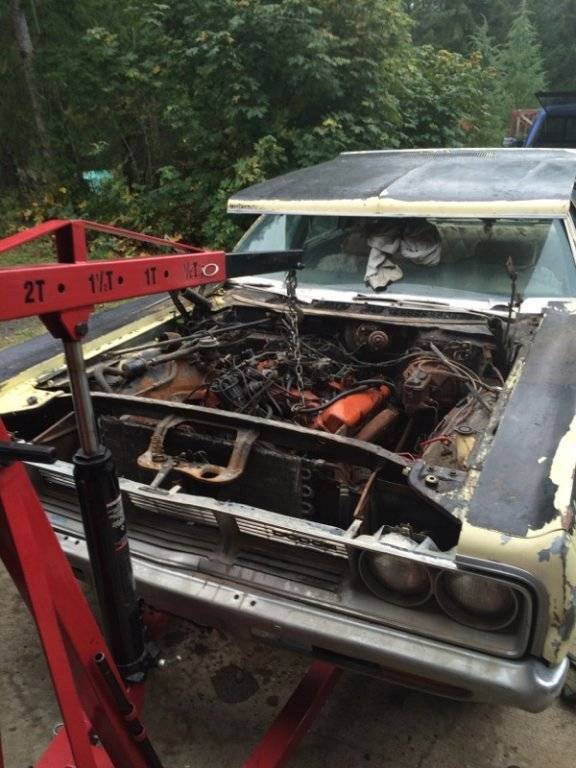

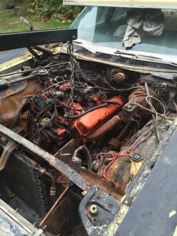

Engine swap on the 69 Polara CHP happens tomorrow.
1967 383 HP dual point engine comes out.
1969 dated casting 440 HP (six pack internals) goes in.
Good original CHP stuff is still there, exhaust manifolds, alt brackets, CHP wiring, A/C, clutch fan, original radiator, ORIGINAL front exhaust pipes ( I have 100% correct welded units for the rear) ,..etc, etc.
Thanks Dave..........out with the old and in with the new!!!
It turns out the trans is an original CHP unit, also the oil pan, and maybe the heads too. Pretty cool.

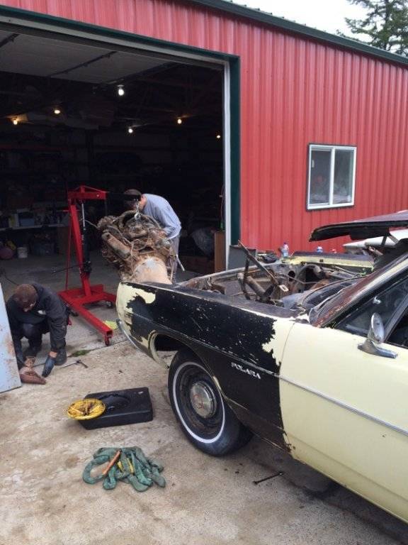

Thanks for the encouragement guys. And a special thanks to my two unnamed friends that helped with the engine/transmission swap. So much more fun to do with 3 people.

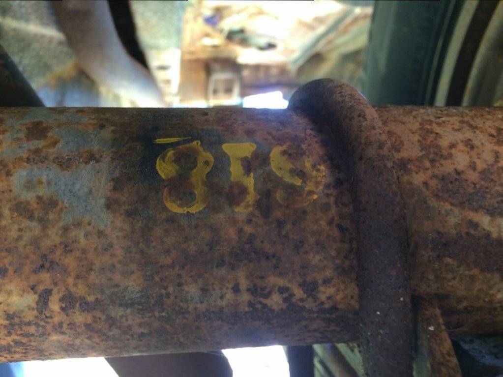

For the originality crew and the numbers nerds like me..........and you thought your Hemi 'Cuda was the only car with inspection and plant assembly special paint marks,....HA!!!!:) ( I know this isn't the only car with markings!!)
The 618 number is the axle code on the Broadcast Sheet, coded for the CHP Polara, which I believe is a unique code for this axle. (I'll check my other Pursuit Broadcast sheets I have in my archive later). The "C" on the end cover of the differential;...that's a "C" for CHP or C-body 8-3/4" 3:23.
I know this isn't a big deal for most of you guys,....but it's fun stuff for us numbers nerds, and it's part of the car,...part of the history.

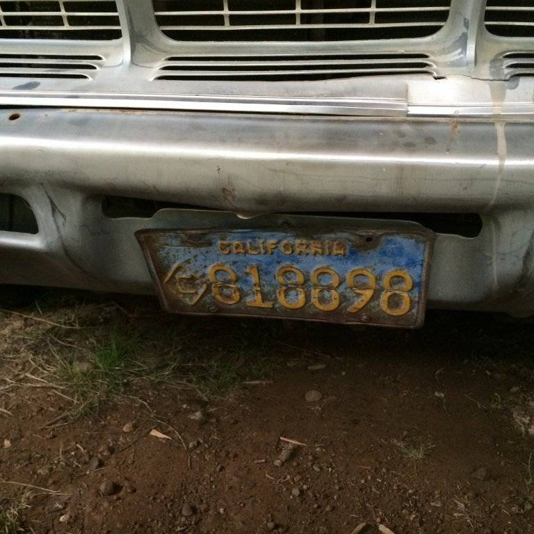

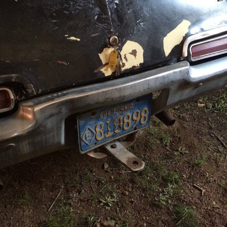

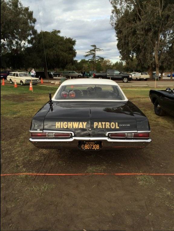

My car is a " late" car built in May, and likely put in service towards the end of 69, I'm running first issue blue state exempt plates, which were released near the end of 1969.
View attachment 97955 My car is a " late" car built in May, and likely put in service towards the end of 69, do I'm running first issue blue state exempt plates, which were released near the end of 1969.
The reality is the black plates were used into late 71 on trucks. My car also a May build was put into service on August 19, 1969 and had the plate 808434. I have a color picture of a car that is just 6 units off of mine with a black plate 808325. The earliest 1970 CHP car picture has the plate 808966, now it was a black and white photo so I can't say if it was black or blue. I'd say the CHP was using up the last of the diamond black plate into the 1970 cars.
People typically show 1970 CHP cars with blue plates whereas many if not most probably had black plates.
Alan
Alan
Thanks Alan, good to know.
I do know a pair of California "diamond" black "State" plates are really hard to find. Got any extras?
The "blues" are fine for now,.....
