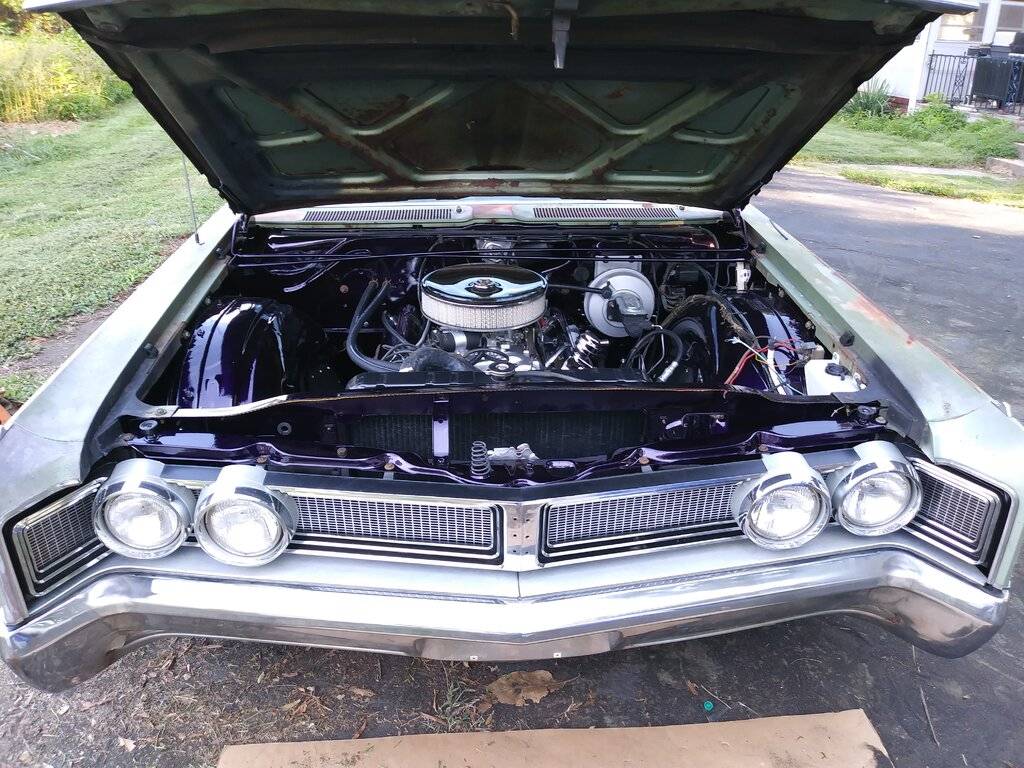

A pal with a RR had someone do a "cast iron ceramic" finish to his logs, and 3 years later it's fantastic. I like that look you have there. Hard work, good results.
Your underhood looks lovely, with the exception of the sticker on the front of the battery. That's a pet peeve of mine, particularly an ugly white Interstate with a green top. Gag! That, and zip ties and modern crimp connectors. That stuff is fine out of sight, or course, but to me a zip = laziness. Zips and crimps belong out of sight under the dash, etc. I don't spy any zips under your hood. Very tidy!
After taking that picture I did remove the sticker of the modern day battery. The fake battery topper looks cool.
I dig the fake battery topper.
I went totally Plain Jane. O Reilly with everything peeled off. Black box in the Group 27 size, new holddown hardware. Nobody sees, nobody cares.

Even with the noted items, I believe you did a pretty good job with the underhood area. Looks very good! Probably even better with a little age on it, too?
